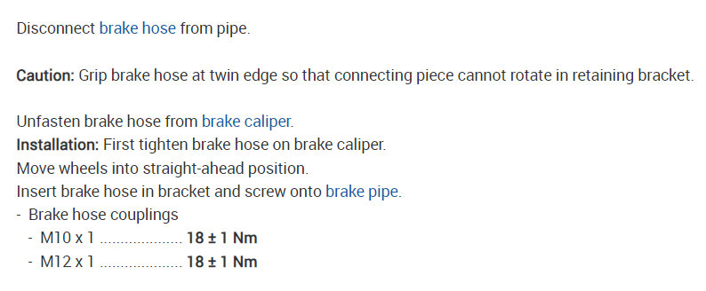

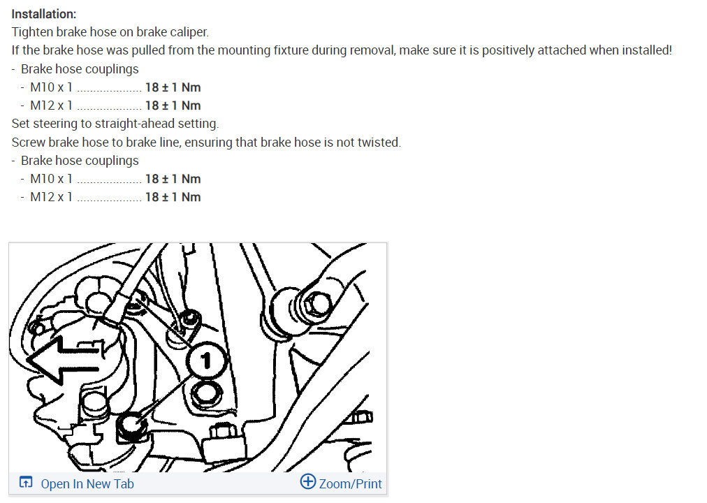

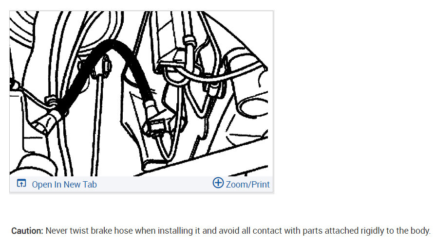

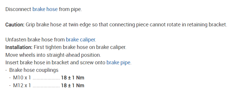

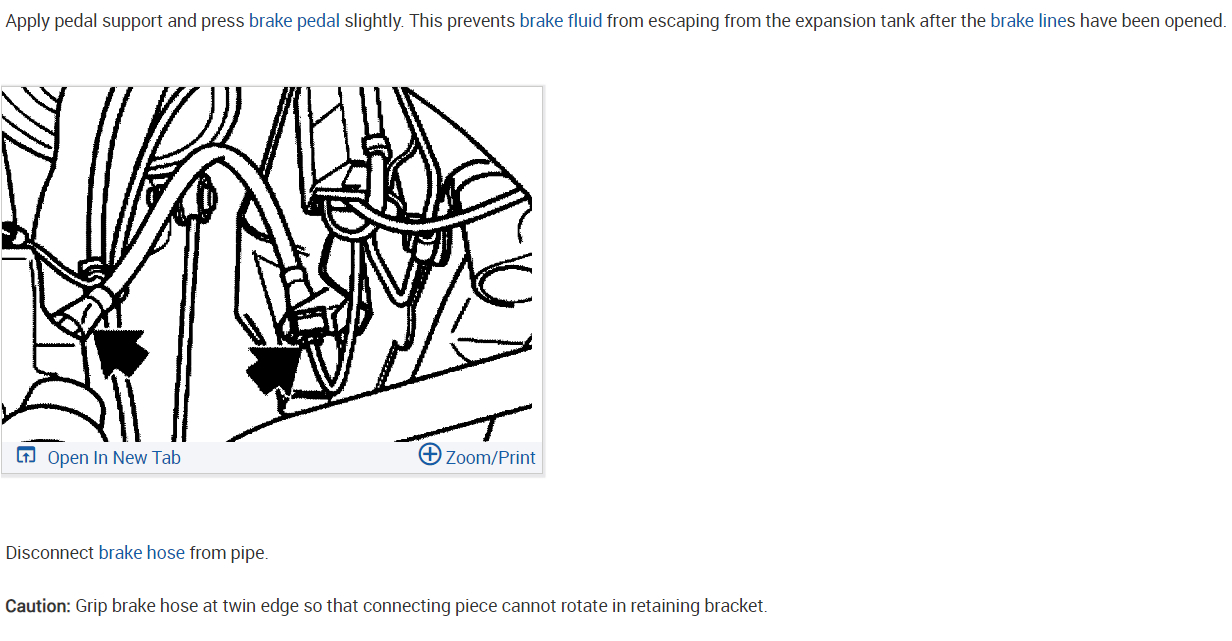

  • 55,433 POSTS
This is common when the brake flex hose needs to be replaced or the caliper slide is frozen. Here is how to swap the parts out so you can re-bleed the system.
https://www.2carpros.com/articles/how-to-bleed-or-flush-a-car-brake-system
and please go over this guide as well
https://www.2carpros.com/articles/a-comprehensive-guide-to-fixing-automotive-brakes-locking-up
