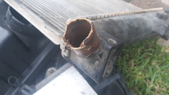

well, it looks like a have a end cap, that is either broken on my radiator or the seam is bad, on the left hand side of the radiator. It looks like it is leaking from the seam, where the plastic and aluminum meet. This explains the erratic behavior, the car was definitely overheating two days ago, when I posted my question.
I'll continue with my investigation and diagnosis. Thanks

thanks, it must've failed on my trip around town. It was over due for replacement, I think this was the original radiator. I just ordered a new one online, with new coolant hoses.

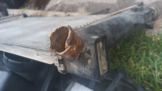

Okay Mr JACOBANDNICKOLAS, I fixed my radiator issues this Saturday, replaced both radiator hoses, and the serpentine belt. My radiator was starting to disintegrate, at the output port. It was crumbling like a fortune cookie.
Jul 6, 2021 at 2:14 AM
  • 110,251 POSTS
I'm glad to hear you got it fixed. And certainly, the radiator looks really bad. LOL You have to love plastic. Ugh!!! I miss the old days.

I really do not like plastic part usage in the engine bay, it's planned and engineered obsolescence, because it guarantees a failure. Arrrgh!
And there's no way to repair that radiator, unless you have a TIG welder, so that you can rebuild it with spare or new components.
