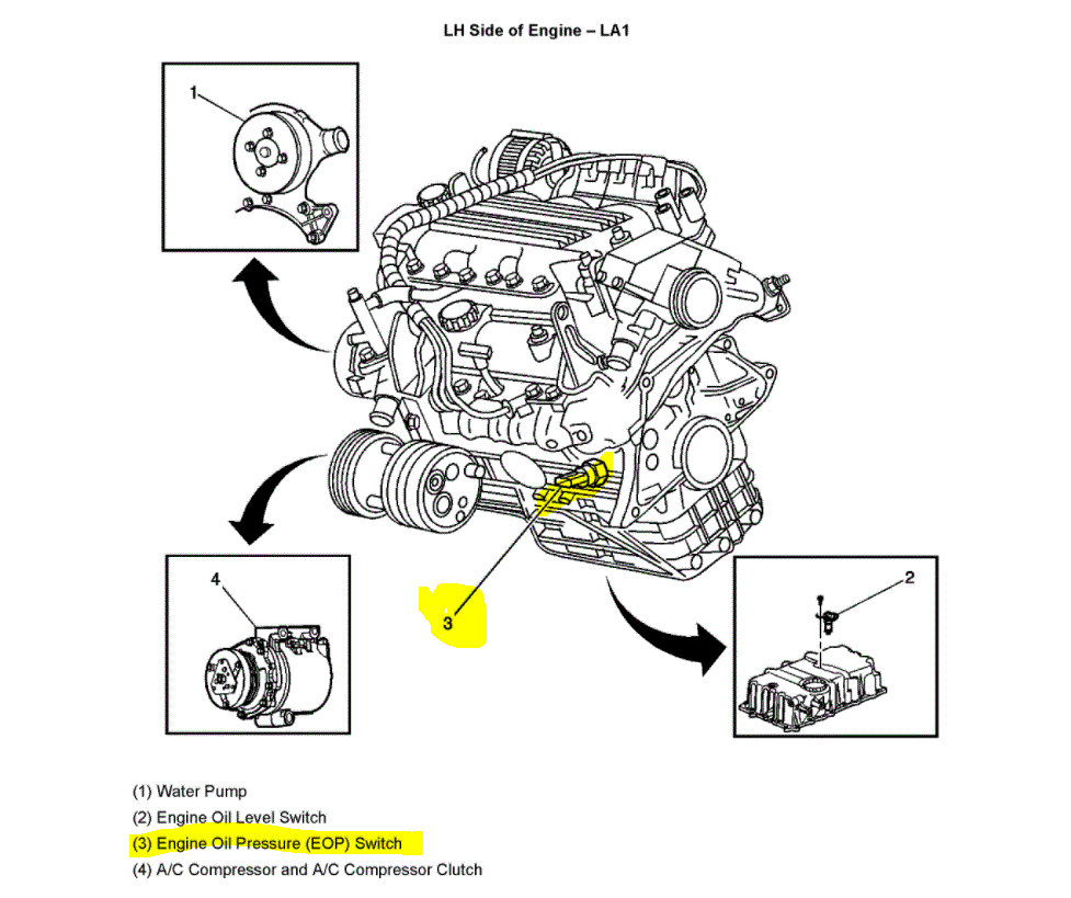

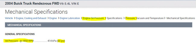

How do I test for oil pressure?

Certainly, check for codes and let me know what is found.

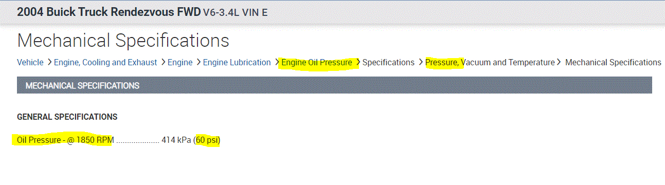

As far as the oil pressure, you will need a mechanical oil pressure gauge. Basically, all you need to do is remove the electric oil pressure sensor and screw in the mechanical.
Most people don't own a mechanical pressure gauge, but oftentimes, a parts store will lend one to you.
If you look below, I attached the specifications for the oil pressure. It's actually higher than I expected.

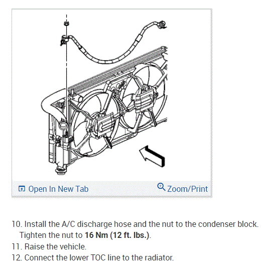

Also, I included a pic showing the location of the oil pressure sensor to help you locate it. See pic 2

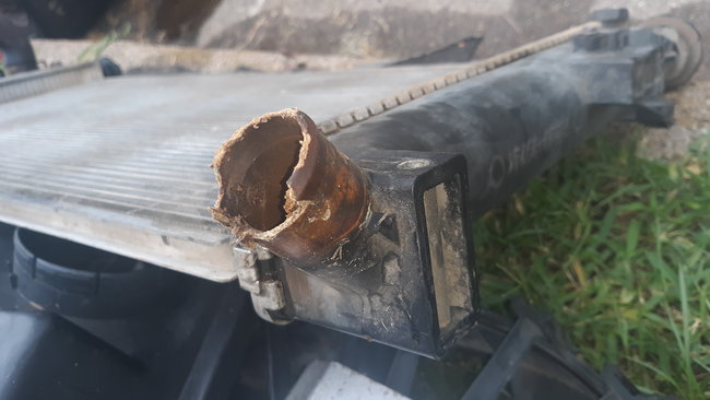

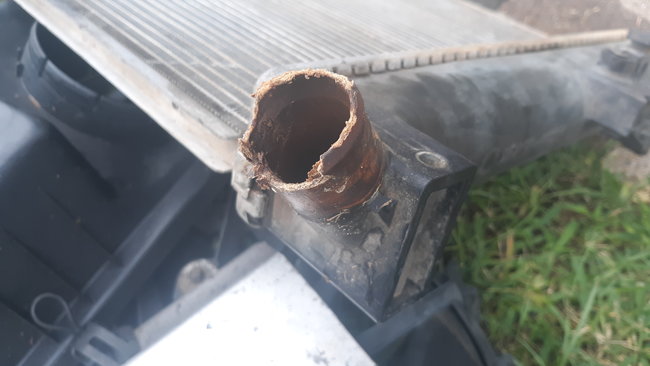

well, it looks like a have a end cap, that is either broken on my radiator or the seam is bad, on the left hand side of the radiator. It looks like it is leaking from the seam, where the plastic and aluminum meet. This explains the erratic behavior, the car was definitely overheating two days ago, when I posted my question.
I'll continue with my investigation and diagnosis. Thanks

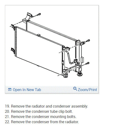

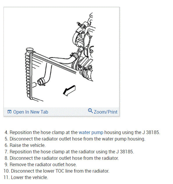

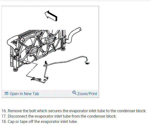

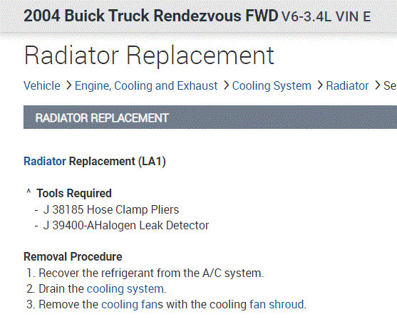

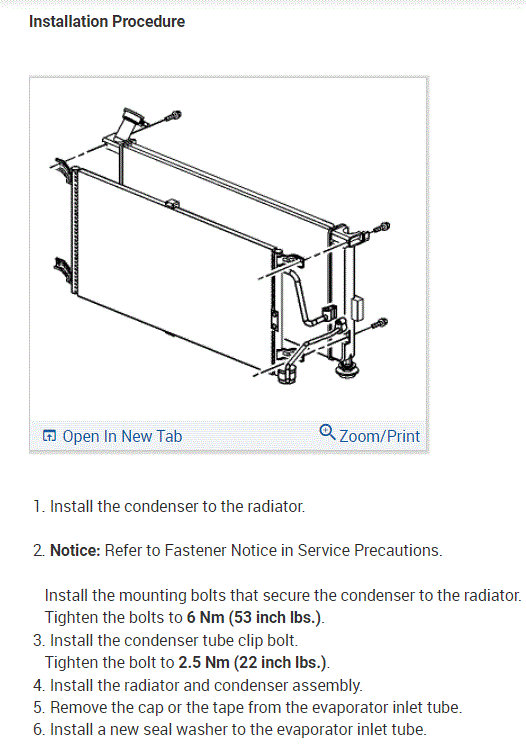

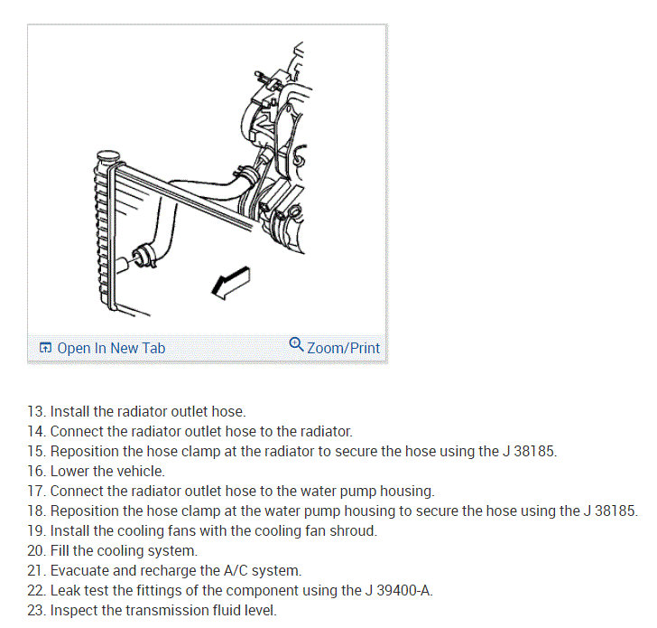

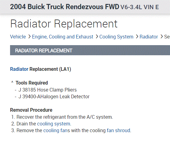

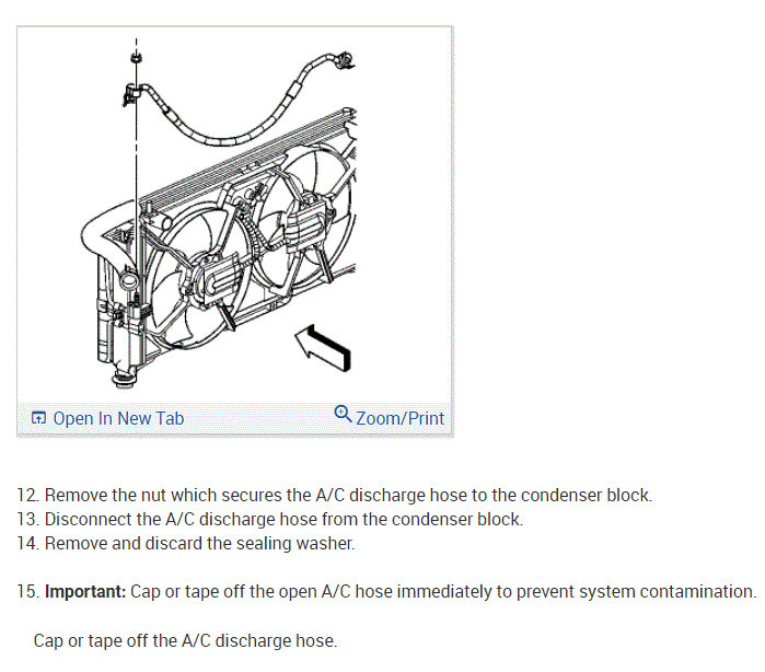

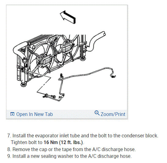

You are very welcome. If the radiator is leaking at the seam, replace it. There really isn't a good fix for that problem.
If you decide to replace it, here is a link to get you started. This will help in general.
https://www.2carpros.com/articles/how-to-replace-a-car-radiator

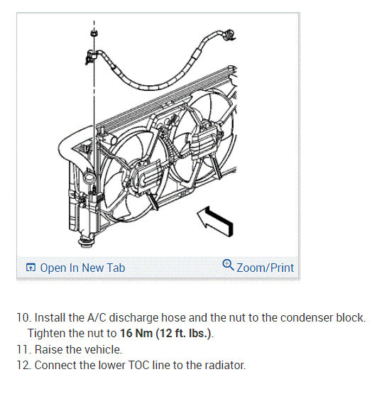

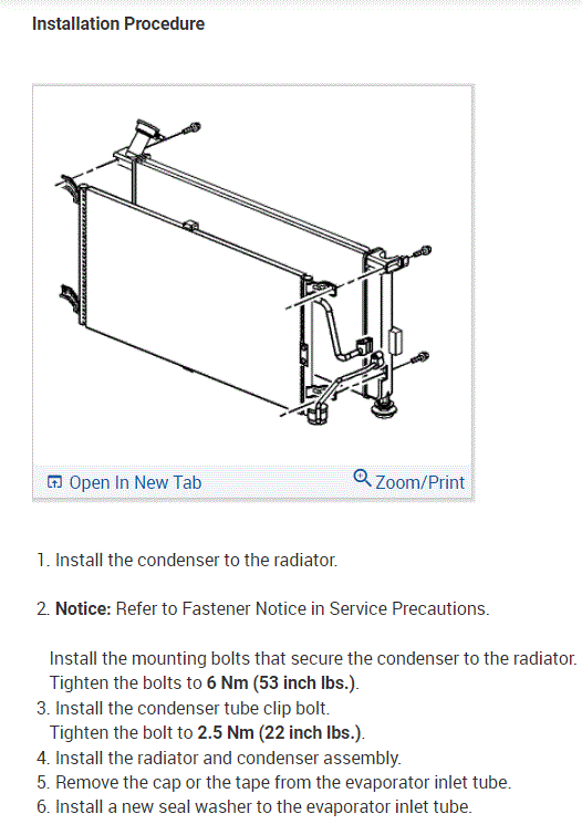

If you look at the directions below, they are specific to your vehicle for removal and replacement.

thanks, it must've failed on my trip around town. It was over due for replacement, I think this was the original radiator. I just ordered a new one online, with new coolant hoses.

Okay Mr JACOBANDNICKOLAS, I fixed my radiator issues this Saturday, replaced both radiator hoses, and the serpentine belt. My radiator was starting to disintegrate, at the output port. It was crumbling like a fortune cookie.

I'm glad to hear you got it fixed. And certainly, the radiator looks really bad. LOL You have to love plastic. Ugh!!! I miss the old days.

I really do not like plastic part usage in the engine bay, it's planned and engineered obsolescence, because it guarantees a failure. Arrrgh!
And there's no way to repair that radiator, unless you have a TIG welder, so that you can rebuild it with spare or new components.
