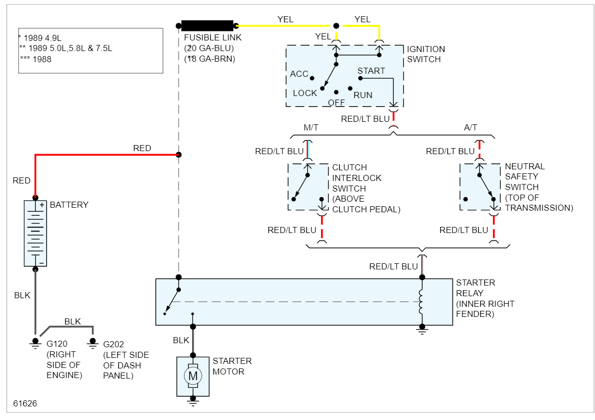

I have seen the ignition timing be over advanced and cause this problem, can you upload a short video of the engine cranking hoy so I can see the problem? Also, you may have a defective starter motor? How do the battery cables look, and do you have a good ground from the battery to the engine block and the chassis? Here are the starter wiring diagrams so you can see how the system works, also I would try swapping out the starter relay. Check out the images below. Please let us know what happens.
