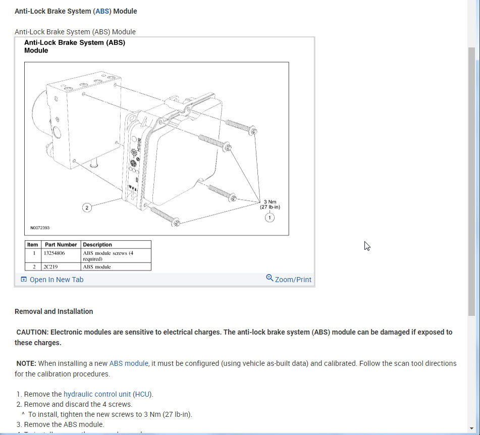

So I purchased this vehicle a few days ago. I noticed the ABS light and have narrowed it down to the ABS module how to replace

Here is a guide that will help with this:
https://www.2carpros.com/articles/how-to-replace-a-abs-controller
Plus here is the information from the manual that will help with replacing. Please see below and let us now if there are more questions. Thanks
