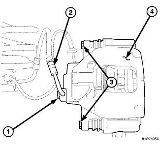

Had a sticky caliper on passenger side front (or so I thought) pulling to the right when braking, excessive heat emanating from wheel, shuddering steering when when braking. So I need to replace the front brake pads and service the caliper slides.

FRONT PADS
Raise and support vehicle.
Remove wheel and tire assembly.
Drain small amount of fluid from master cylinder brake reservoir with clean suction gun.
Remove the 2 caliper mounting bolts (3).
Compress the caliper (4) and remove from the adaptor.
Secure caliper (4) to nearby suspension part with wire. Do not allow brake hose to support caliper weight.

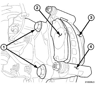

Remove the inboard (2) and outboard brake pads (3) from the caliper adapter (4).
Remove the anti-rattle clips from the brake caliper adapter (4).

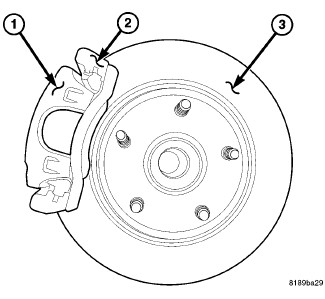

Install
Remove and clean all rust and debris from the anti-rattle clip mounting surfaces (3) on the brake caliper adapter (2).
Install new anti-rattle clips into the caliper adapter (4).
Install the inboard (2) and outboard brake pads (3) onto the caliper adapter (4).
Install caliper (4) on the caliper adapter.
Install the caliper slide pin bolts (3) and tighten to 44 N·m (32 ft. lbs.).
