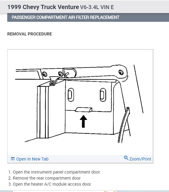

Hot/cold air works in back but in front of works but doesn't blow like it should. It just barely blows air.
Nov 12, 2022 at 8:45 AM
  • 110,240 POSTS

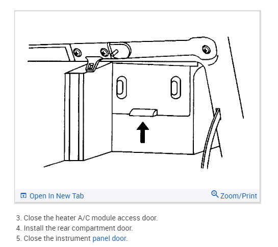

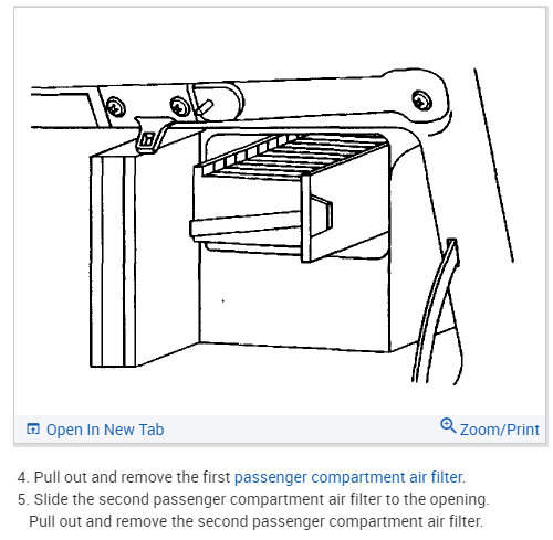

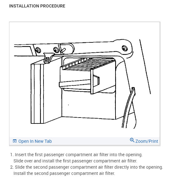

If the fan is operating properly, have you checked the cabin air filter to make sure it isn't clogged?
The cabin air filter is located behind the glove box. If you haven't checked or replaced it, do this first and let me know what you find.
I attached the directions below.

They do look like they need to be replaced. I took them out and it still didn't blow correctly. I'll get new filters....

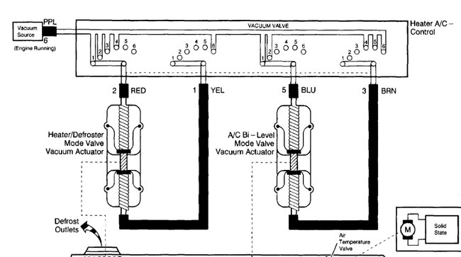

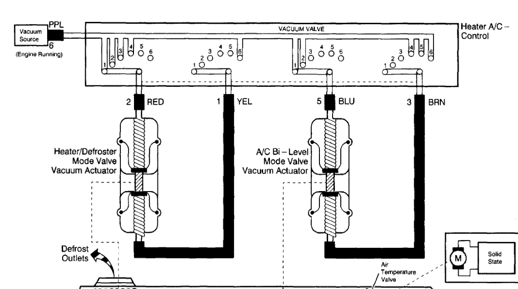

The next thing I suspect is the mode door actuator is likely not getting the airflow actuators fully in position. Are you able to change airflow directions normally?
I ask because the actuators are engine vacuum actuated rather than electric. If the vacuum supply is weak or nonexistent, the doors will not move correctly.
If you look behind the controller, you will see a purple vacuum hose. Make sure it is fully connected and not leaking. That is the supply hose from the engine. If it appears good, remove it and start the engine. Place your finger over the end to confirm there is a good vacuum supply.
I attached the vacuum schematic below. Try this and let me know what you find. Also, with the engine running, see if you notice any hissing which could indicate a leak and note anything that appears disconnected.

The pic above is of the controller in the vehicle. If you notice on the left side, it says the source. That goes to the engine intake manifold which is the source of the engine vacuum.
If you can locate the purple hose, disconnect it, and start the engine. Place your fingertip over the end of the hose to see if there is a strong vacuum being supplied.
