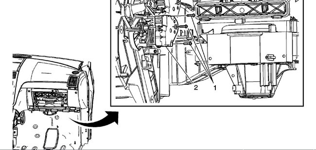

So I turn the air on and all blowers work in the front section and back sections (third row seating). The problem is front driver is cold air but passenger and back seats get hot air. I was able to remove the door actuator out on the passenger side and manually turn it but i still felt hot air. I probably will still replace it but haven't yet to see if that was the problem. What worries me that I read that manually doing it I should have felt a difference but did not. I live in Florida and summer is coming fast. Help!

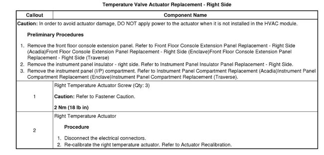

Yes, it could be the blend door actuator, not the mode door actuator.
They are different.
I have attached the location and the procedure for the passenger side actuator for temperature control. Remove that and see if you can manually turn the door and get cold air.
Apr 28, 2020 at 3:43 AM

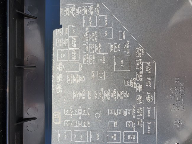

I did not. I'm new to this. I've added a pic of my panel. Which one would I pull?
May 1, 2020 at 10:46 AM
The one marked HVAC. remove it for 2 minutes.
May 1, 2020 at 10:58 AM
SHAWN SHARP
Yea, I even undid the battery and still hot hair.
