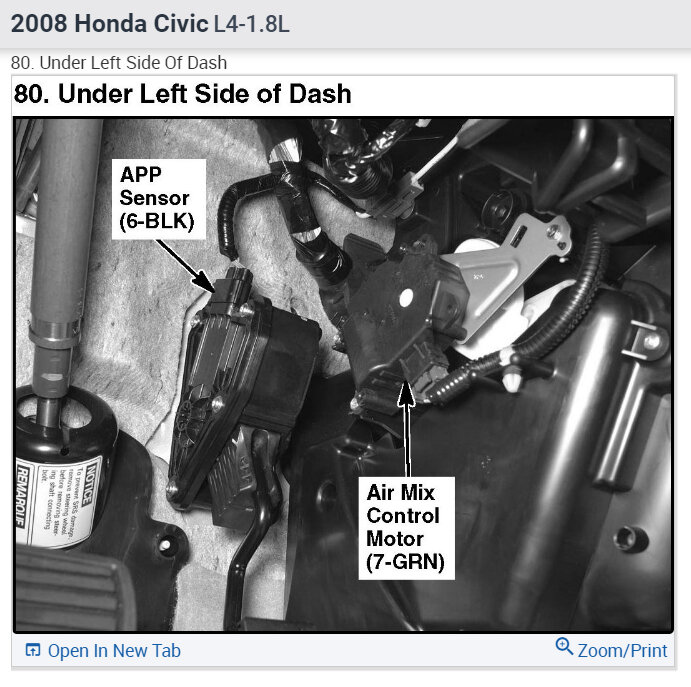

The Compressor is kicking on and does not need Freon. Ready to blow up car!!! Any help appreciated.
Aug 25, 2023 at 7:42 AM
  • 55,770 POSTS

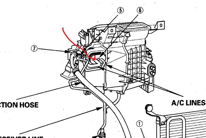

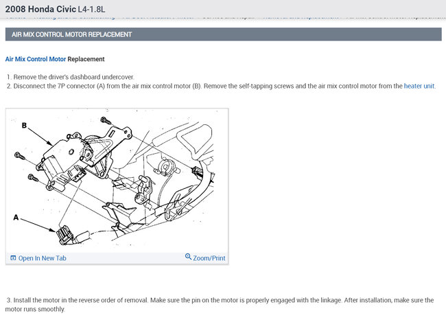

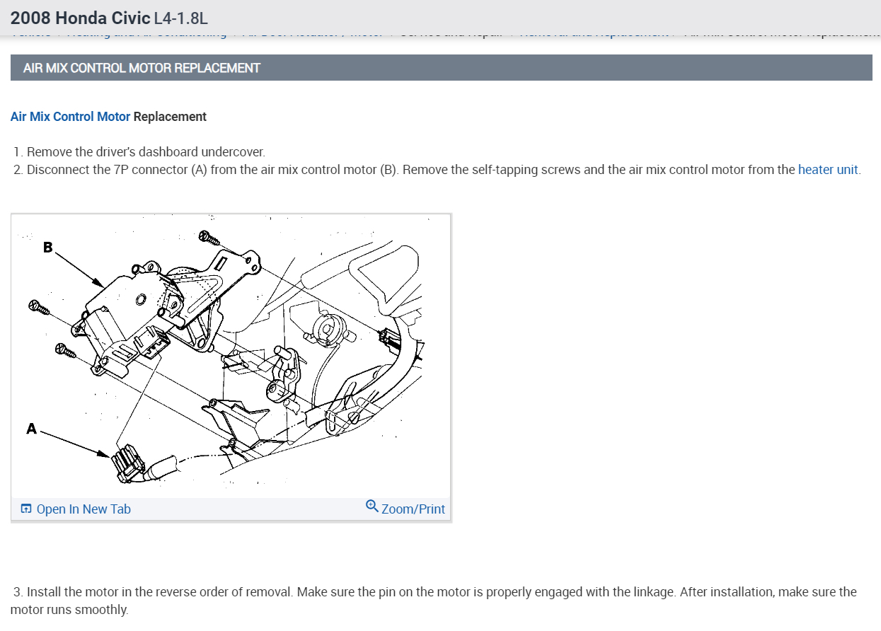

I would turn the system on and then confirm the larger A/C line-tube coming from the fire wall is cold, if so, the air mix door actuator needs to be replaced. Here is a guide to go over and the location of the actuator in the images below:
Check out the images (below). Please let us know what happens. Follow the red arrow to show you the place to grasp for the temperature check.
Aug 26, 2023 at 5:42 AM
