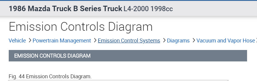

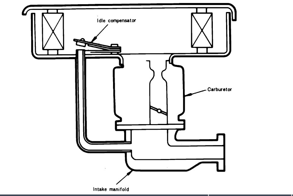

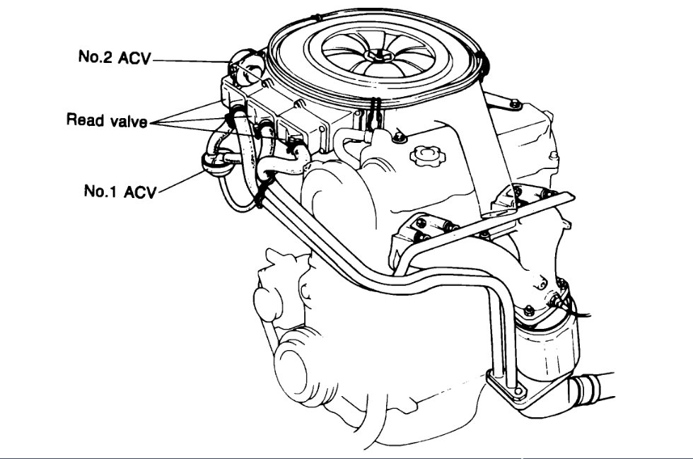

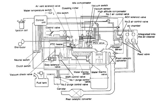

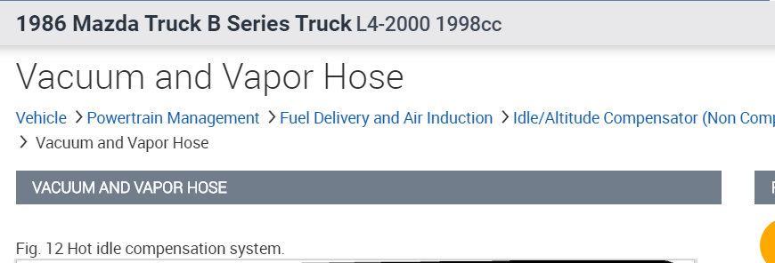

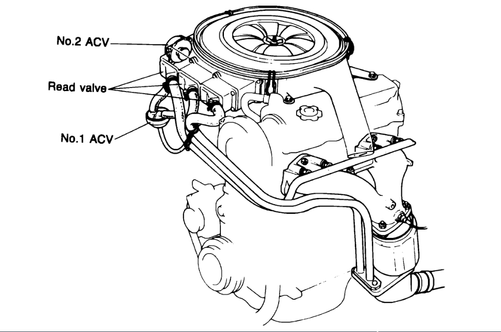

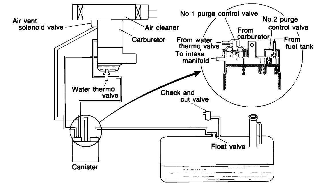

the vacuum hoses going from motor to carburetor caught on fire and burned. i need to replace the hoses. i think they are vacuum hoses from the exhaust. i cant find them. what can i do?
Sep 19, 2019 at 7:04 AM
SCGRANTURISMO
  • 4,897 POSTS

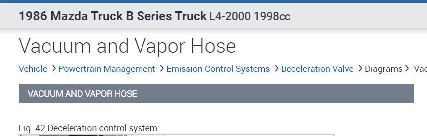

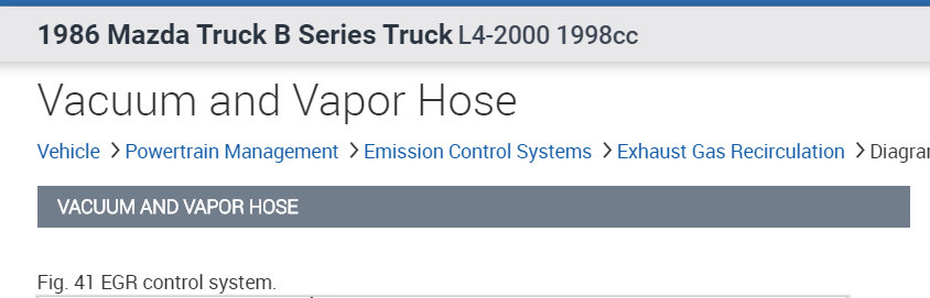

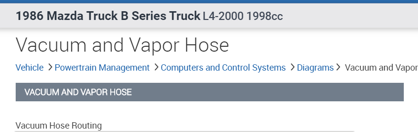

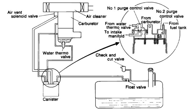

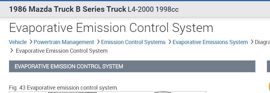

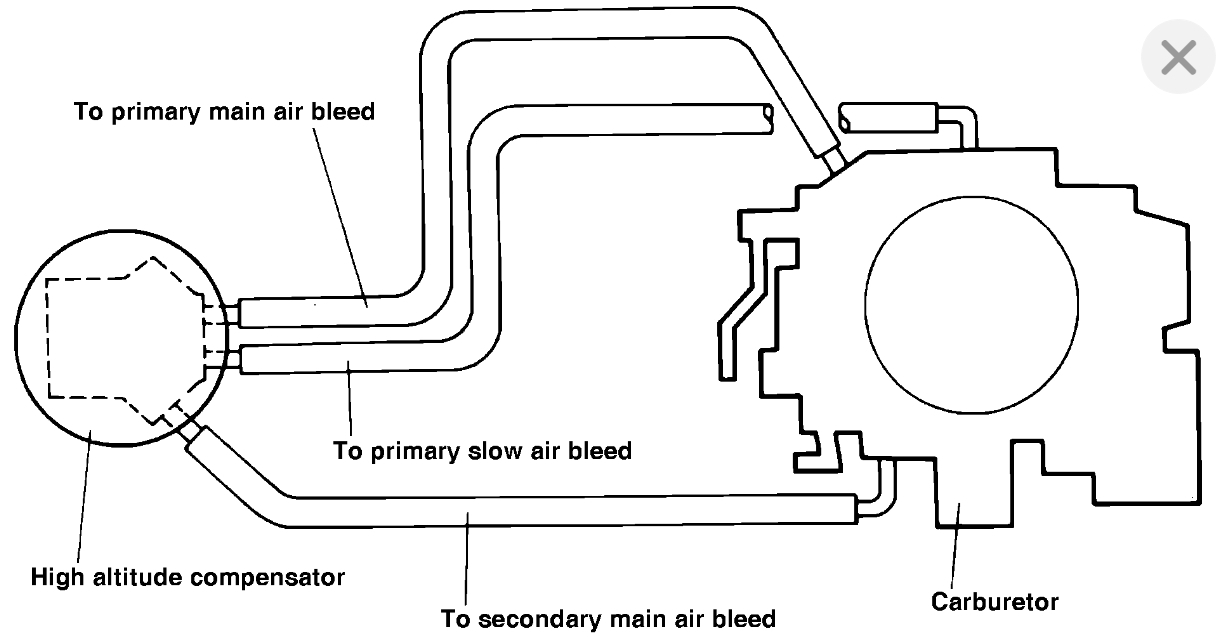

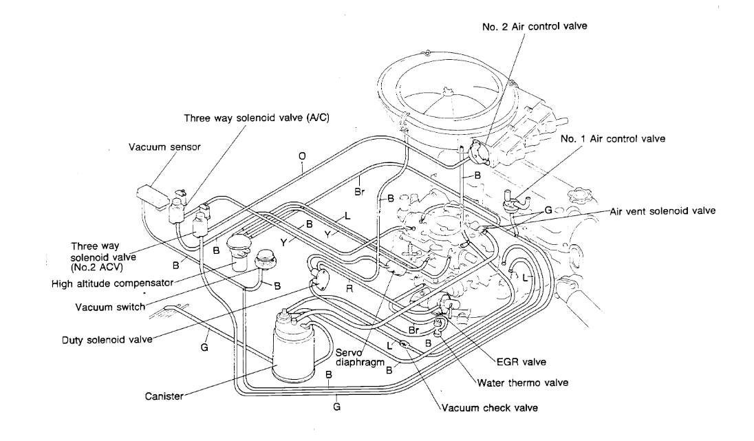

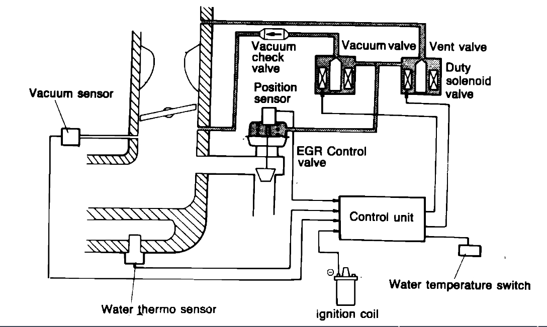

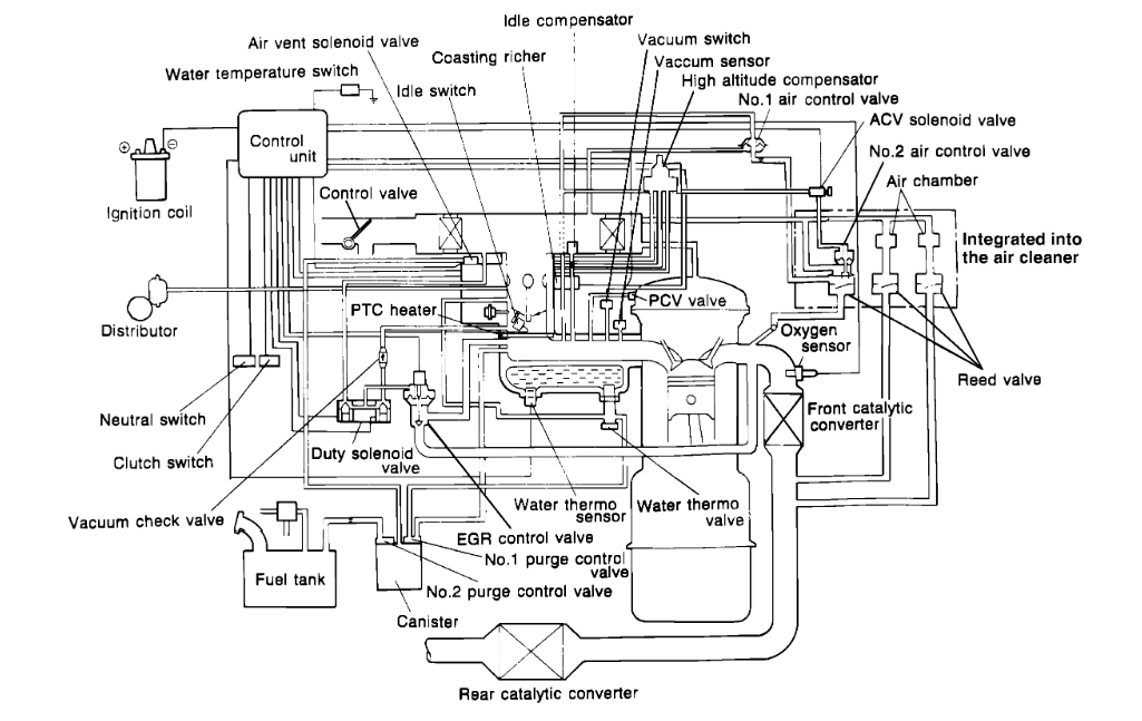

In the diagrams down below I have included a full set of the vehicle manufacturer repair guides Vacuum and Vapor Hose diagrams for your vehicle. If you can't find what you are looking for in this set, they don't exist. Please go through them and get back to us with how everything turns out.
Thanks,
Alex
2CarPros
Sep 19, 2019 at 10:19 AM
WILLYJHOPUKY
  • 9 POSTS
thank you the top left one shows them.
