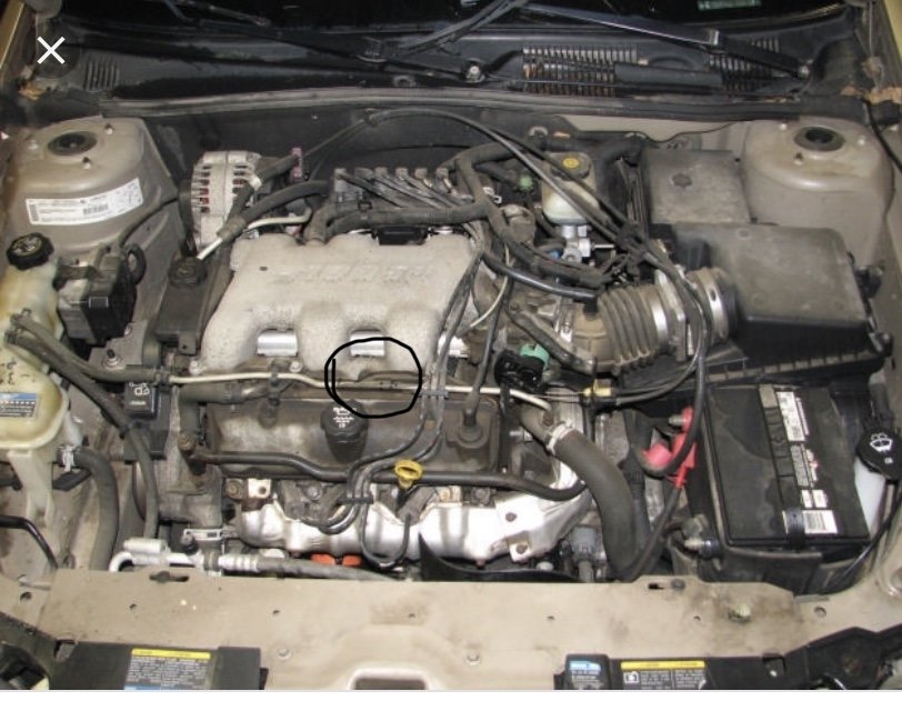

I have been trying to replace this hose that I circled in the picture. have not been able to get the right part.

It’s not uploading will try again in the morning. it’s a metal hose that connects to the rubber hose on the antifreeze reservoir.

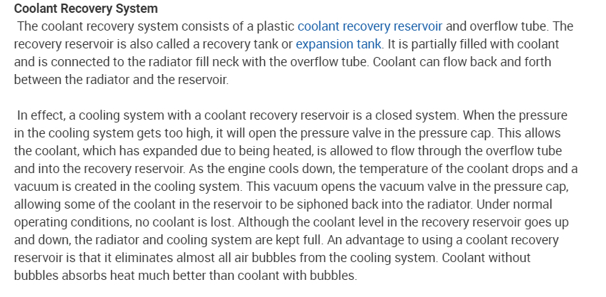

Hello again,
That part looks like the coolant recovery overflow tube. I have included a description of the part and what it does in the diagrams down below for you.
