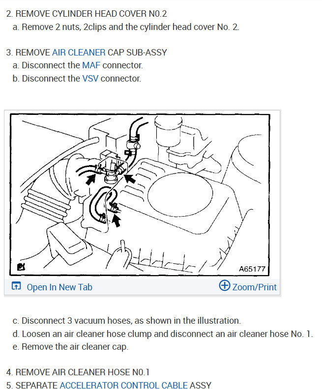

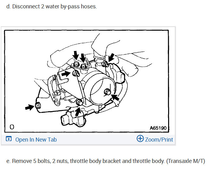

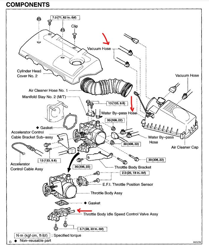

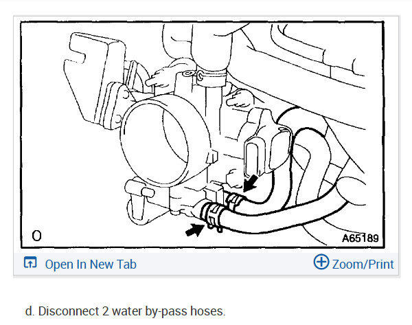

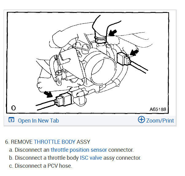

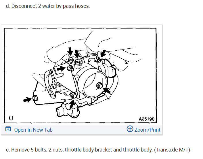

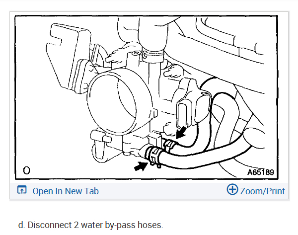

First time removing throttle body and exhaust manifold plastic cover for cleaning. I am unable to find 2-3 hoses correct location to reassemble. The short coolant hose coming from location, I believe connects to throttle body port where I found rust on nipple. There's another port/nipple next to rusted (coolant intake port on throttle body, and then there's a port on the exhaust manifold plastic housing/cover that a hose connects to. The hose I believe that is the heater hose- the hose That runs up to the firewall (behind brake reservoir) goes to the second throttle body port or to the exhaust manifold housing port? Thanks- Candi Story (diyer :)
Nov 3, 2024 at 1:35 AM
  • 55,433 POSTS
Can you please upload images of what you are seeing? I think you are talking about the coolant bypass hoses that go to the throttle body, correct? Here are some diagrams that can help show you the coolant and vacuum hoses to the throttle body. Check out the images (below). Please upload pictures or videos in your response of any problems so we can see what to help you with.
