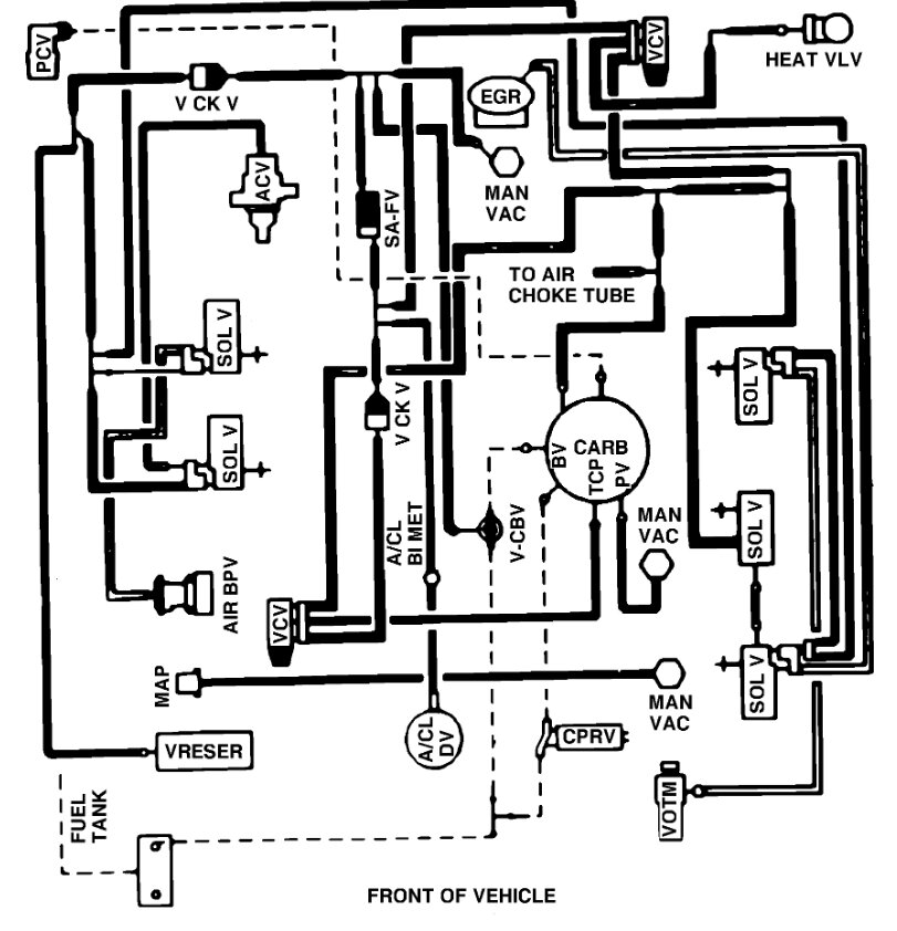

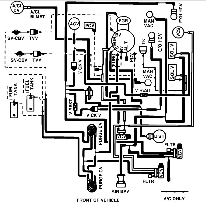

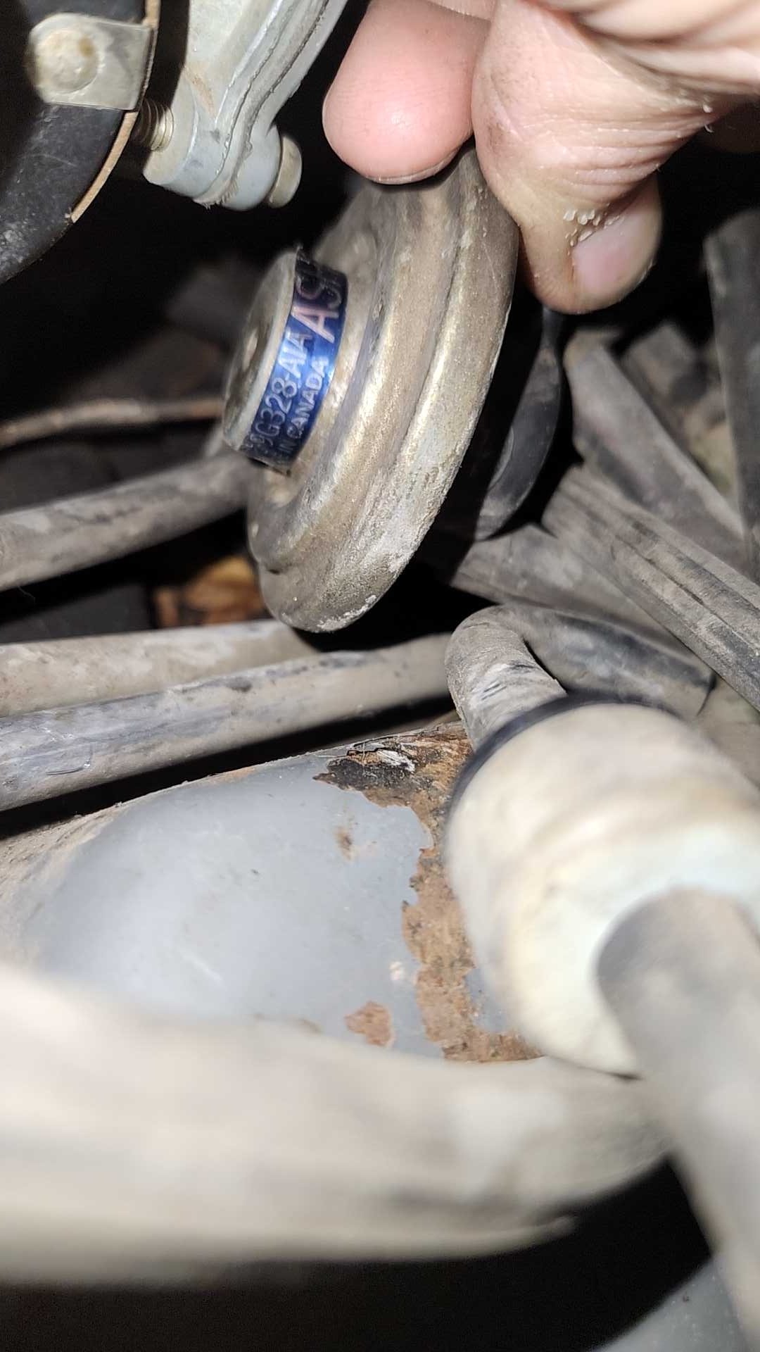

I want to know is there a hose that's connected from the carburetor to the thermactor idle vacuum valve part #9328. if so, will someone send me a diagram it's on a 1985 Econoline e150 van 5.8l Windsor.

To determine which vacuum schematic I need to review, I need to know if it has a 2bbl or 4bbl carb. Also, I need to know if you are in CA.

Here are the vacuum line diagrams for both the 2- and 4-barrel carburetors. Check out the images (below). Please let us know what happens.
