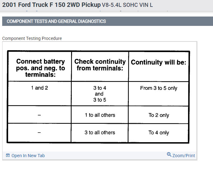

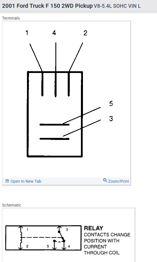

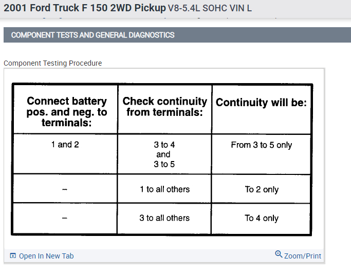

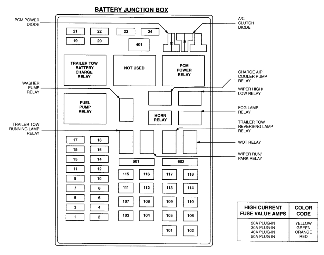

Have you checked the horn relay?
It could be a faulty relay that causing to have no horn.
The relay is located under the hood fuse block. I have attached the diagram for your reference.
Here is a helpful article on how to test relays:

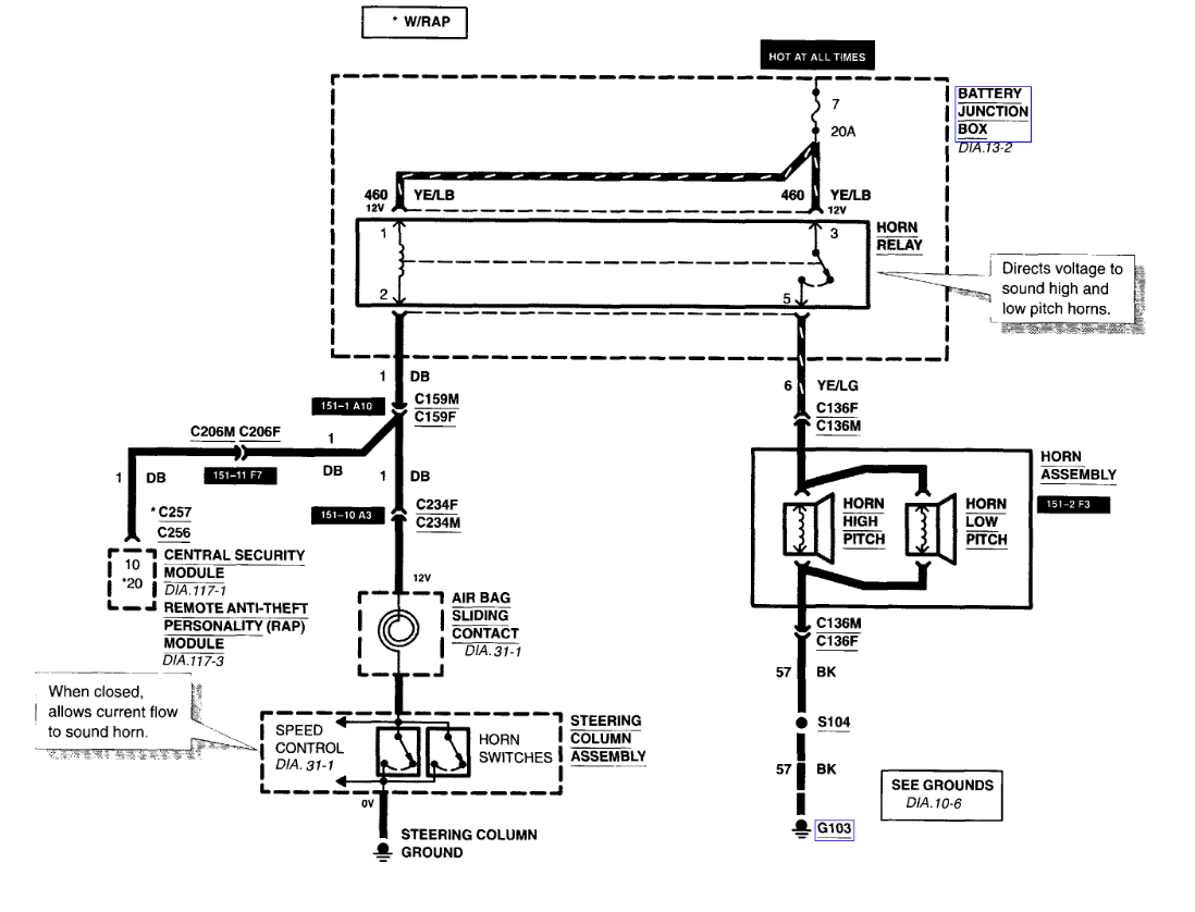

It could also be a short somewhere in the horn wiring harness. I included the wiring diagram for the horn as well.
