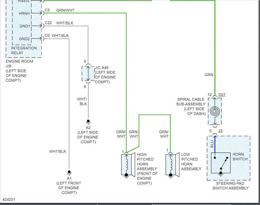

need horn wiring diagram. Can't find anything online.

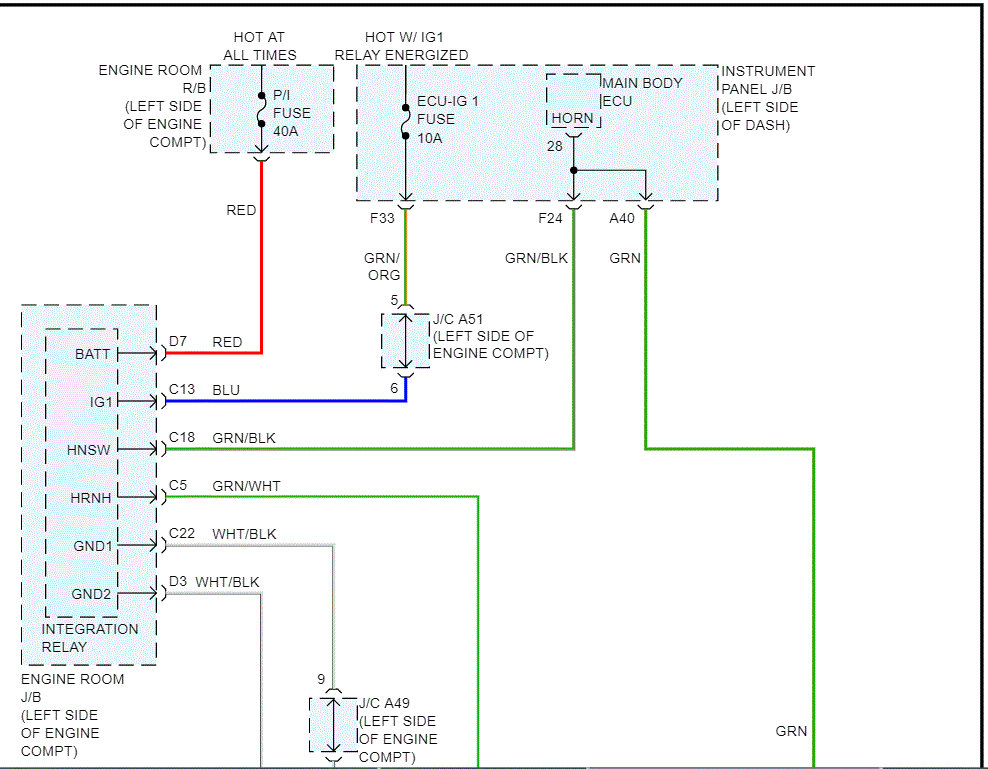

I attached the schematic for the horn circuit. I cut the pic in half to make it readable for you, but I did overlap so you can follow it easier.
Let me know if this is what you needed or if you have other questions.

thanks a lot.
