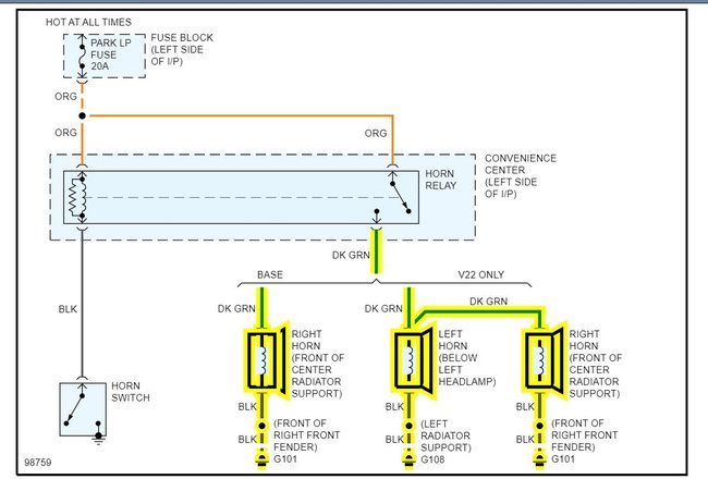

Need to know which wires are for my horn.

They are dark green wires at the front of the truck by the grille. There should be a harness with those wires coming out of it.
I attached the diagram for you.
