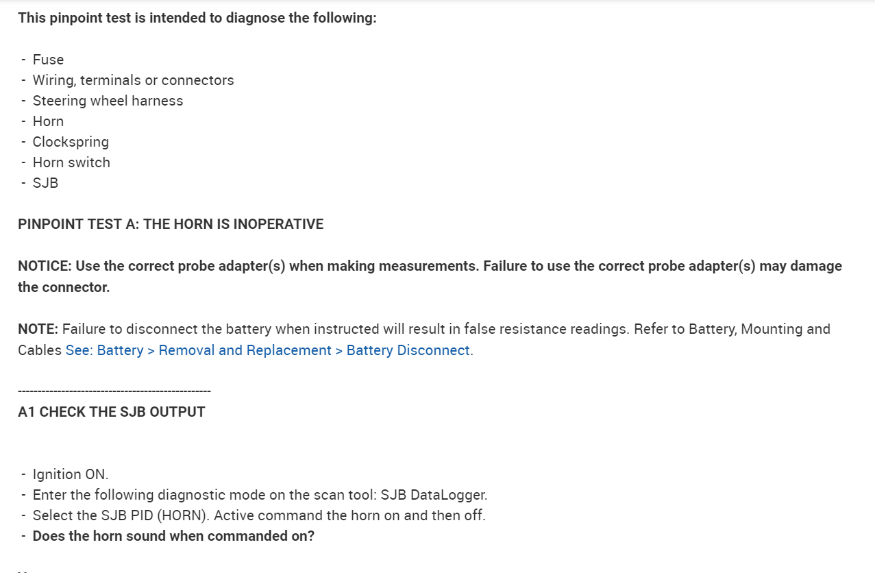

Horn will not work from wheel
2011 FORD EXPEDITION
146,000 MILES
F1SH0N

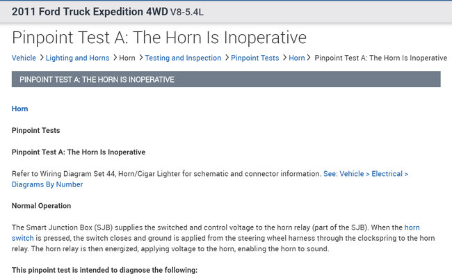

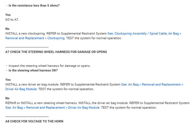

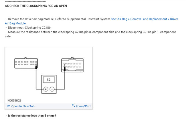

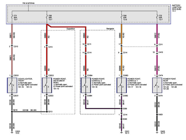

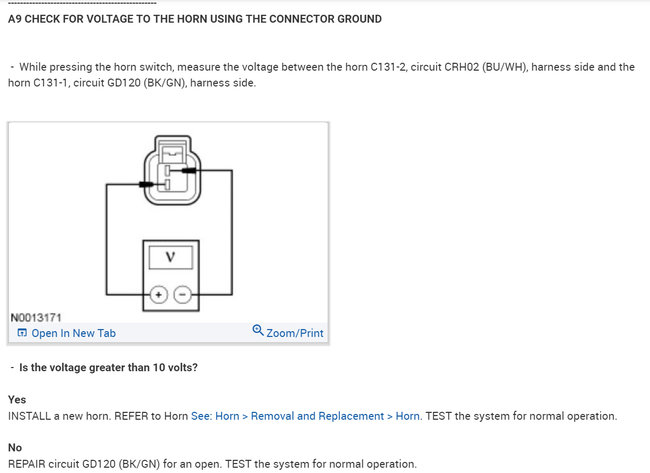

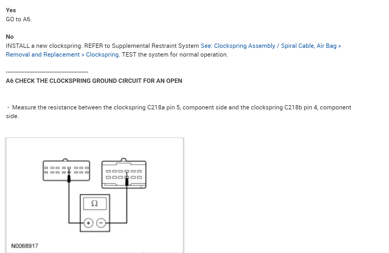

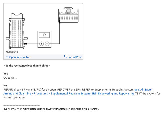

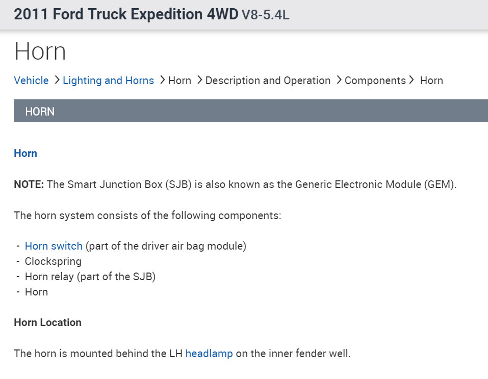

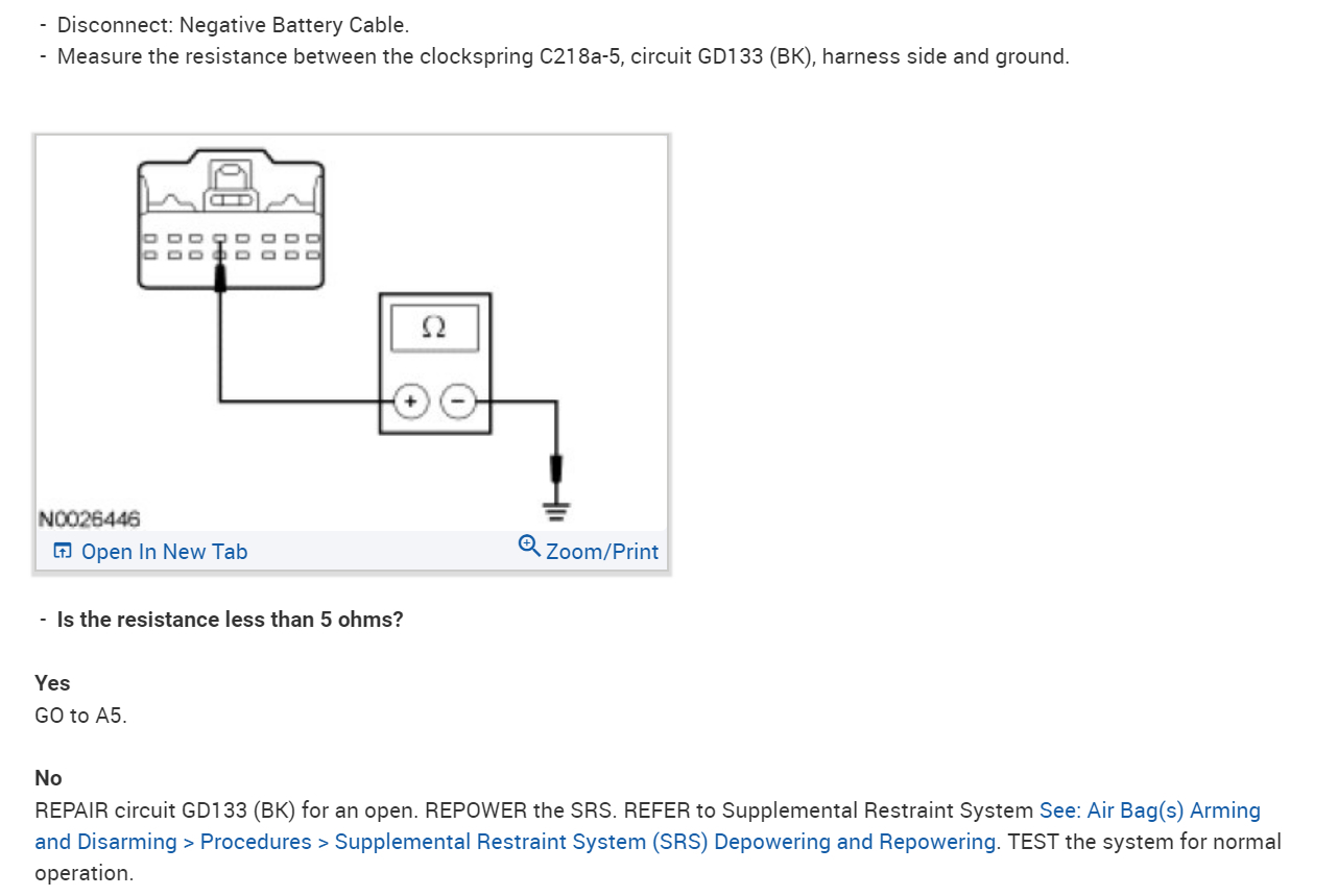

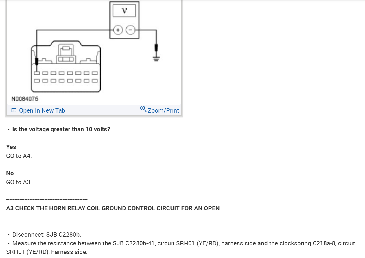

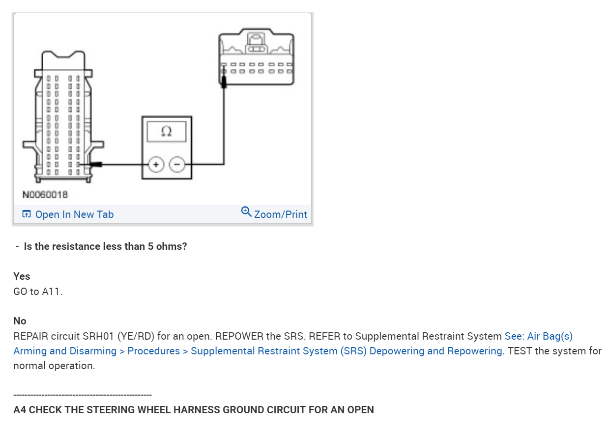

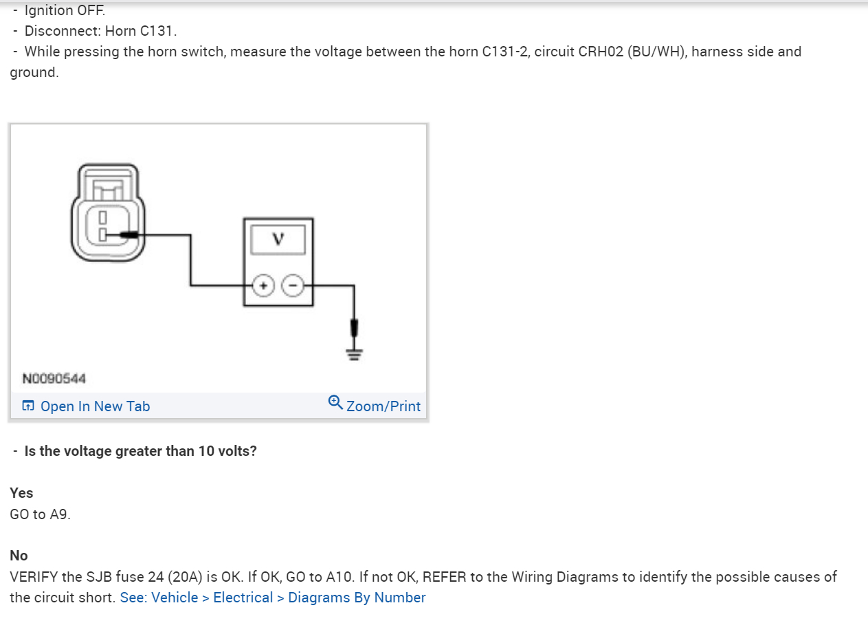

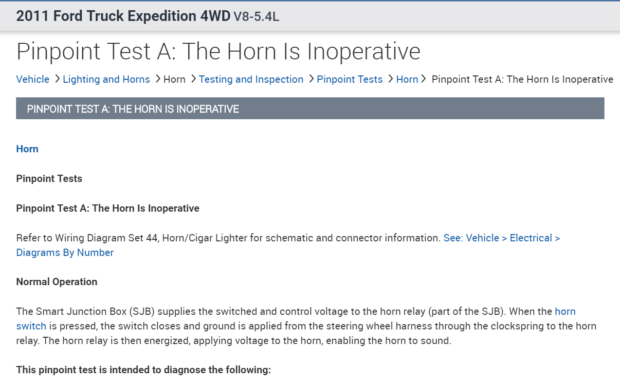

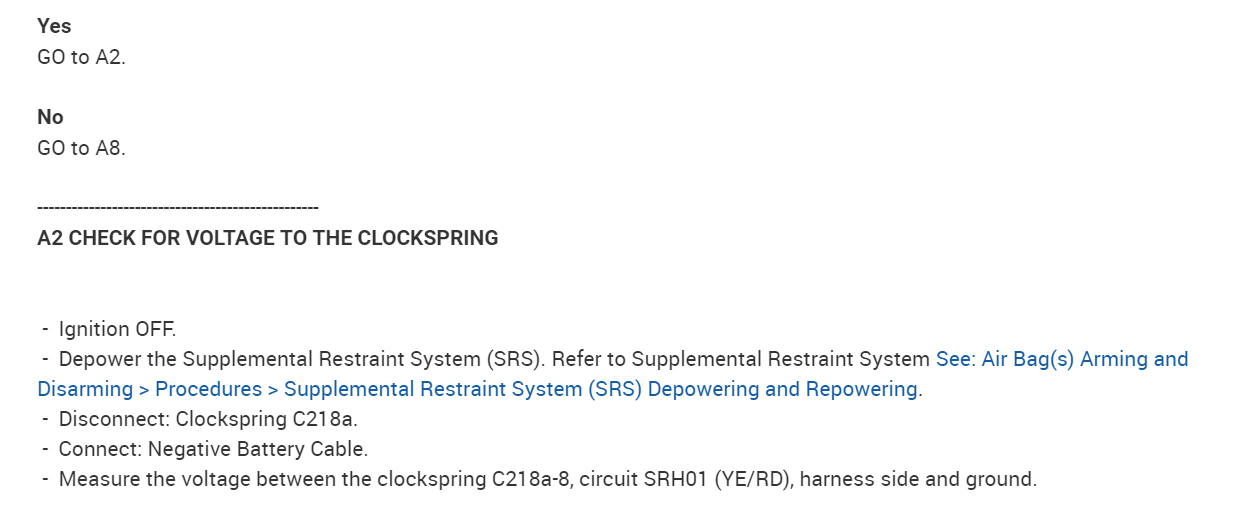

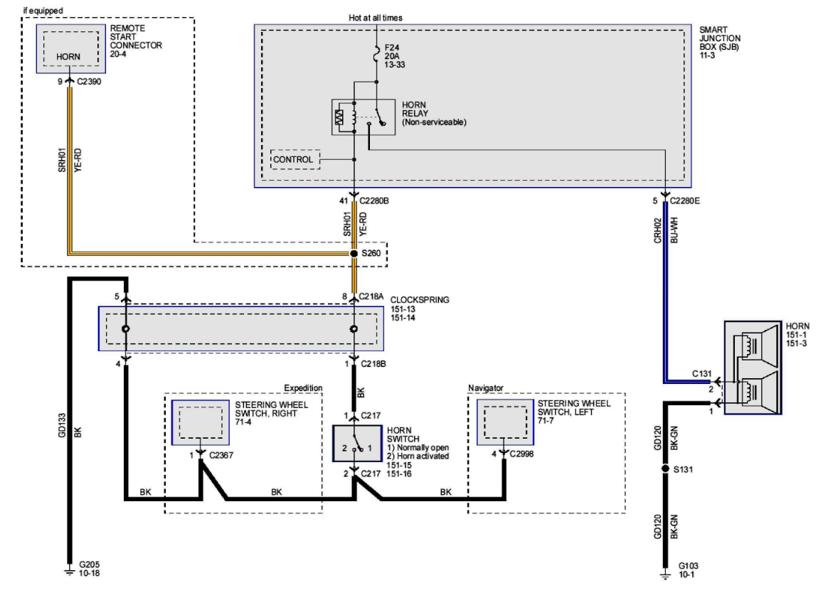

Pressing the horn on steering wheel makes no sound. The horn works via remote panic button. I took wheel apart and find there is no power to the horn switch. Fuse for horn checks fine, can't seem to find a "horn " relay.
Thoughts?
Feb 18, 2019 at 5:38 AM
SCGRANTURISMO
  • 4,897 POSTS

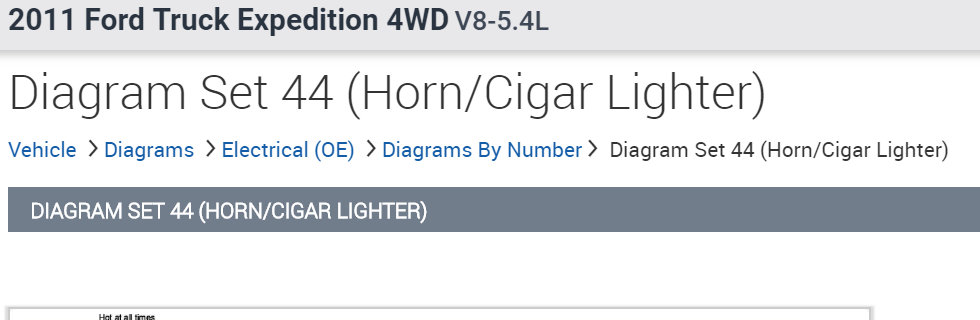

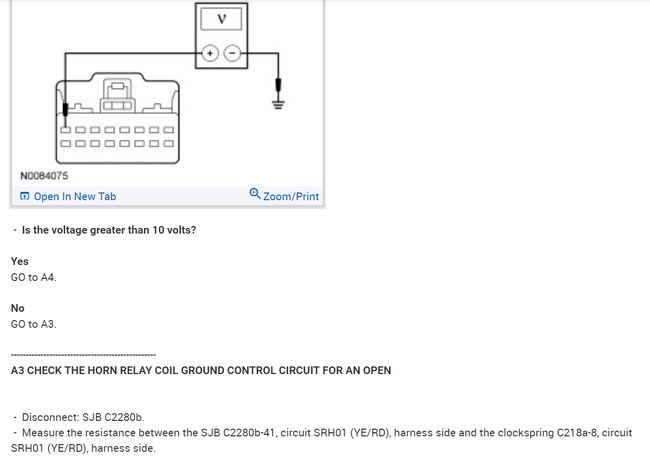

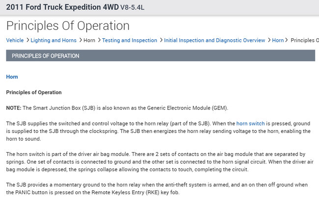

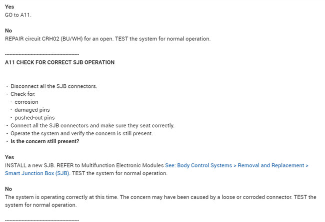

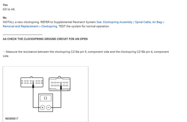

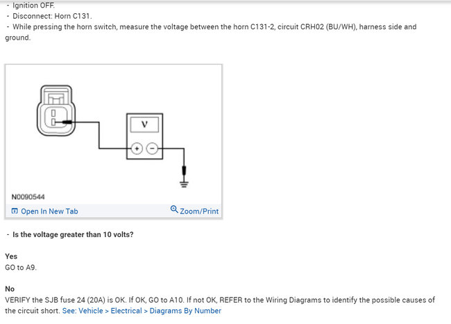

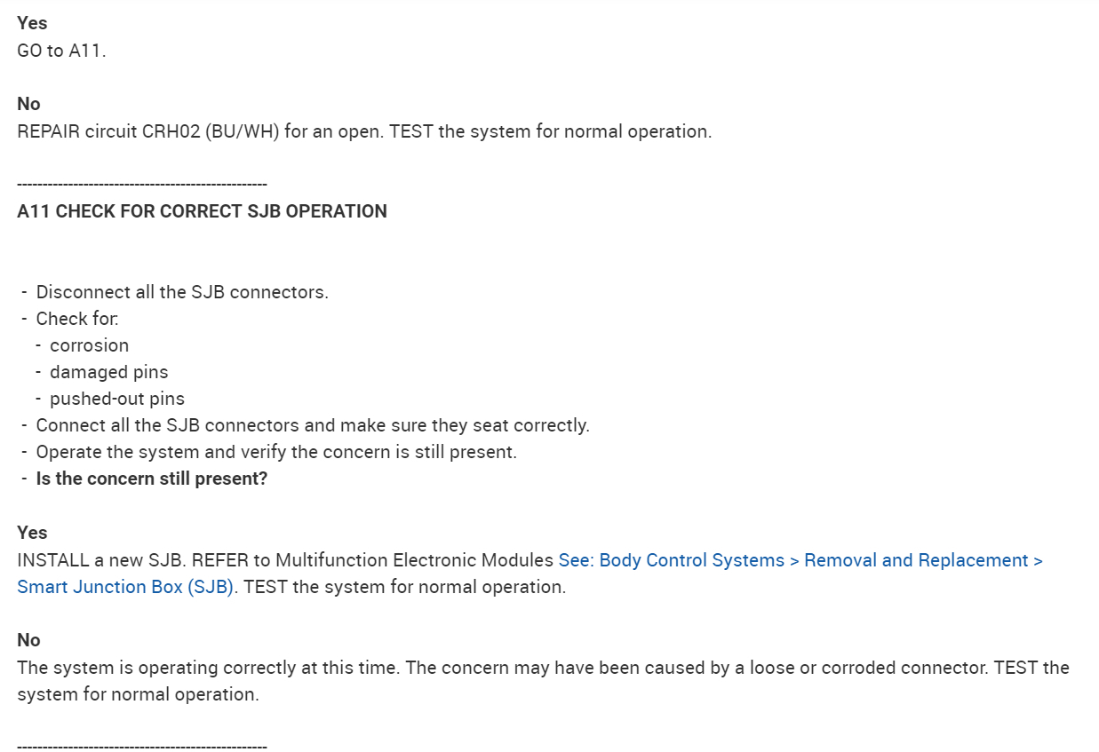

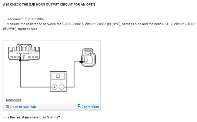

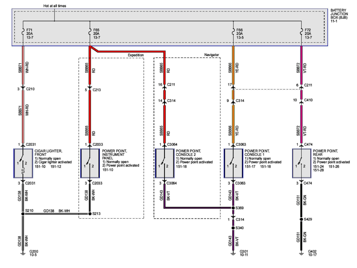

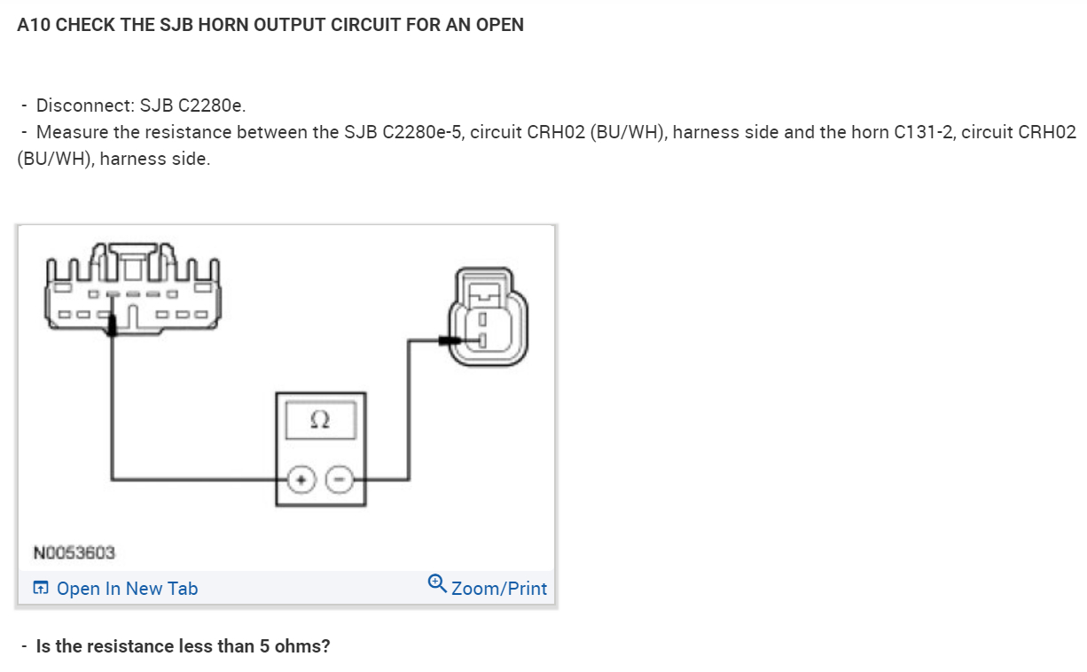

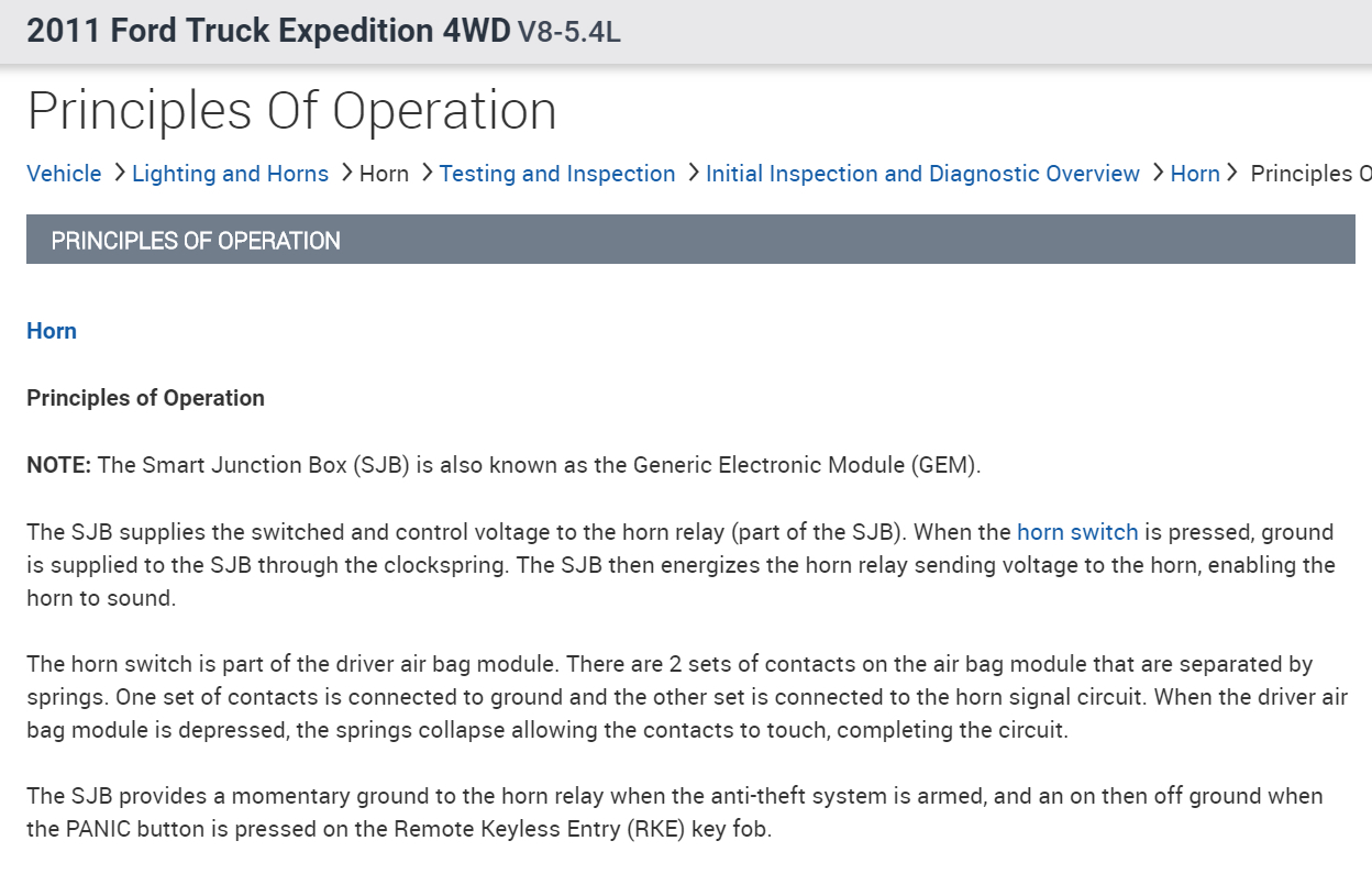

It does sound like the horn relay. In the diagrams down below I have included everything that you will need to fix your vehicles problem. Let us know what you find out.
Thanks,
Alex

Thank you for the information. I suspect it's the clock spring (a little loose and makes a slight rubbing sound) but will verify now that I can actually check connections.
Really appreciate your assistance!
