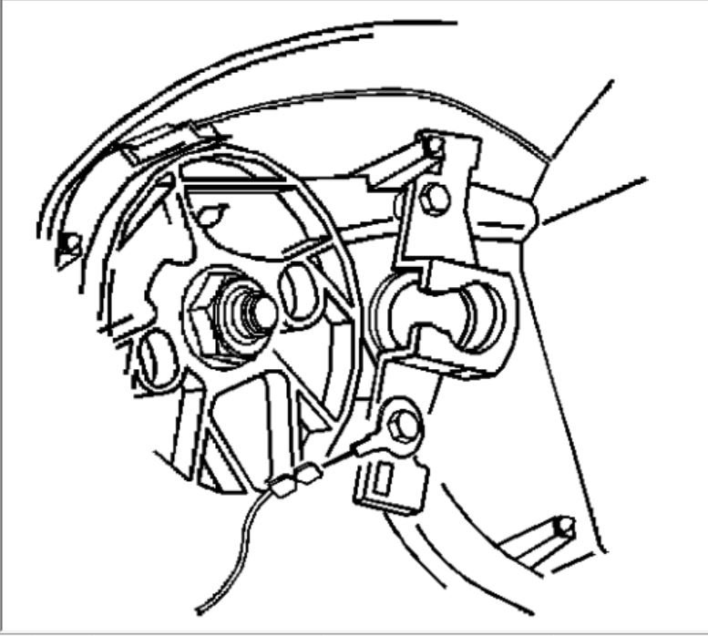

Need to replace horn switch.
Dec 20, 2020 at 3:49 AM
KENW1
  • 213 POSTS

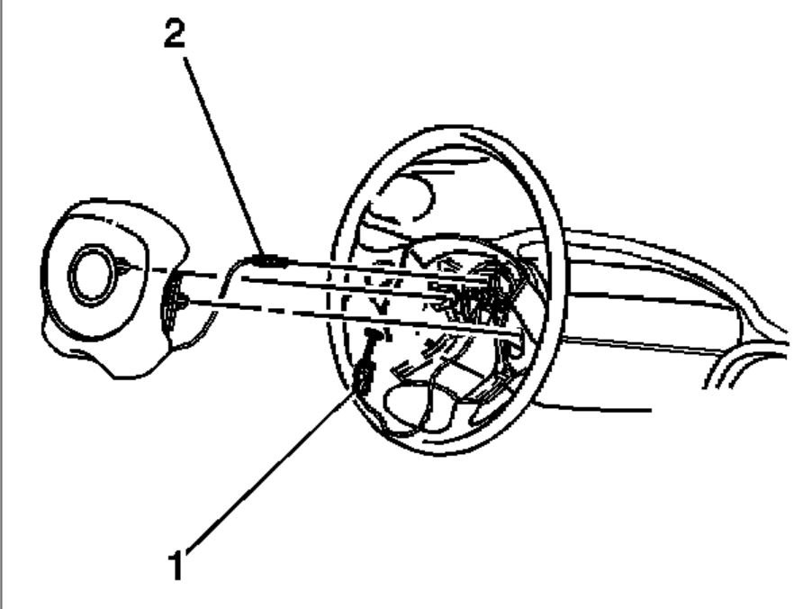

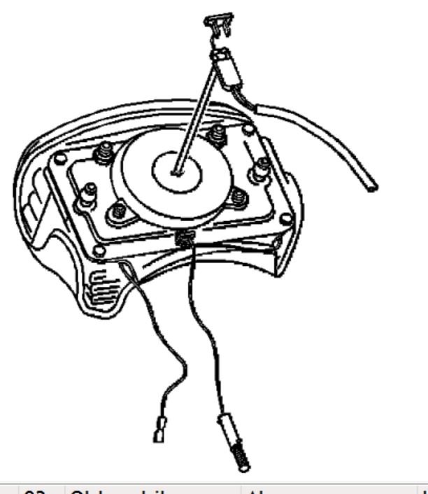

Have you checked to see if the horn relay is stuck?
If it is the switch you'll need to replace the air bag module. eBay and car-part.com would be good sources for one. Below is the replacement procedure

2. Remove the steering column trim covers.
3. Rotate the steering wheel 1/2 turn in order to access the screws to the steering wheel
inflator module at the back of the steering wheel.
4. Use a T30 TORX(R) in order to remove the inflator module screws.
5. Gently pull the inflator module from the steering wheel.
6. Remove the connector position assurance (CPA) from the yellow SIR electrical connector.
7. Disconnect the yellow SIR electrical connector from the steering wheel inflator module.
8. Disconnect the horn ground lead from the steering wheel.
9. Rotate the horn contact lead (2) counterclockwise 1/4 turn in order to remove the horn contact
lead from the steering column shaft tower.
10. Remove the steering wheel inflator module.
