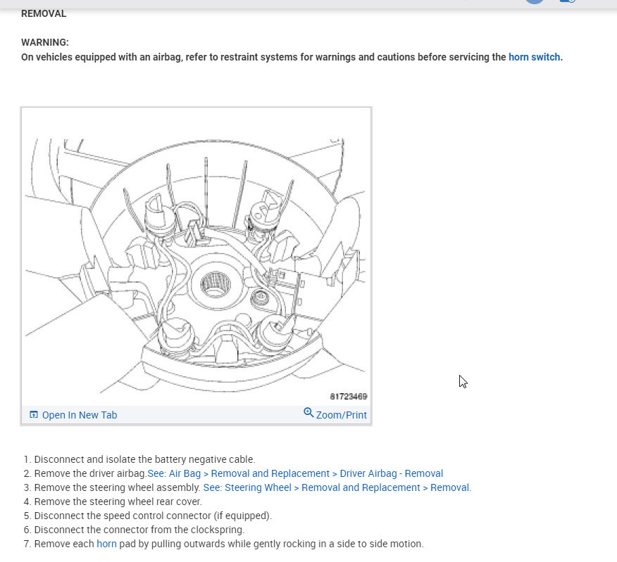

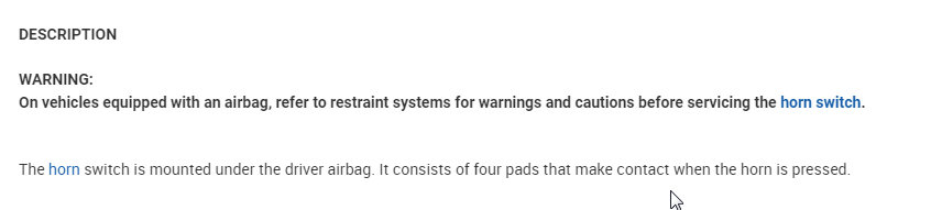

This is two different issues. The horn switch is the most likely cause of the horn not working. It could be the clock spring but it is more likely the switch contacts are worn and corroded. This is pretty common when the horn stops working. The way it works is, there is power always supplied to the switch and then when you press the horn it closes the contacts and it grounds the horn and it sounds.
