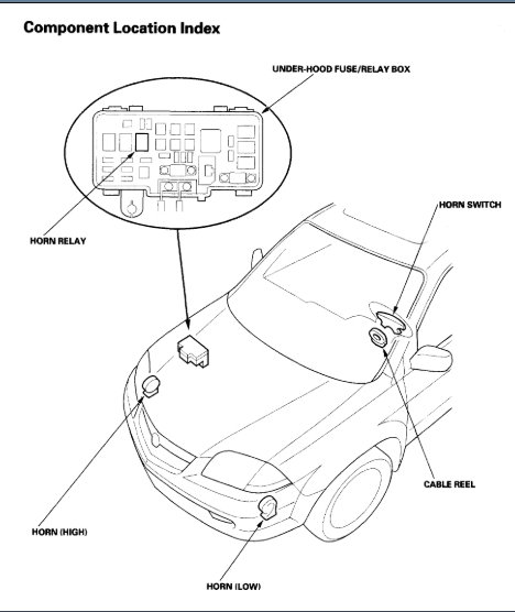

Horn sounds when jump start
170,000 MILES • AUTOMATIC
HELP NEEDED
I have the vehicle listed above. did not use it in many weeks. Battery died. When I apply the cables to battery, The horn goes off. How can I disconnect the horn (fuse)?
Apr 29, 2020 at 11:36 PM
DANNY L
  • 5,648 POSTS
Hello, I'm Danny.
If you need this as a temporary fix while jump starting the battery here is the info you requested. I've attached a picture below of where the horn relay is located in the under hood fuse,relay box. Hope this helps and thanks for using 2CarPros.
