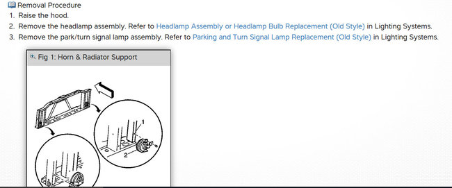

How to replace horns?
Jan 17, 2017 at 5:42 PM
HMAC300
Experienced Mechanic
48,601 POSTS
see pictures for removal install is reverse of removal.
