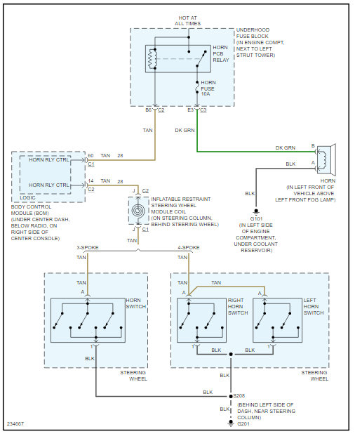

Need to see wiring diagram for horn.
Oct 6, 2019 at 7:07 PM

Hello, I'm Danny.
Here is a wire checking tutorial to view as well:

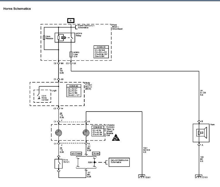

I've attached the wiring diagram for your vehicle below.One is color the other is black and white. Hope this helps and thanks for using 2CarPros.

Hey bro that was spot on. Appreciate it.
