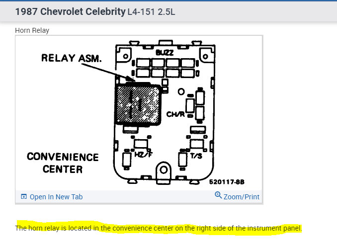

Where is the horn relay located?
1987 CHEVROLET CELEBRITY
78,000 MILES • 1.5L • 4 CYL • 2WD • AUTOMATIC
TERMAXCO
  • 54 POSTS
Or is there one? I found a couple of diagrams, but they don't look like under the hood.
Thank you!

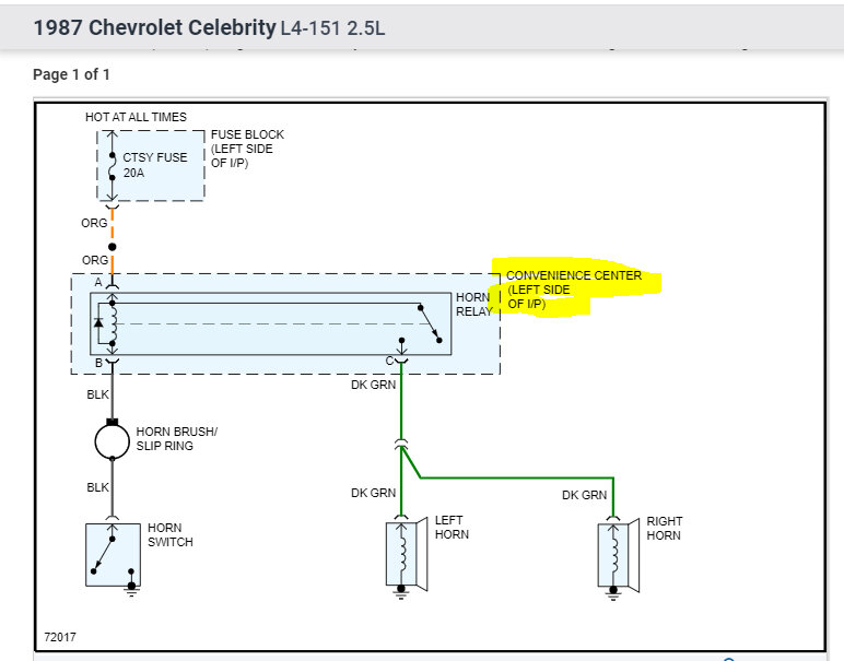

I found information indicating there is one. However, the wiring schematic indicates it is at the end of the left side of the instrument panel and when I tried to get a pic of it, the manual indicates it's on the right side. Ugh!!!
Check both sides and let me know if you find it. I attached the horn circuit schematic below, so you have a reference. Pic 2 is the alleged location. LOL
Let me know if this helps or if you have questions.
