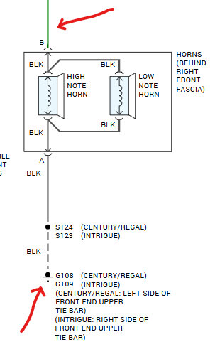

Somebody tried to steal my front grill one night and it set the factory alarm off. After a few hours of honking, my neighbor across the street came over @ 2am to let me know my alarm was going off. I tried to reset it with the remote, but I had to disconnect the battery to stop the horn. I checked the fuse, which was good, and swapped the horn relay with a known good relay (a/c clutch), but still the horn is not working. Got a horn off a junkyard Camaro, installed it and still no horn.

Yep, it sounds like the horn ground got disconnected, while honking the horn test the ground wire for power with a test light, if power is present the ground is no good.
The ground connection is at the upper left part of the tie bar. Also, check for power at the horn as well. This will tell us if the horn is getting power. Check out the images (below). Let us know how it goes, Ken
