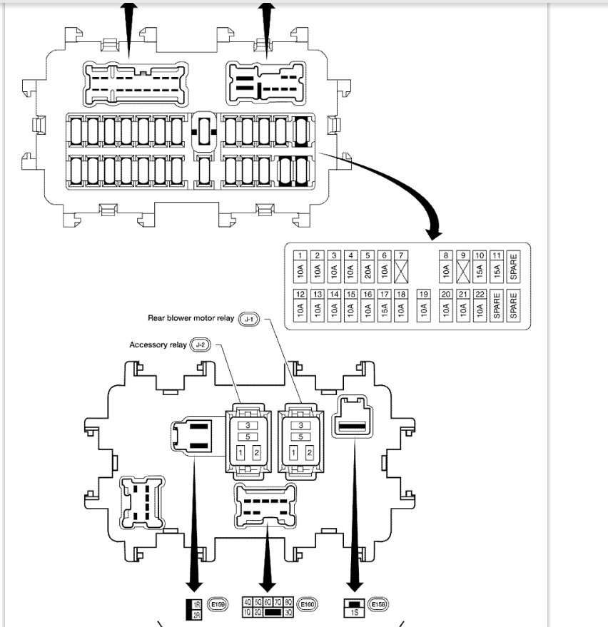

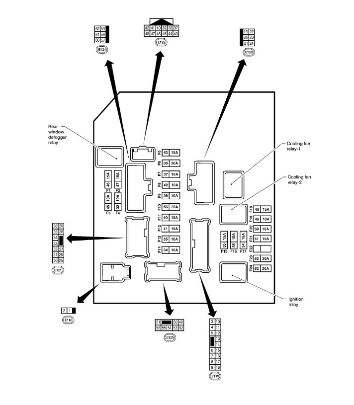

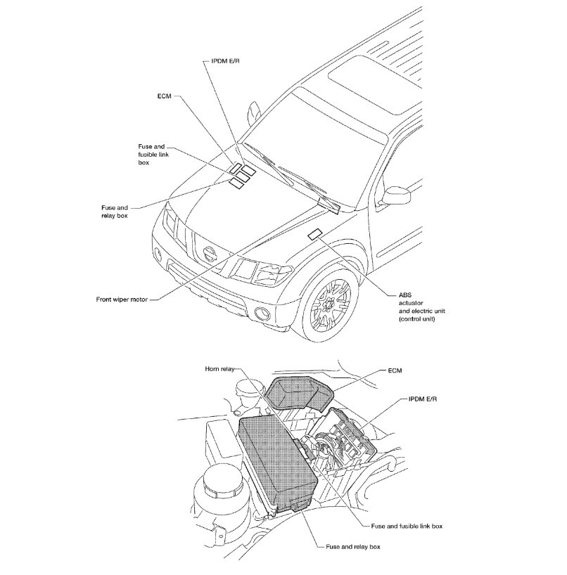

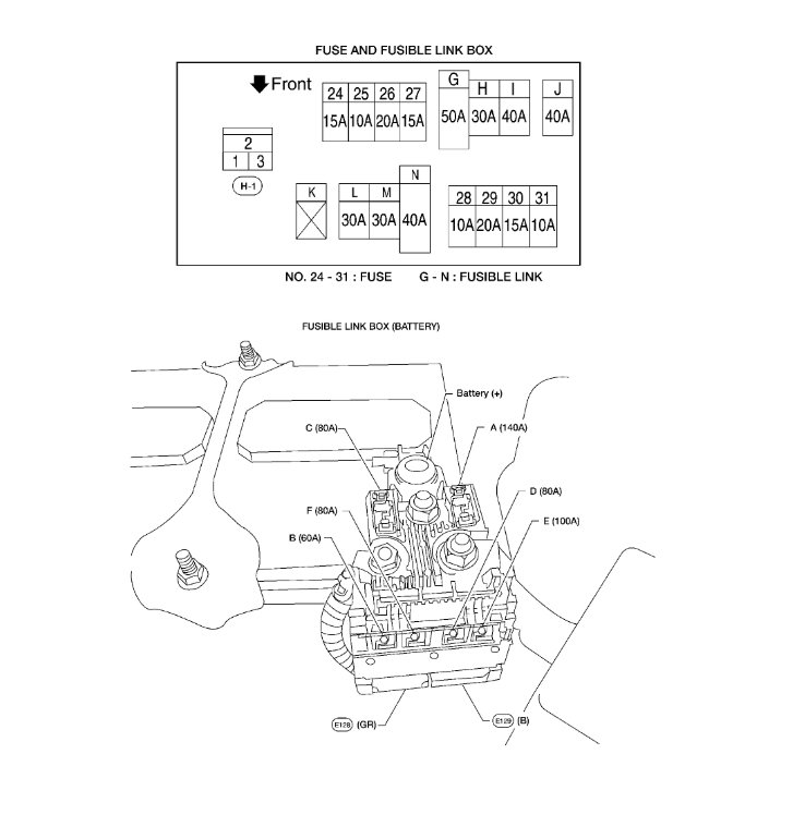

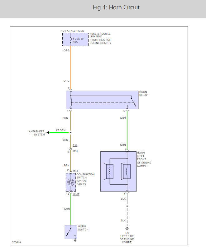

Let start by checking the fuse #30 in the under hood fuse panel. Here is guide to help check for power at the fuse and the horn wiring diagrams so you can see how the system works and the fuse locations well:
If the fuse is okay let's check the horn relay.
