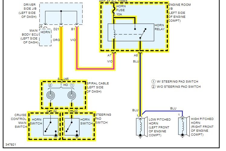

Horn not working
2012 TOYOTA TUNDRA
72,000 MILES
TAMERA M JOHNSON
Horn was working but now it’s not working at all.
May 6, 2020 at 9:45 PM
  • CAR REPAIR CONTRIBUTOR
Good morning,
I attached a wiring diagram for you to view.
We need to do some testing to find where the failure is located. I doubt both horns failed at the same time.
Do you have a test light to some wiring checks?
