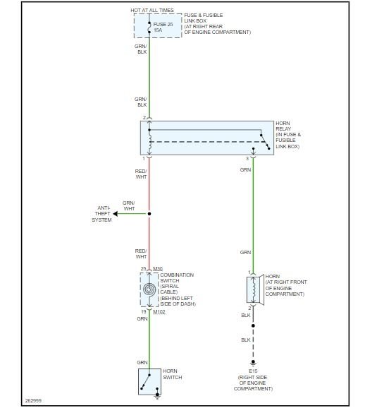

Sometimes my horn does not work.

Good morning.
Did you try pressing different areas of the horn pad itself?
Check the fuse listed for the horn and there is a relay in the relay box listed.
Image (Click to enlarge)
