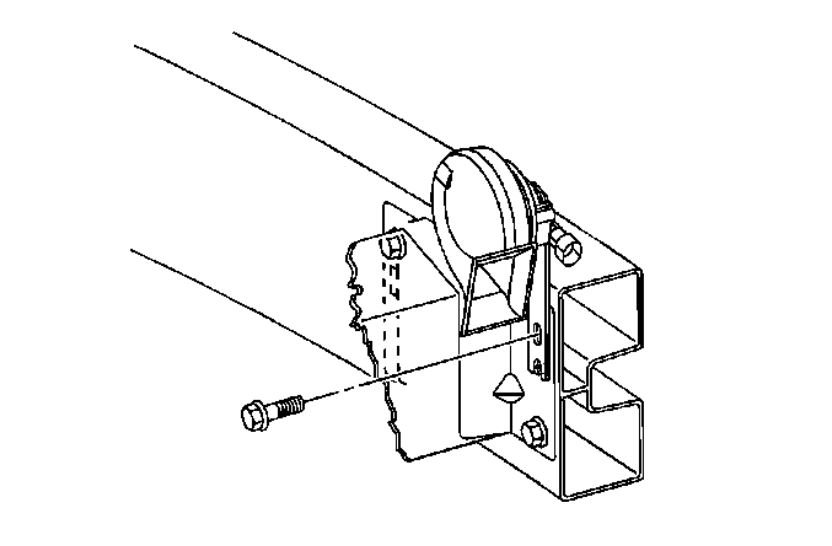

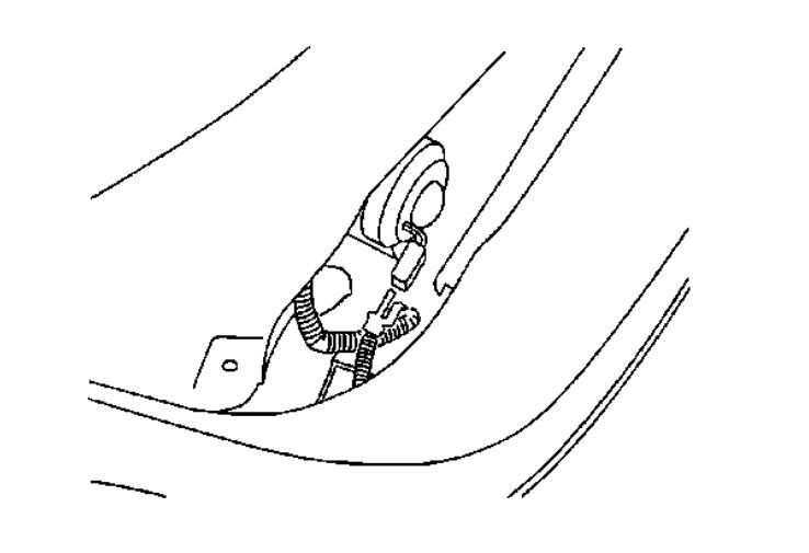

Horn fuse and relay okay. horn does not work.
Apr 9, 2019 at 6:43 AM
Good afternoon,
The horn or horns if you have more than one are behind the headlights and down.
I posted the procedure and some pictures for you to view.
Horn Replacement
Removal Procedure
1. Remove the right and/or left headlamp.
2. Disconnect the horn electrical connector.
3. Remove the horn bracket bolt.
4. Remove the horn from the front bumper impact bar.
Apr 9, 2019 at 8:02 AM
