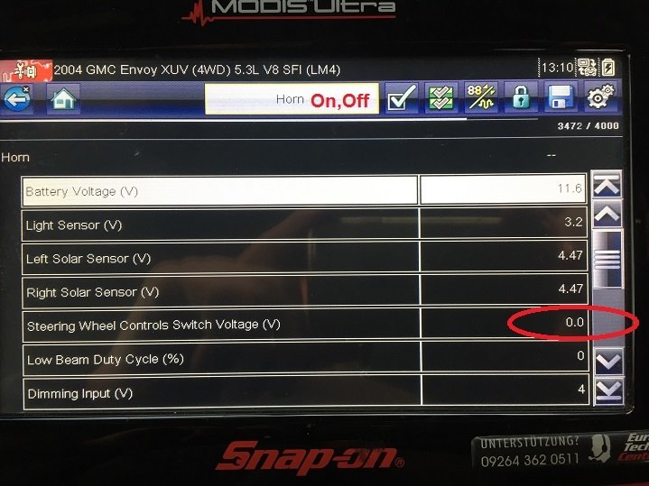

Hi guys, I push button on steering - is not working.
With Scan tool push button Horn On, Off - horn is working.
On picture, red circle - 0 voltage, Steering wheel coil defective?
Picture below.

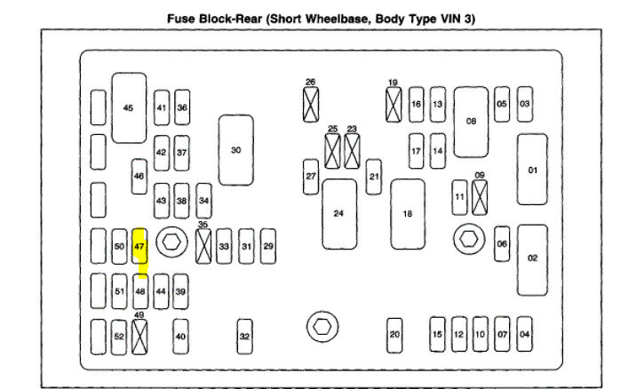

If there is no power to the switch, first make sure the fuse is good. In the rear fuse box, check fuse 47 (ign 0) fuse. That is what powers the switch. See pic 1 below.
In addition to checking the fuse, make sure there is power both to and from it. Here is a link you may find helpful:

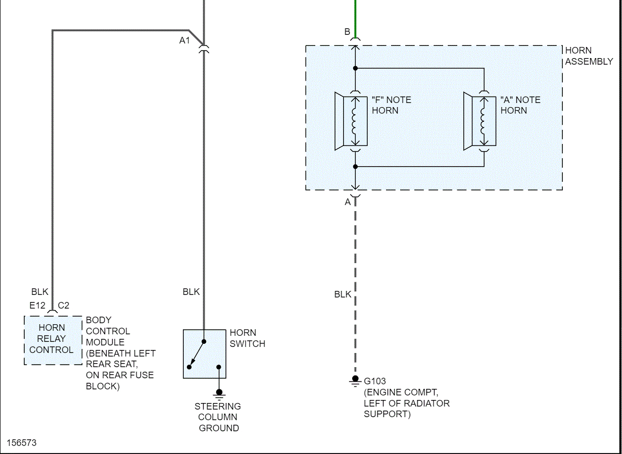

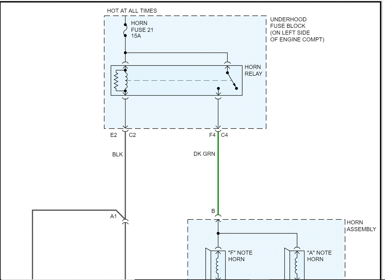

Also, the last two pics below are the wiring schematics for the horn circuit. I thought it may help you as a reference. I cut the schematic in half to make it readable, but I did overlap them so you can follow from one to the next.
You mentioned the clock spring, yes it could be an issue. However, oftentimes that will also cause all steering wheel functions to fail.

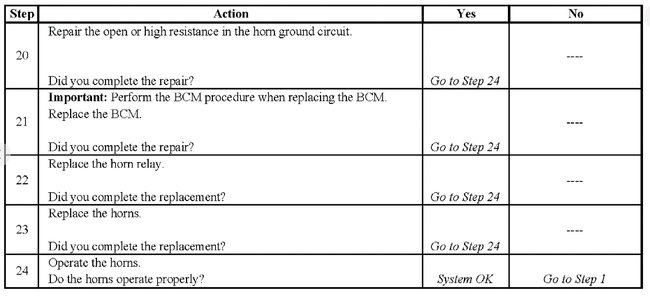

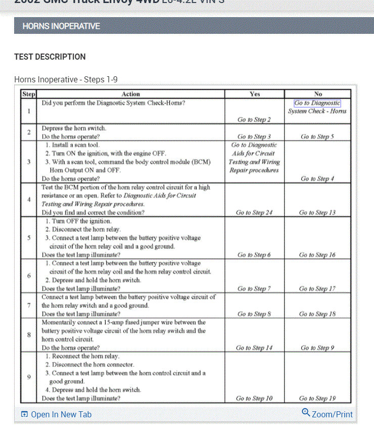

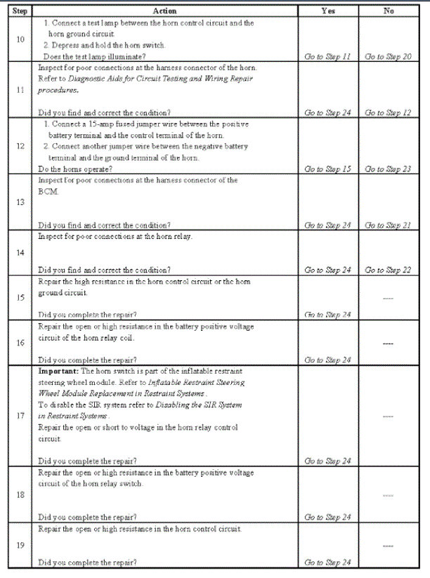

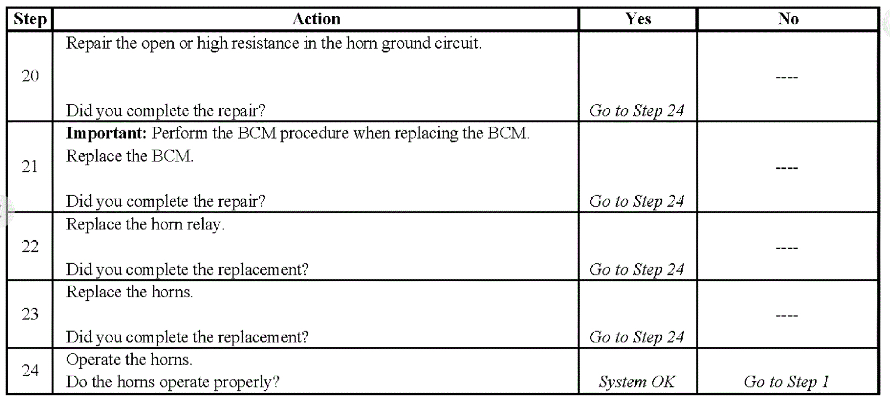

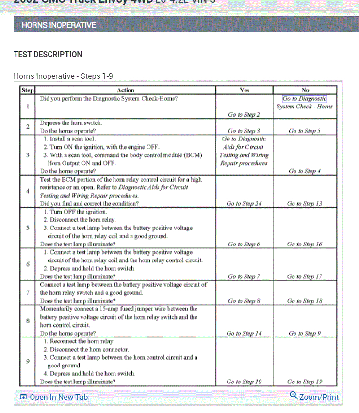

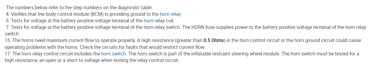

Do me a favor. i attached diagnostics related to an inoperative horn below. Take a look through them and see if they help. I know you already have performed some of it.

Horn works again but i did not fixed it. Just checked fuses, all are okay. I believe clock spring on steering wheel has bad connection.
