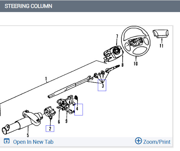

Is there any chance you can provide an exploded view diagram of the assembly so I can see the parts before I remove the wheel? My model is a 1989 GTA trans am with no airbag or radio buttons on the center pad. Thanks

Sure, here is a exploded diagram so you can see what you are getting into with the repair.
Apr 15, 2025 at 2:32 AM
  • 55,756 POSTS
Sorry, I forgot the image.
Apr 17, 2025 at 5:28 AM
