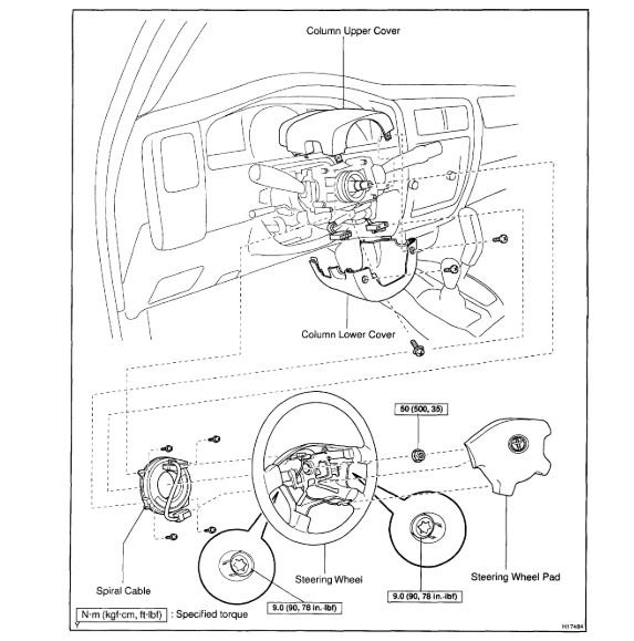

Horn going off when headlights are on. have had two different body shops and can't find nothing please help. could it be my clock-spring is bad?

Does the steering wheel have lights that come on when the lights come on? If you do, they yes, it could be the clock spring.
clockspring assembly spiral cable air bag

2001 Toyota Truck Tacoma Extra Cab 2WD V6-3.4L (5VZ-FE)
Removal and Installation
Vehicle Restraints and Safety Systems Air Bag Systems Clockspring Assembly / Spiral Cable Service and Repair Procedures Steering Wheel Pad and Spiral Cable Removal and Installation
REMOVAL AND INSTALLATION
Steering Wheel Pad And Spiral Cable
Components
Removal
1. Remove steering wheel pad
2. Remove steering wheel
3. Remove upper and lower covers
4. Remove spiral cable

No, it has no lights on the steering wheel.
Mar 10, 2019 at 5:38 PM
Got it.
You have a wiring issue somewhere in the system. You need someone who specializes in electrical repairs to track this down.
