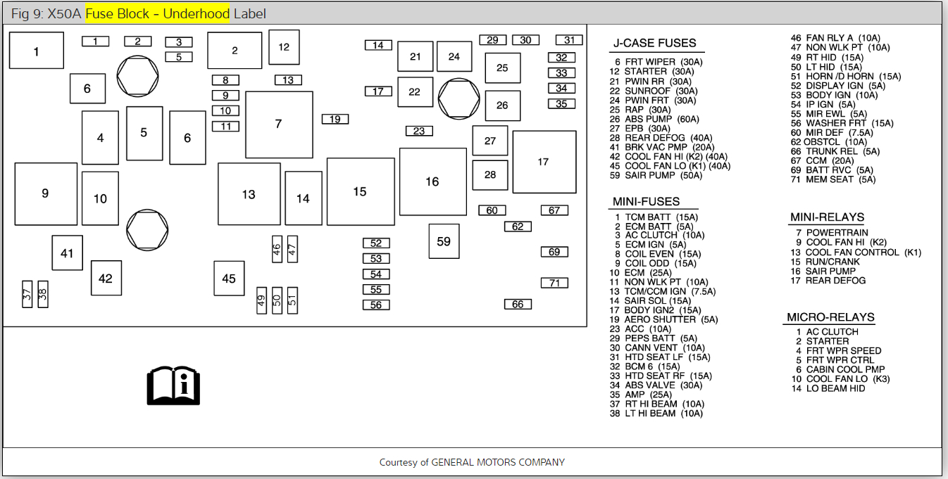

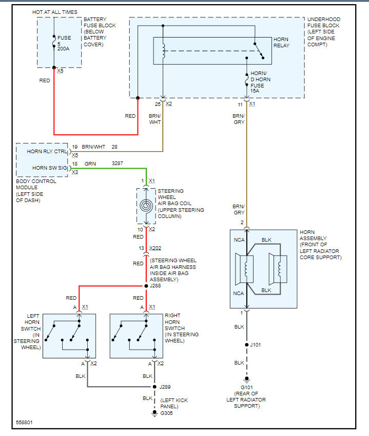

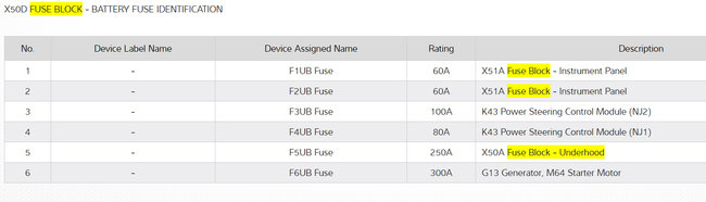

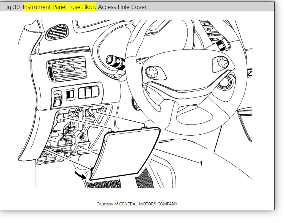

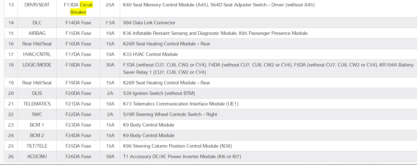

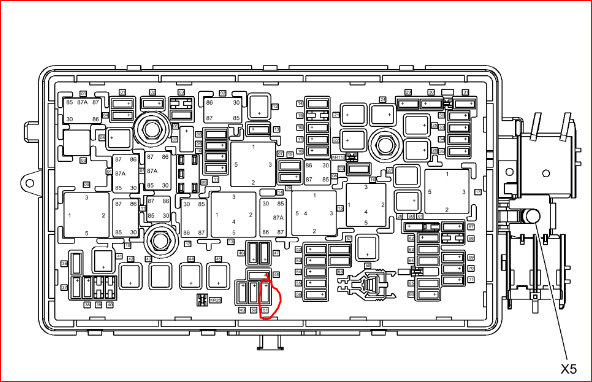

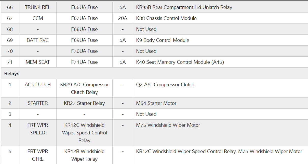

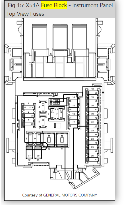

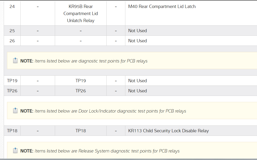

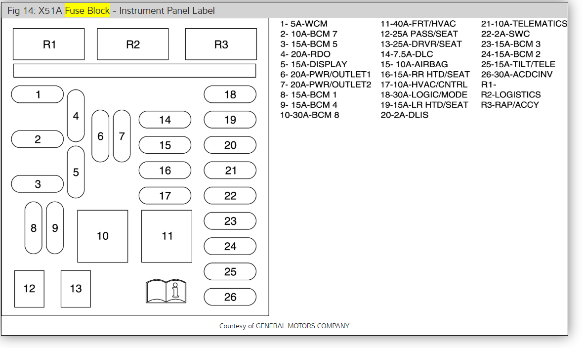

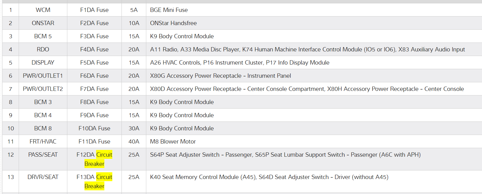

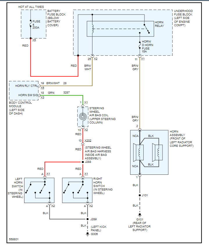

Need the location of the horn, fuse and relay.
Jul 27, 2018 at 12:49 PM
Good afternoon.

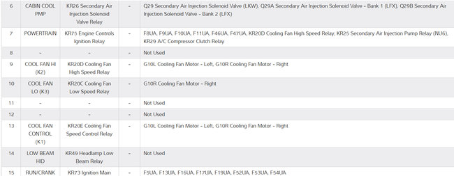

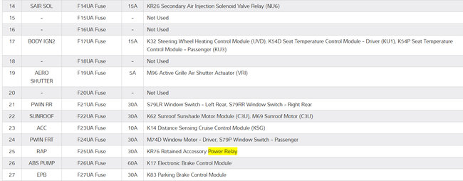

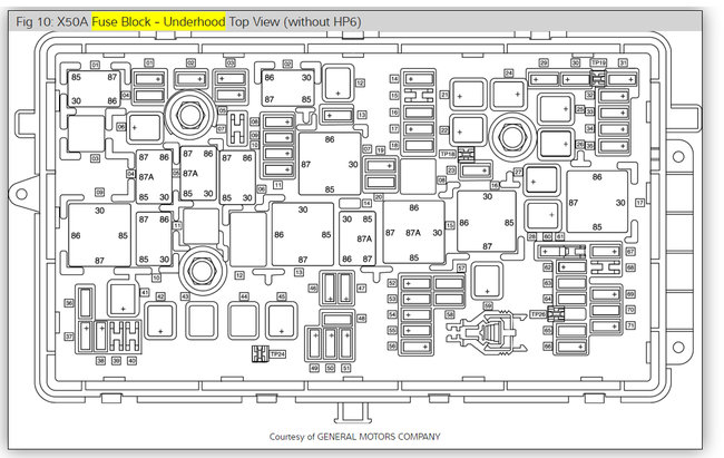

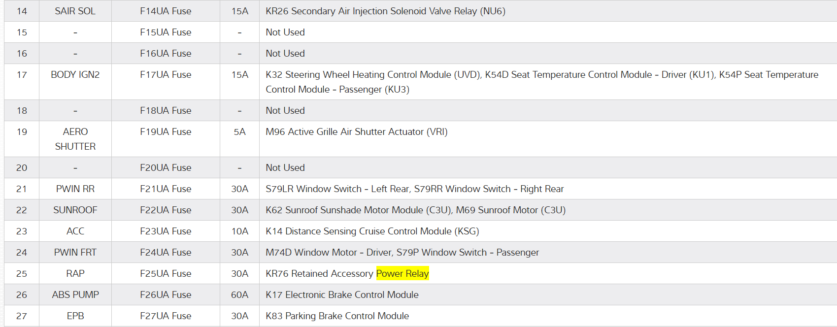

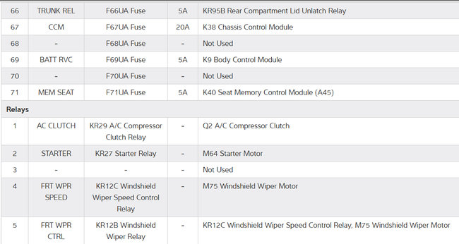

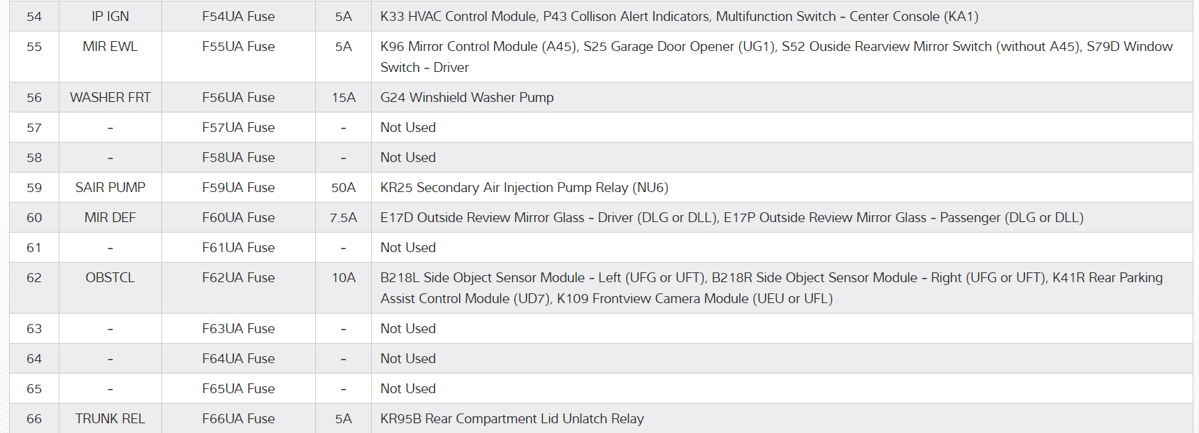

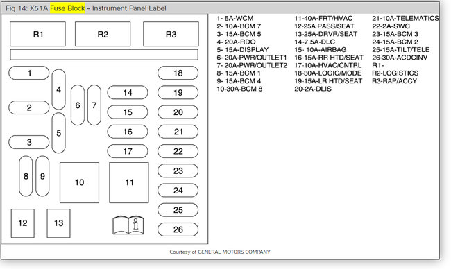

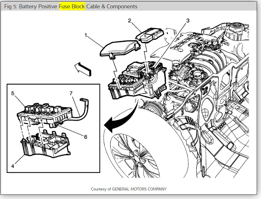

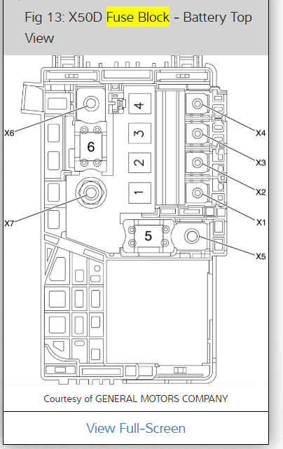

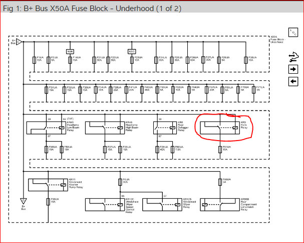

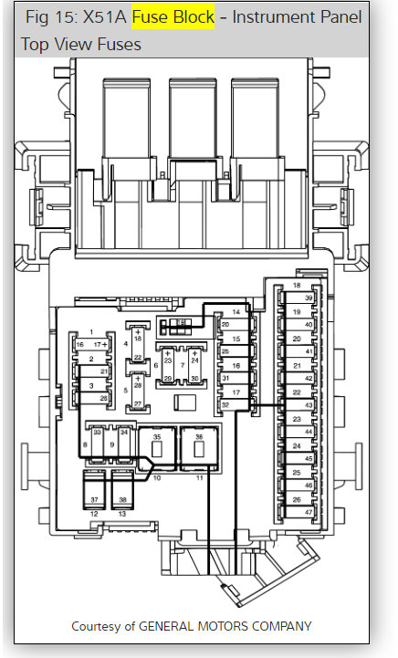

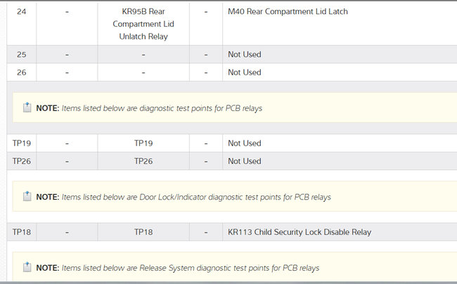

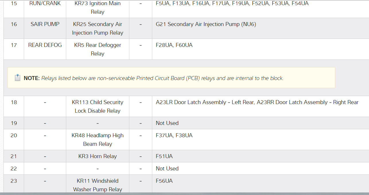

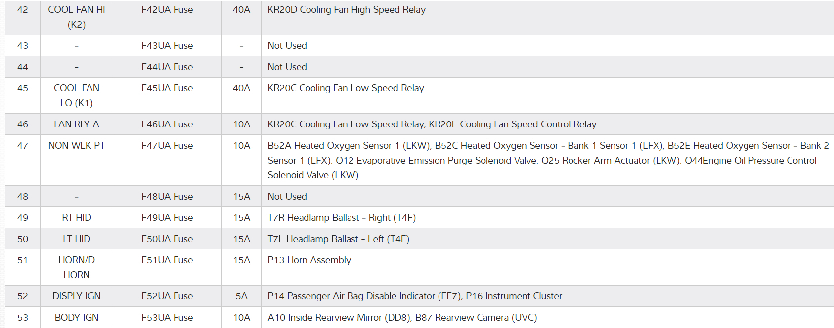

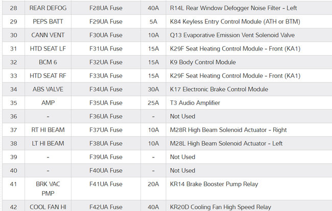

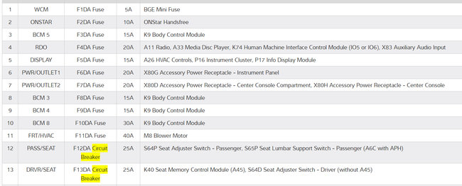

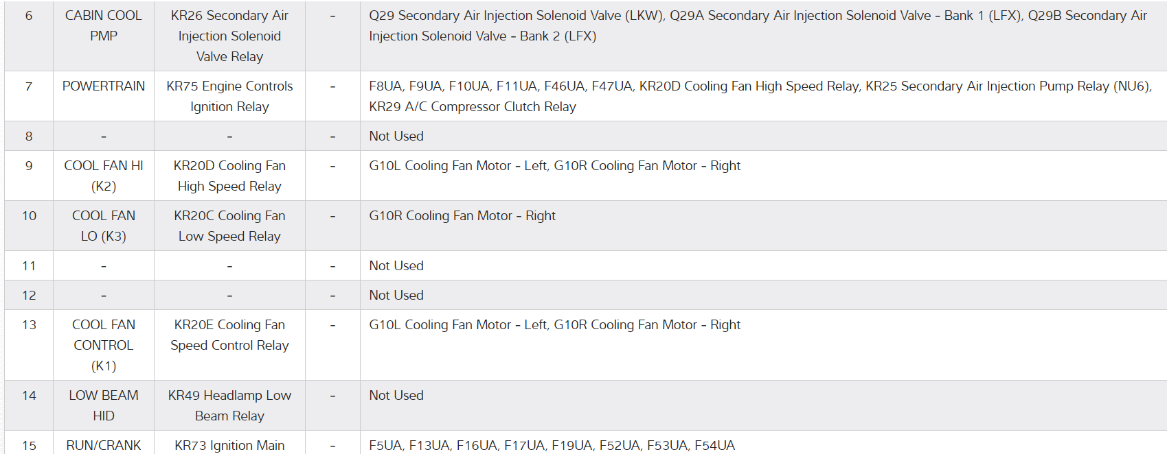

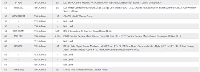

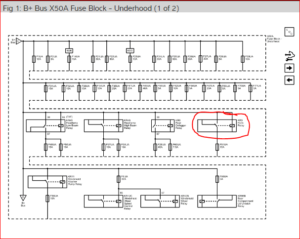

The horn relay is in the under hood fuse block. Verify power to the relay lets use this guide to test. Also I have included the fuse panel and relay location diagrams below for the car with the horn wiring diagrams so you can see how the system works.
Check out the diagrams (Below). Please let us know what you find. We are interested to see what it is.
Jul 27, 2018 at 2:34 PM
DANNY L
  • 5,648 POSTS

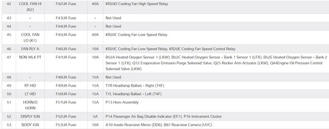

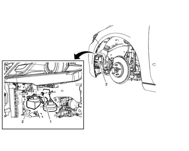

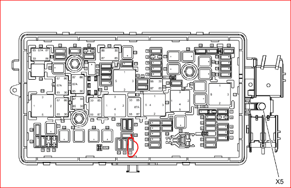

Fuse box under hood- Fuse is located #51, relay location #21. Pictures attached. I added the horn location as well

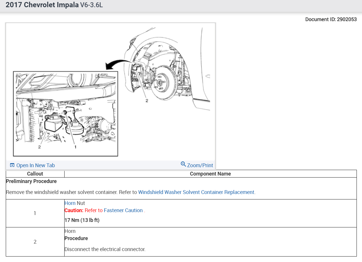

Where is the location of the horns?
Jul 27, 2018 at 2:45 PM
Picture attached for you.
