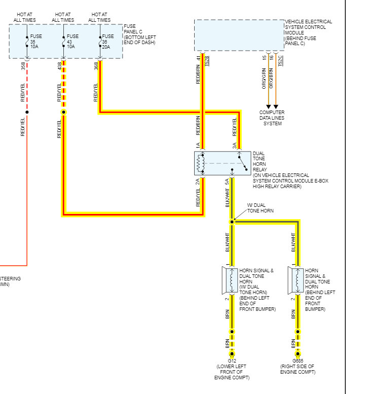

Well, my horn doesn’t work, not my alarm horn doesn’t work. I have no fuse diagram either. Can you please help?

Inoperative horn can be due to a bad fuse, horn relay, faulty horn or wiring.
There should be a 20A fuse on the bottom left hand of the dash powers the horn.
I have attached the wiring schematics below for the horn. It shows the fuse location as well as the relay.
Let me know of any questions.
