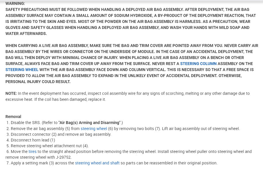

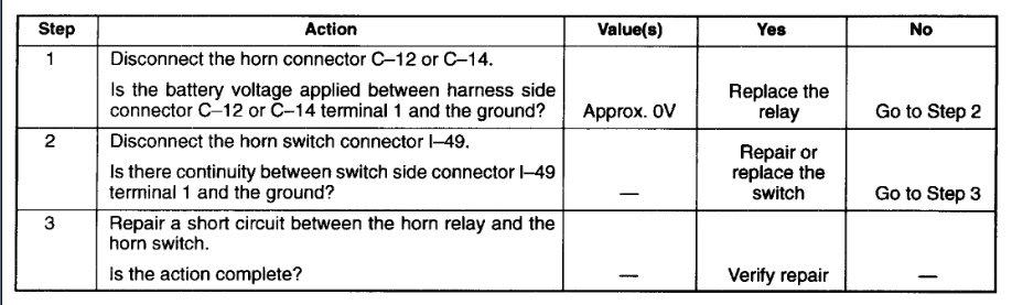

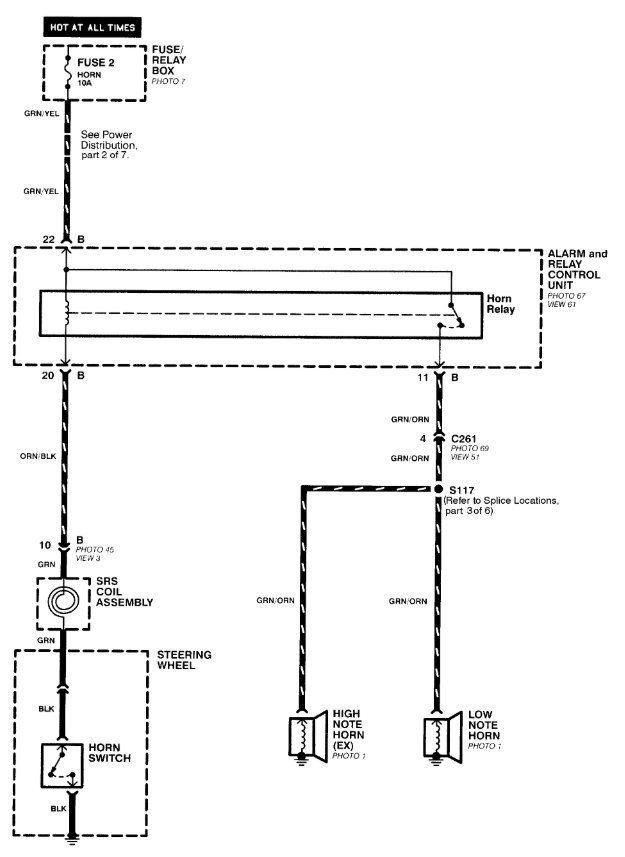

More than likely this is the switch but here is a test that will help confirm this.

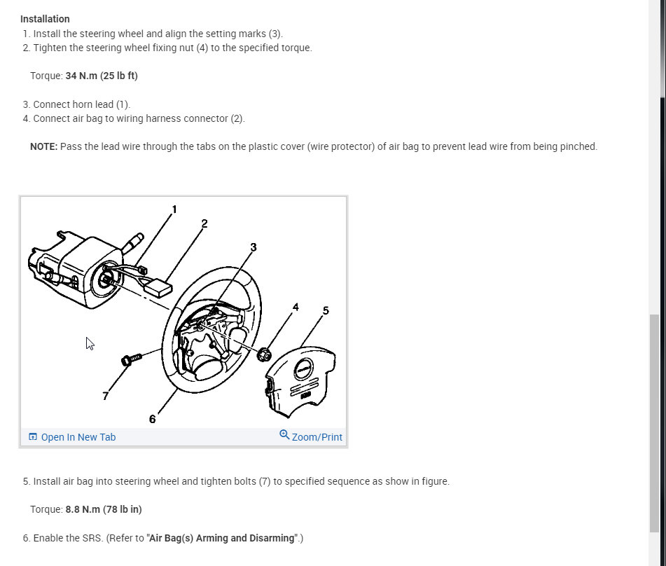

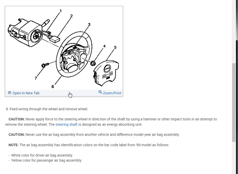

If I am correct and it is the switch, here is the procedure on how to remove the steering wheel. You do not need to completely remove it but they don't have a process for just the switch. This is not a terribly complicated but you are touching things relate to the air bag and the airbag itself so if you are not comfortable with this, I would have someone else do it.
Let me know if you have questions. Thanks
