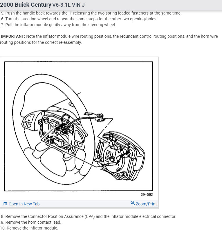

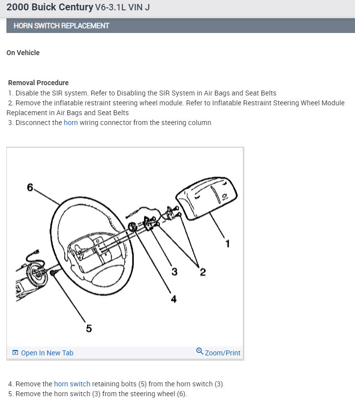

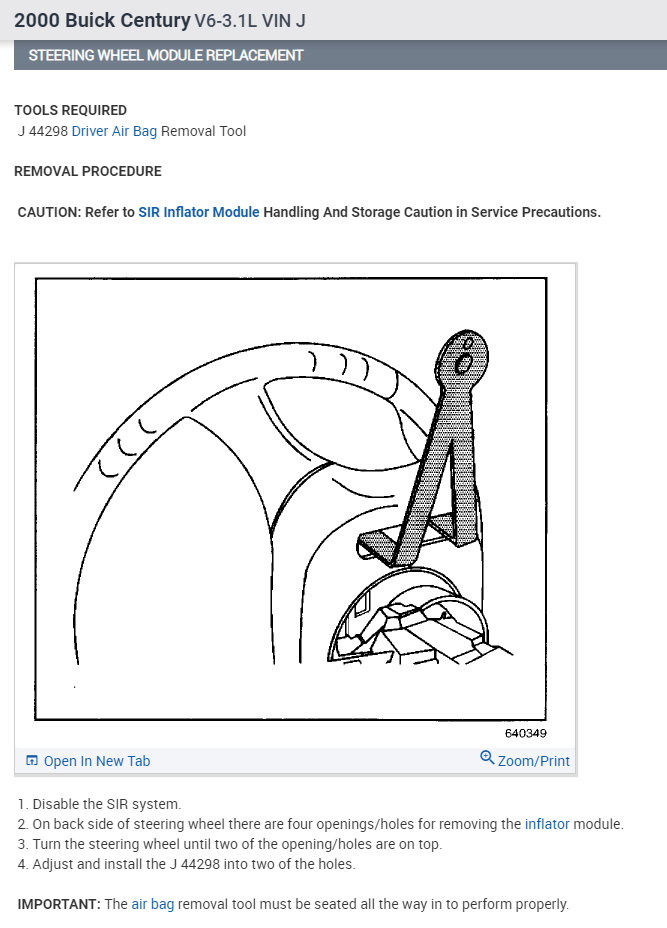

Trying to replace the horn button in this car, I can't figure out how to get the airbag off. I know there are these clips holding the bag to the steering wheel, but is there any special tool to undo the clips easier?
I appreciate any inputs.
Thanks a lot.
Jan 15, 2022 at 6:21 AM
SQM
  • 6,383 POSTS

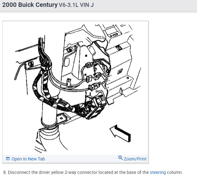

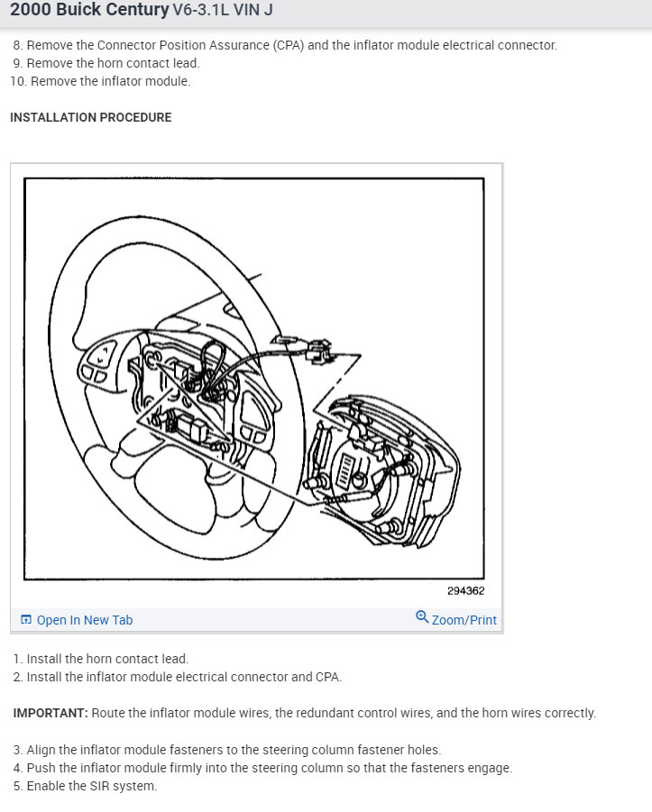

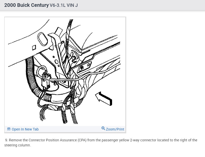

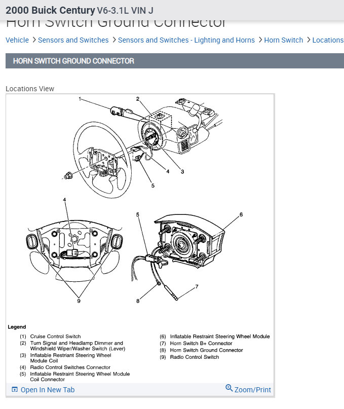

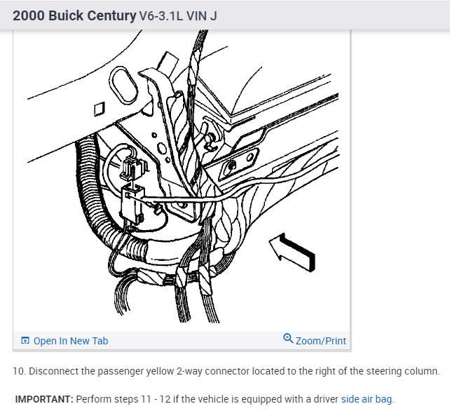

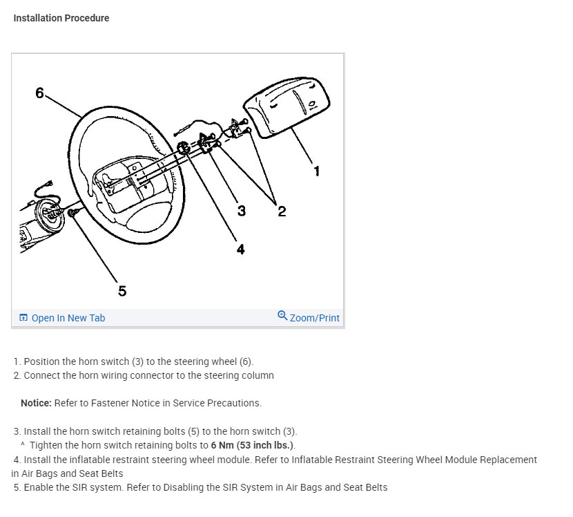

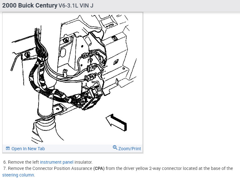

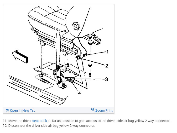

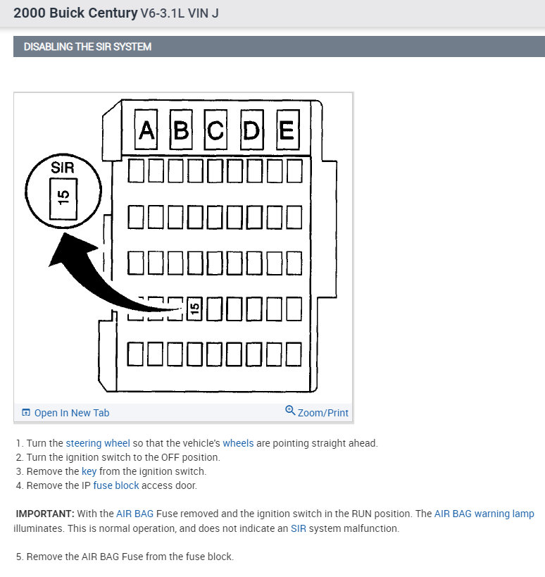

To remove the air bag from the steering wheel you will need a special tool.
Always remember to take extra caution before working with the airbag system and always disable the airbag system first before starting the task.
https://www.2carpros.com/articles/air-bag-removal-steering-wheel
I have attached the air system disable procedure, airbag removal, and the horn switch replacement procedure below. It shows the special tool that you will need as well.

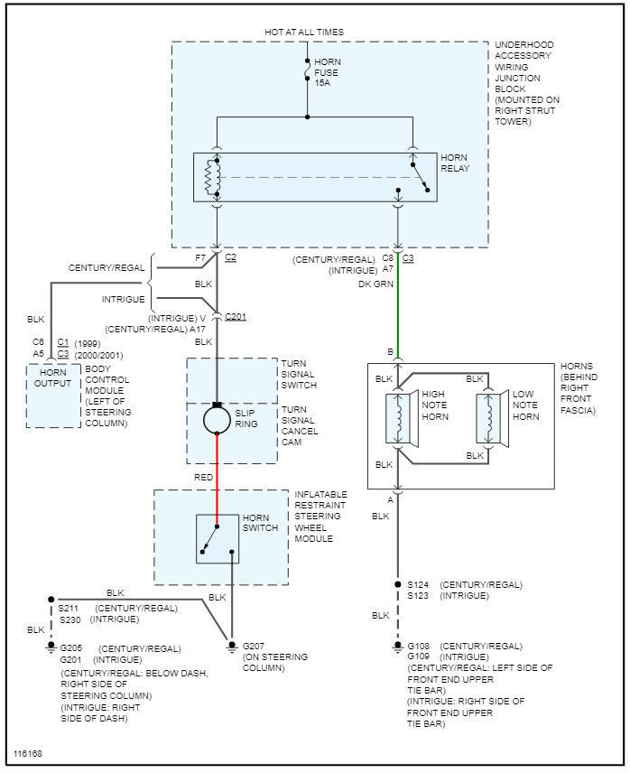

Hi Sean, first thanks for your fast response. I appreciate it. Secondly, I think i'm going to bypass the original horn switch and hook up an aftermarket one. Would that be smart and easier? Do you have the horn wiring diagram, by any chance?

You can bypass the factory switch and just have an aftermarket setup. You will just have to tap into the horn wire or have a new horn setup.
However, this might not pass your state's safety inspection due to not using the factory horn switch.
I have attached the wiring schematics for the horn below.

If you don't have to worry about state inspection you can put an aftermarket switch. Horn wirings are fairly simple. All you will need is power and ground and the switch to complete the circuit.
Let me know if you have any questions.
