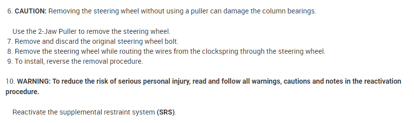

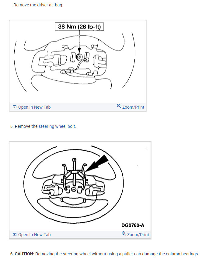

I got a new steering wheel but I don't know how to install it?

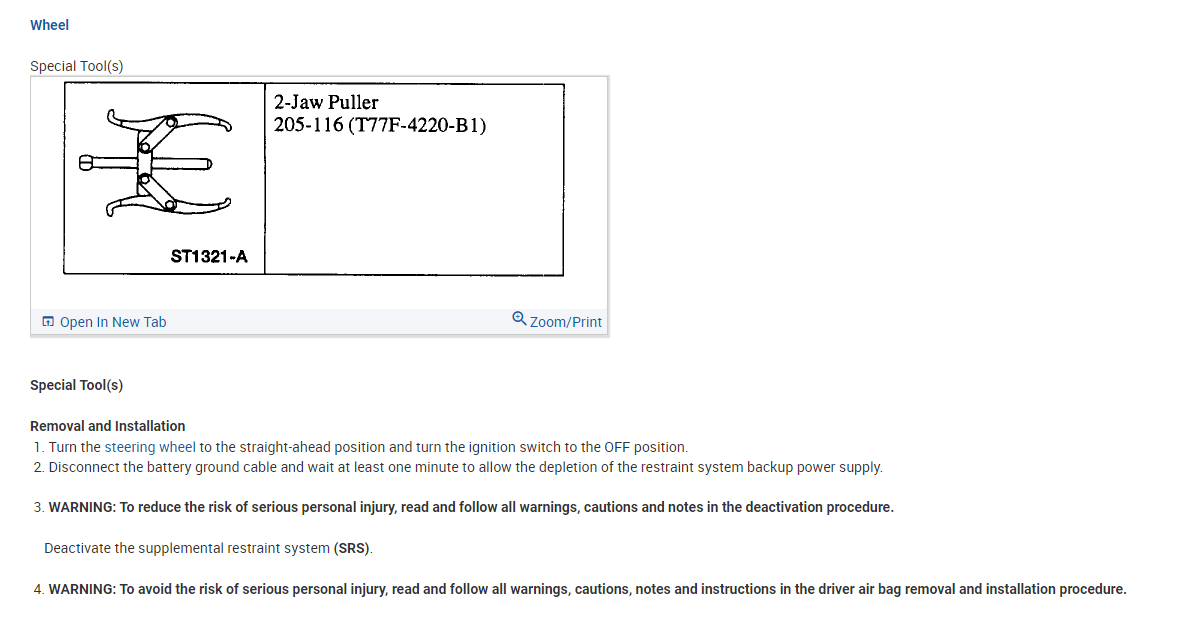

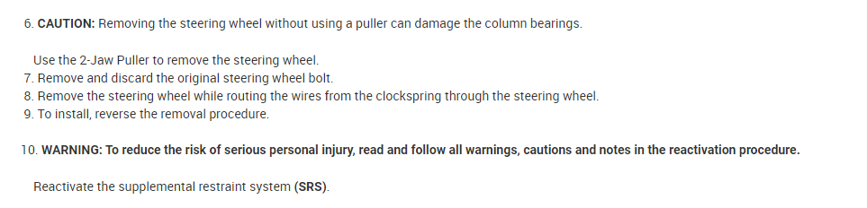

Here is the information you requested. Here is a tutorial showing how to replace a steering wheel:
https://www.2carpros.com/articles/steering-wheel-removal
I've attached picture steps below showing how to remove and replace the steering wheel on your F-150. Hope this helps and thanks for using 2CarPros.
Jul 3, 2021 at 3:49 AM

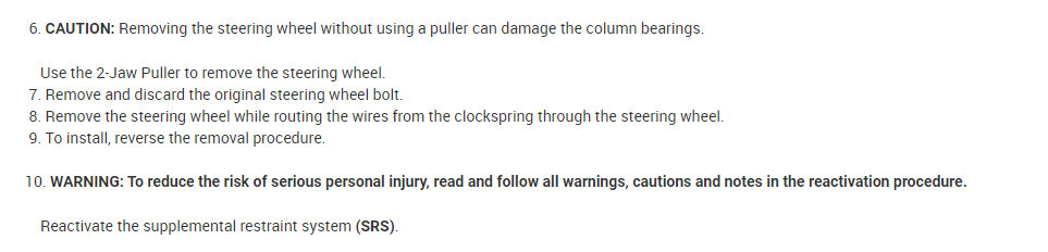

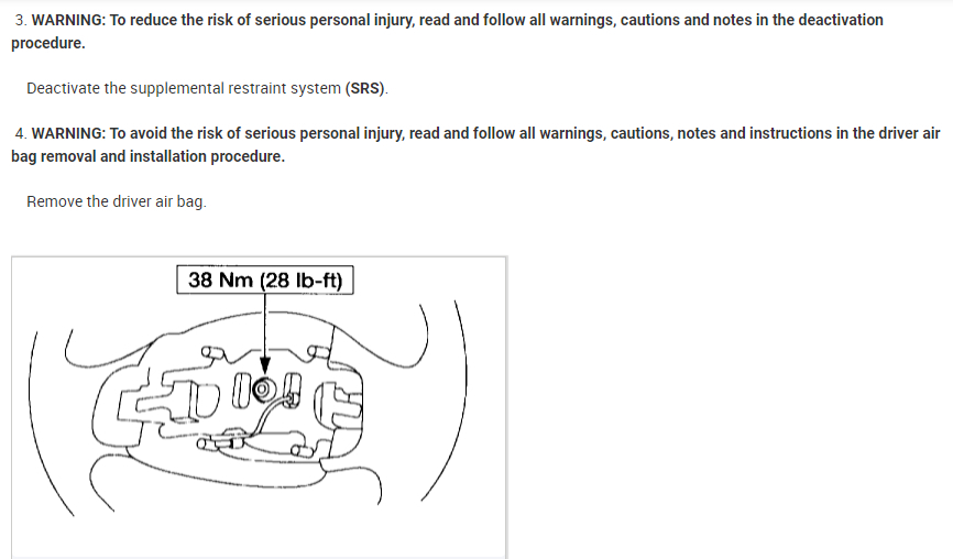

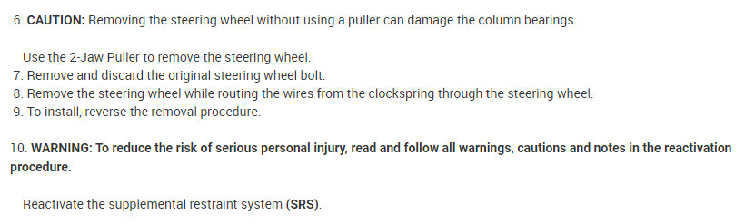

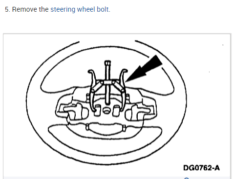

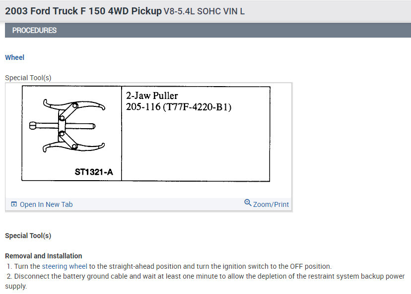

Good morning,
I attached the procedure with some pictures for the repair. You will need a puller to release the wheel after removing the attaching nut.
If you have steering wheel switches, when you release the cover, there will be a wire connector there to release.
