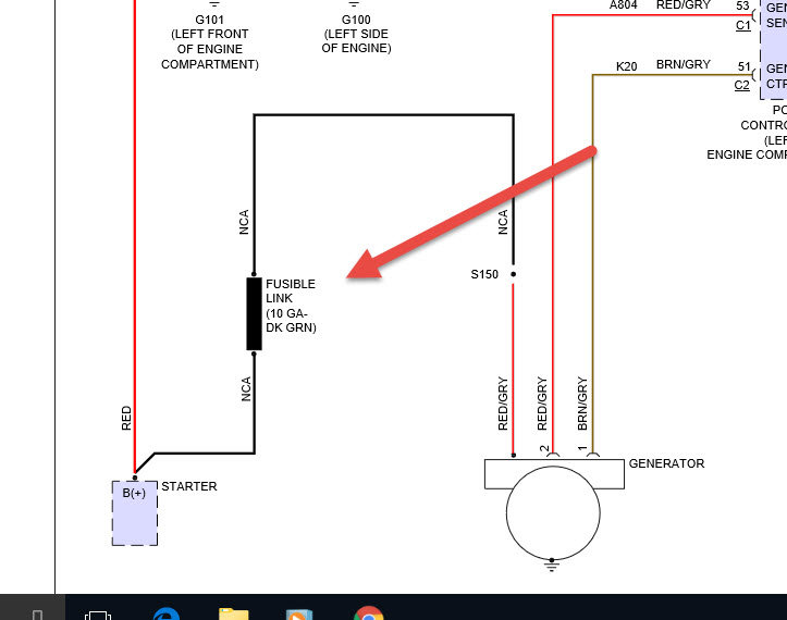

My horn only works when I lock the doors the battery light is on also, the battery is good and the alternator checked out. Would this be a TIPM problem?

check battery for condition including load test most places do for free then check item in pic
