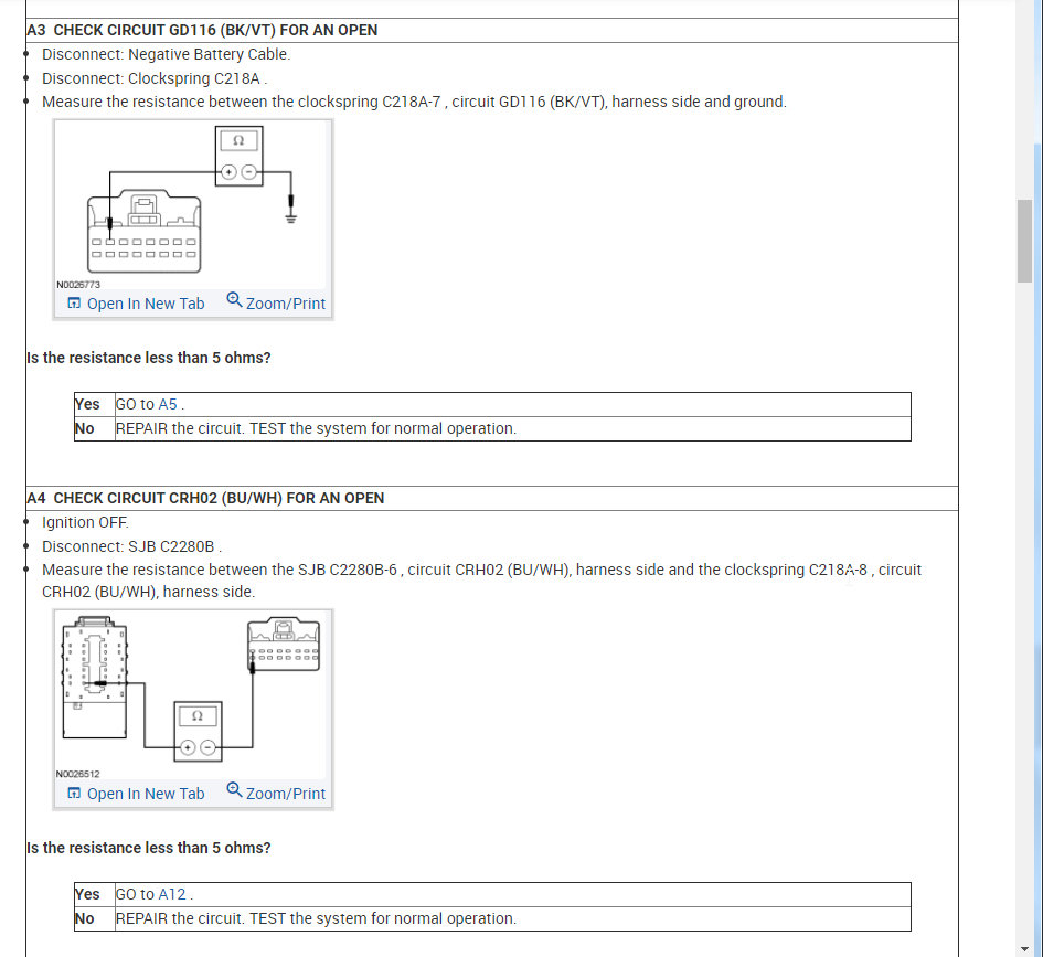

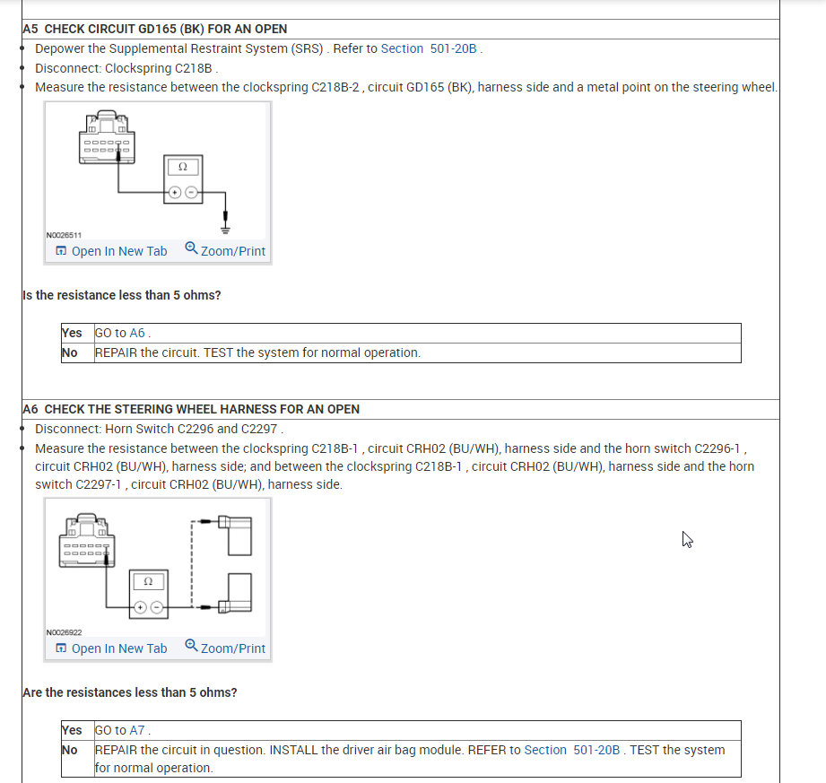

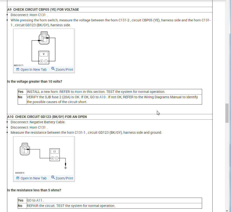

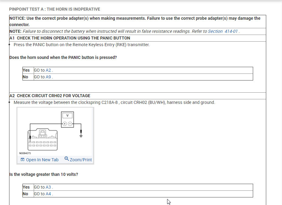

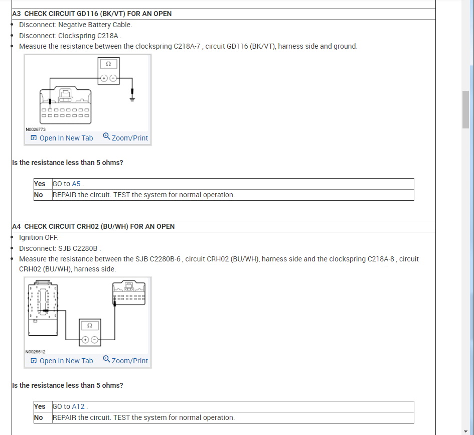

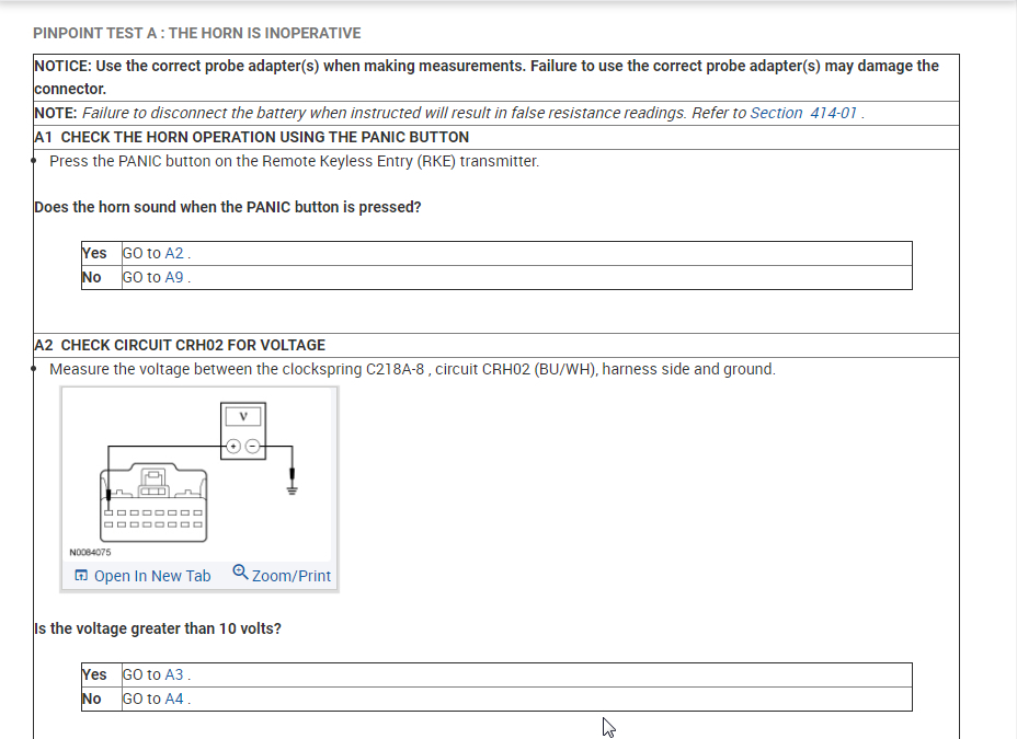

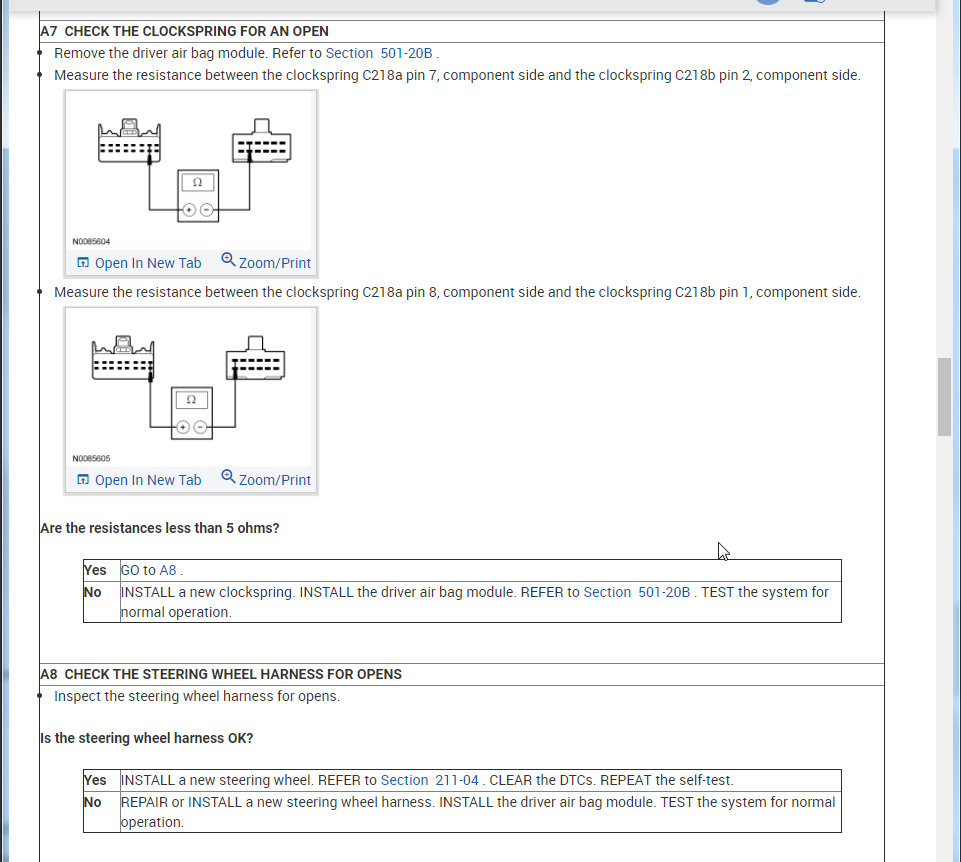

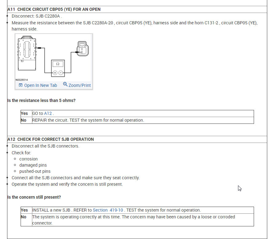

The horn does not work when you push it but it works when you lock the doors and the alarm.
Jan 13, 2021 at 5:15 AM

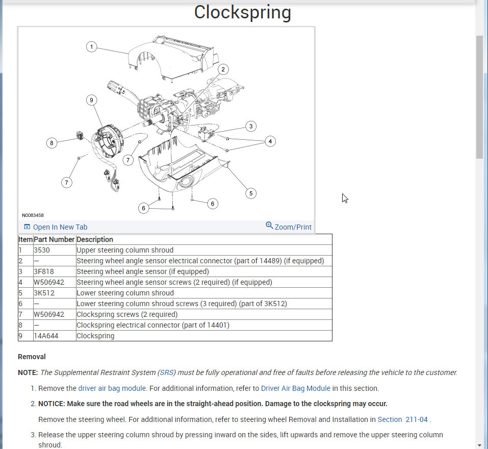

This could be a number of things so we are going to need to run through this testing just to find out what the possible cause is. It could be a wiring issue, the clockspring, or the Smart Junction Box has failed.
Here is a guide that will help with this:

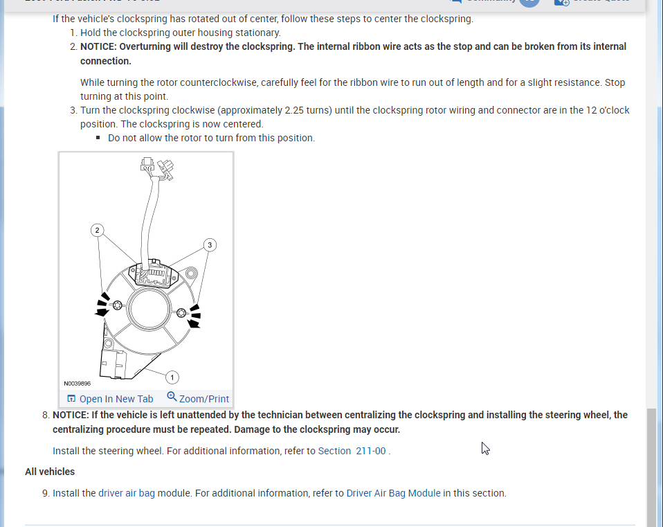

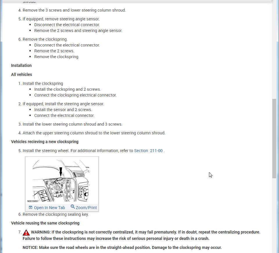

In most cases this is a clock spring issue so I attached the process on how to replace that as well.
Also, here is a guide that will help with this:
https://www.2carpros.com/articles/steering-wheel-clock-spring-removal
Let's run through this testing and we can go from there. Thanks
