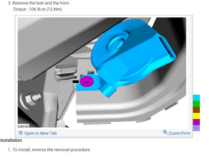

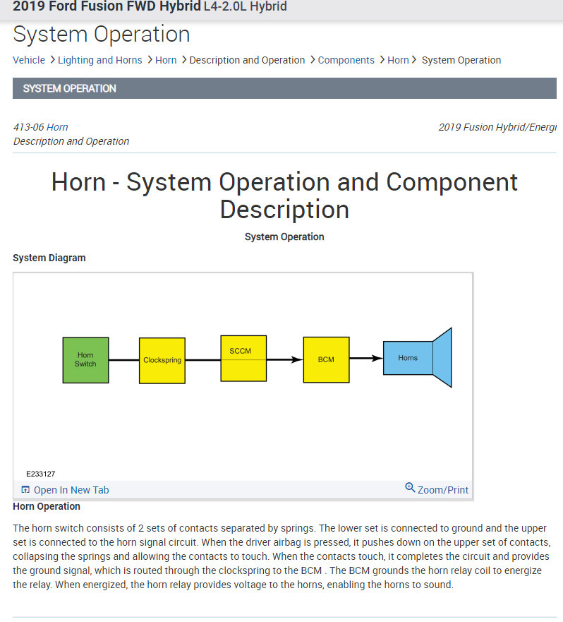

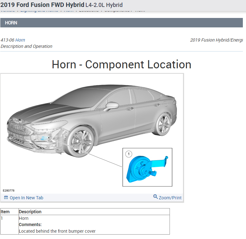

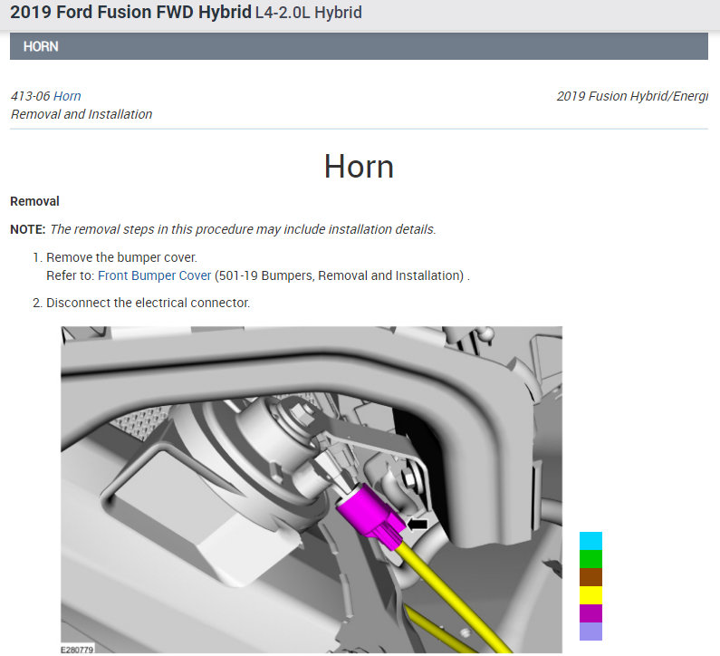

not working, fuse good, relay clicks when horn button pressed. I need to know where the horn is to check connections or replace it.
Oct 9, 2021 at 5:33 AM
SQM
  • 6,383 POSTS
The horn is located behind the front bumper cover on the driver side (see diagrams below).
