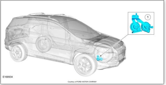

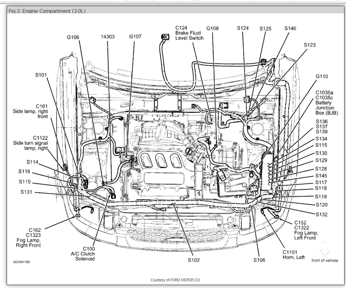

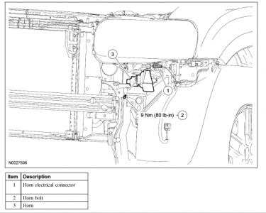

Where is my horn located?
Apr 24, 2018 at 11:54 AM
HARRY P
  • 2,292 POSTS
According to Prodemand, it is behind the passenger fender splash shield. The image attached is supplied by Ford, but it is about as clear as mud. Hope this helps. Check out the diagrams (Below). Please let us know if you need anything else to get the problem fixed.

As everyone else has said in recent years, the horn on the Escape Hybrid sound puny even compared with a VW. I'd like ro replace the horn with something a little "stronger", but I have yet to locate the darn thing. Where do I start looking?
Feb 10, 2021 at 10:07 AM (Merged)
  • 75,992 POSTS
HORN
https://images.2carpros.com/forum/automotive_pictures/12900_horn_4.jpg
Removal and Installation 1. Remove the front bumper cover. 2. Disconnect the electrical connector. 3. Remove the bolt and the horn. o To install, tighten to 9 Nm (80 lb-in) . 4. To install, reverse the removal procedure.

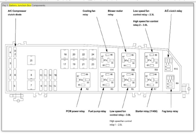

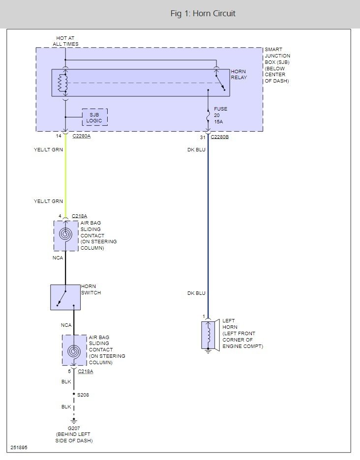

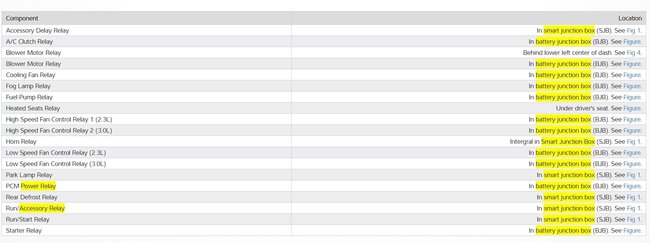

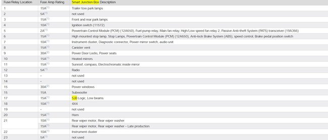

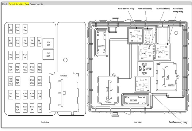

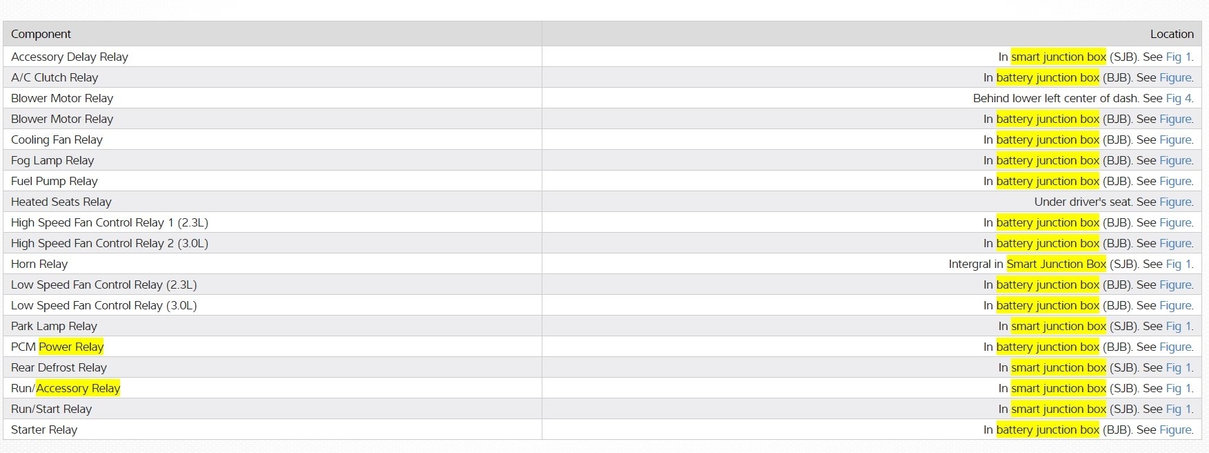

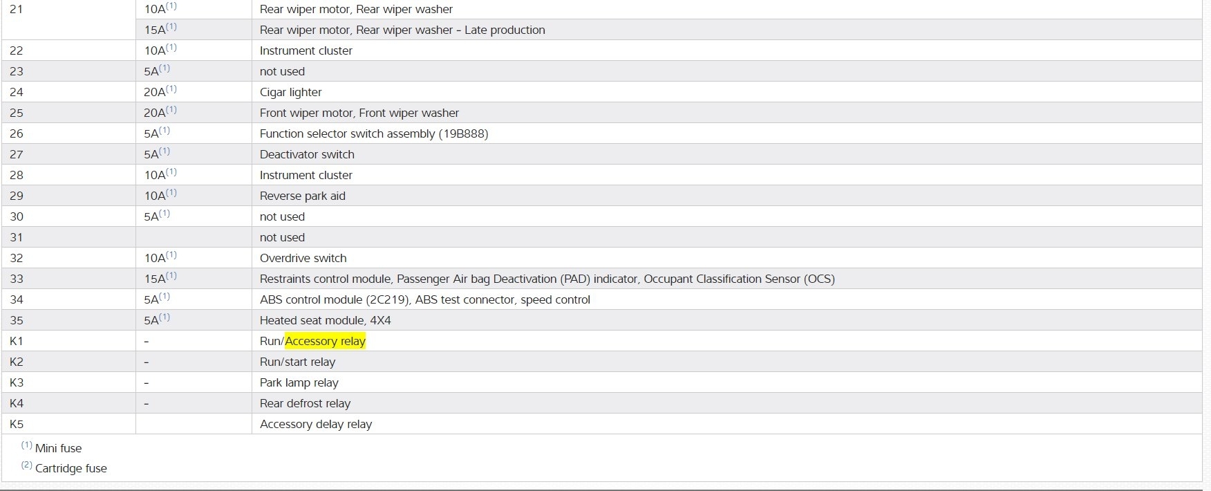

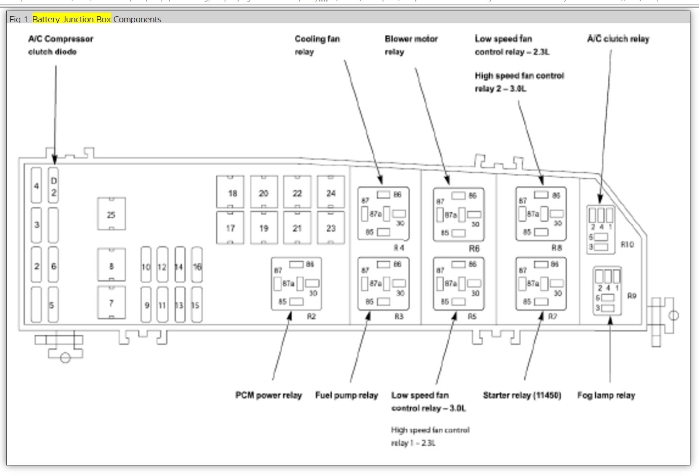

I am looking for the 15 amp fuse for horn in interior fuse panel but the manual diagram does not line up what is actually in place in the panel.
  • 55,399 POSTS
Here are the fuse box and relay locations for the horn (below) here are some guides that will help you do some testing and get the problem fixed.
and
and
JMM
Thank you I located it
