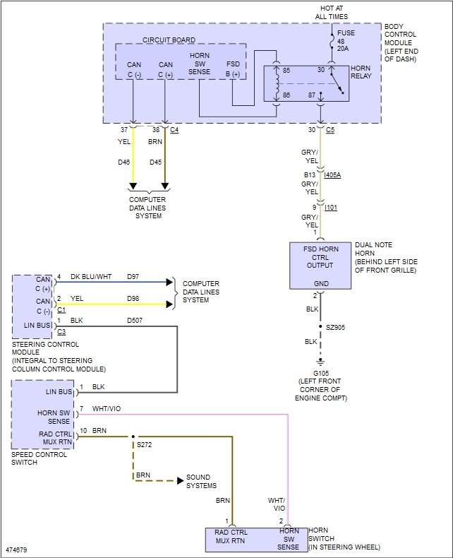

My horn has quit working. I have checked the fuses but cannot seem to be able to locate the relay to check that.

The relay is in the body control module. Test the horn module and the wiring to it, they like to fail.
Image (Click to enlarge)
