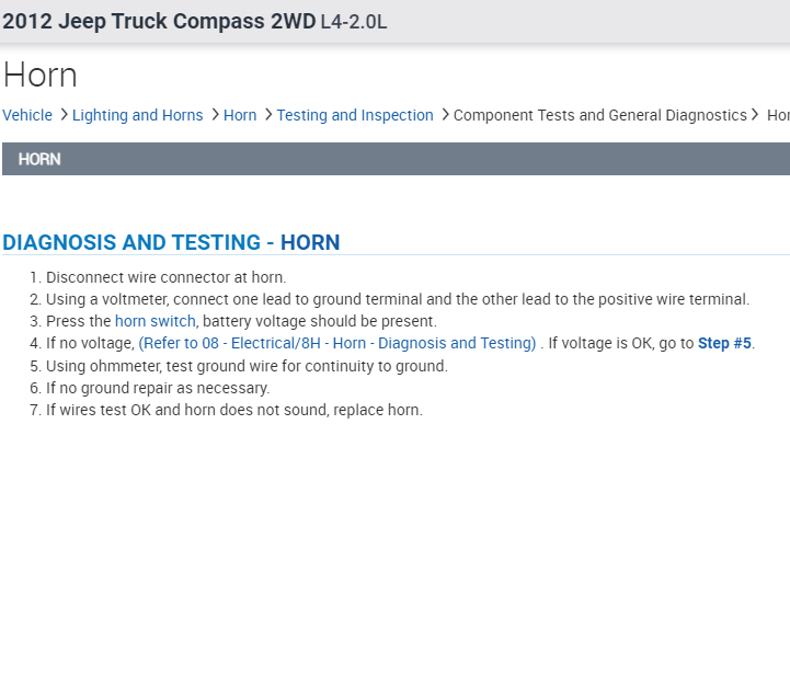

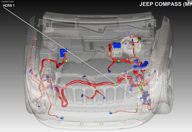

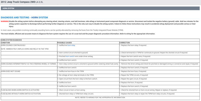

Trying to locate fust for Horn. It is not in the book or on the fuse panel.

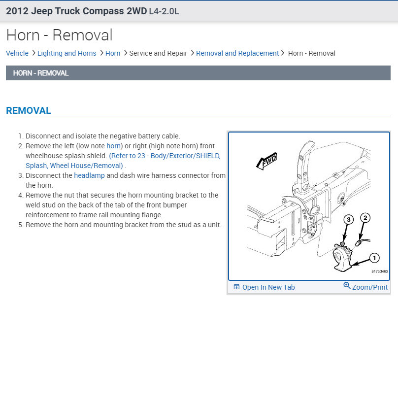

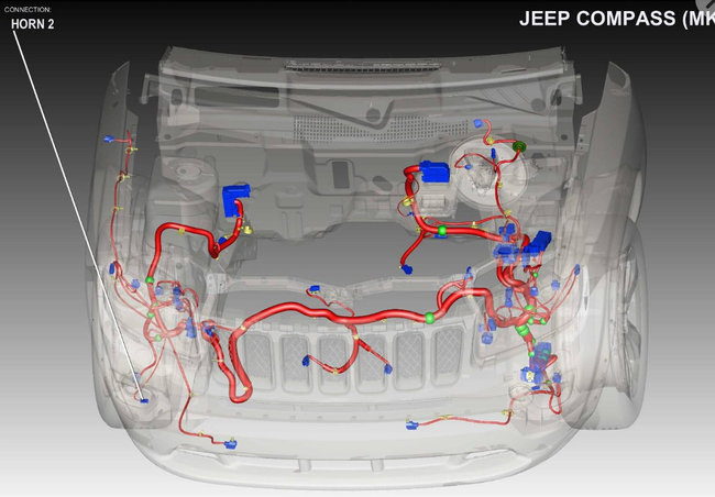

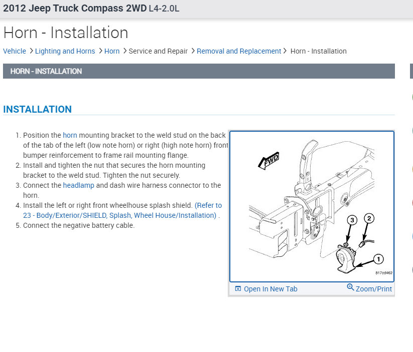

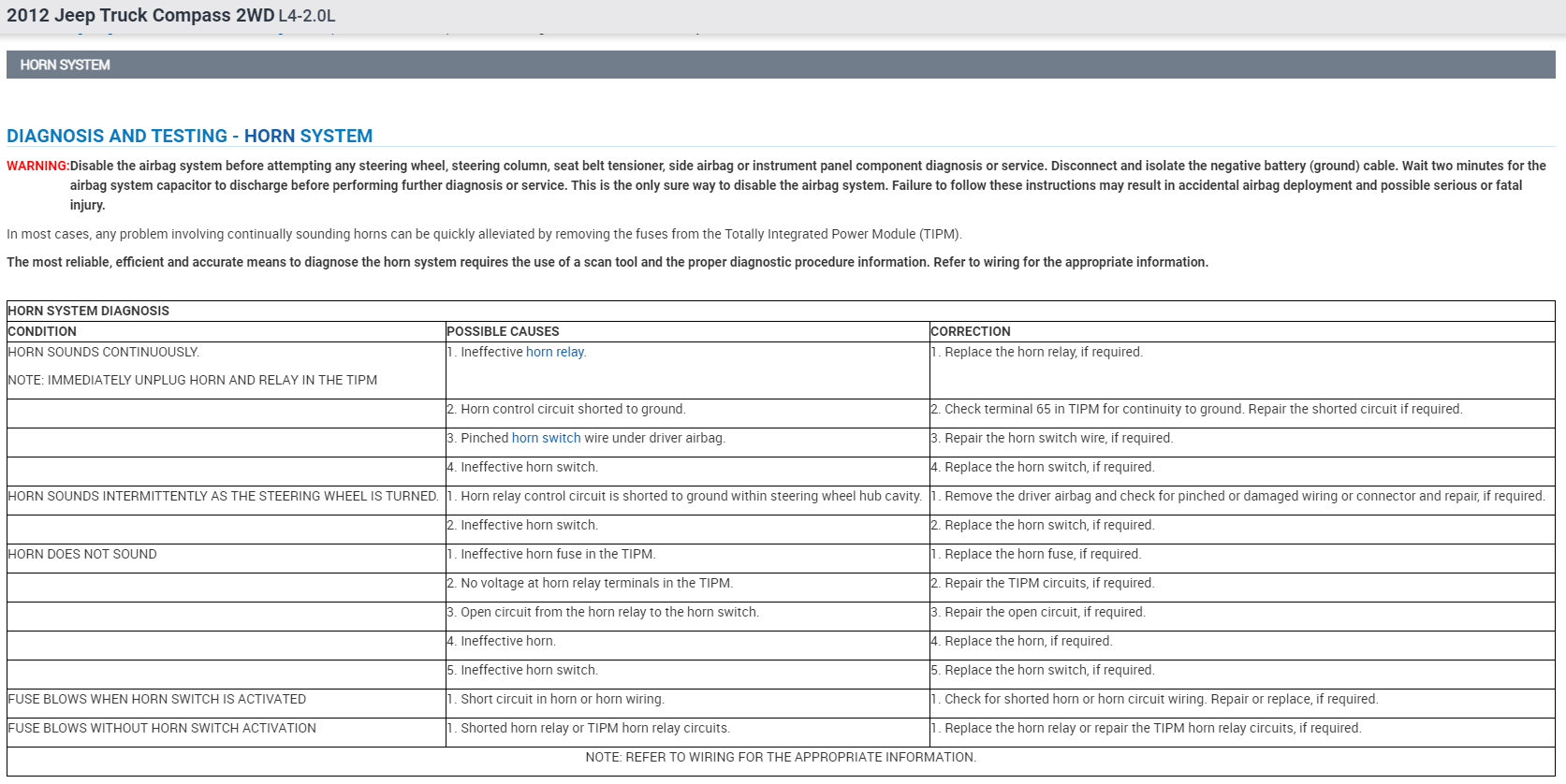

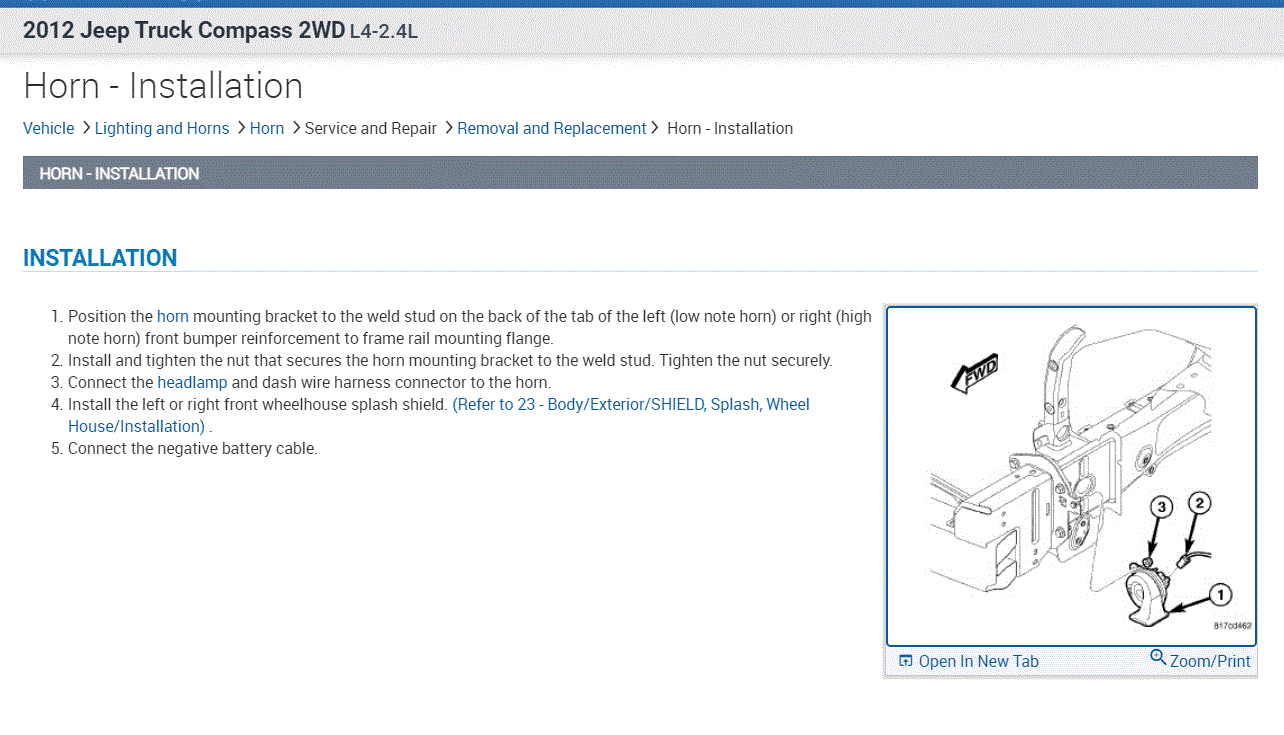

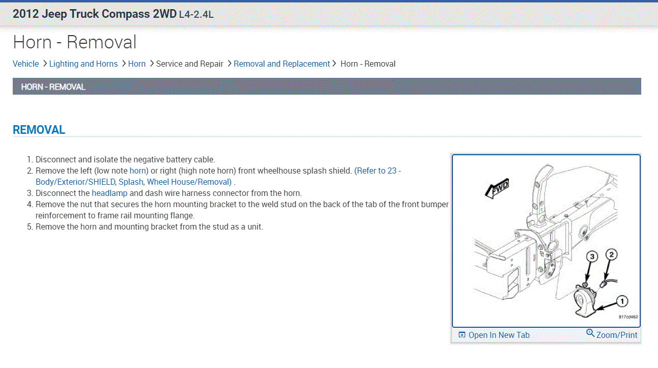

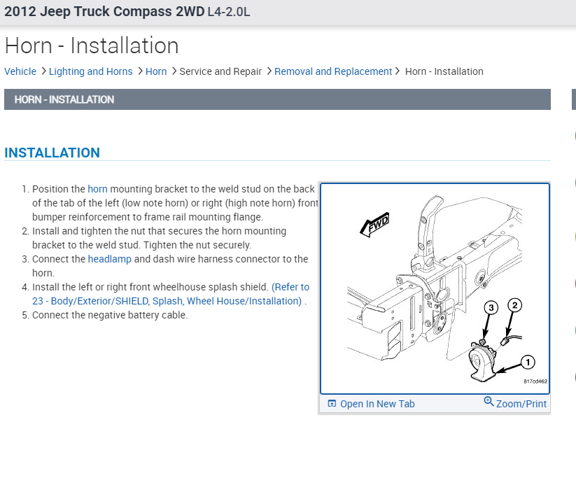

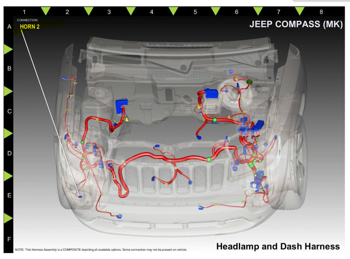

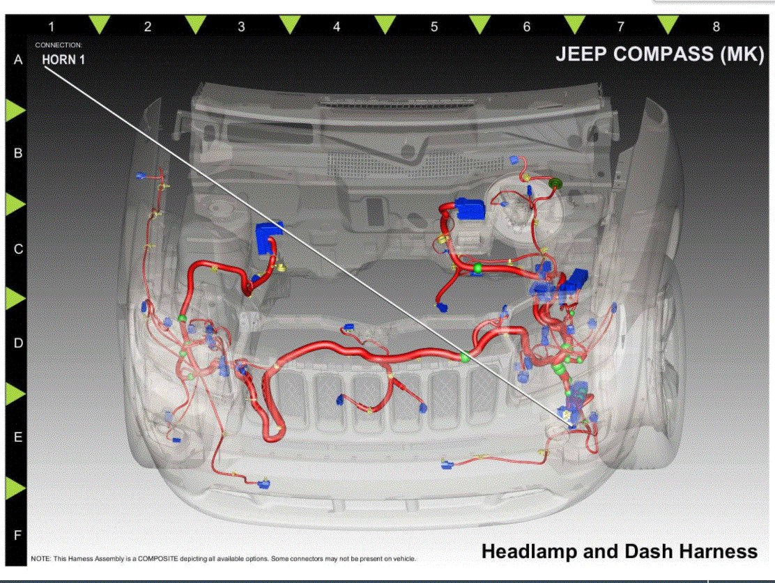

I attached four pics below. The first two show the locations for both horns. The last two pics provide the directions for the removal and replacement of the horns.

This vehicle has two horns, one by each fog light.
I have attached diagrams showing the location and replacement procedure below.
