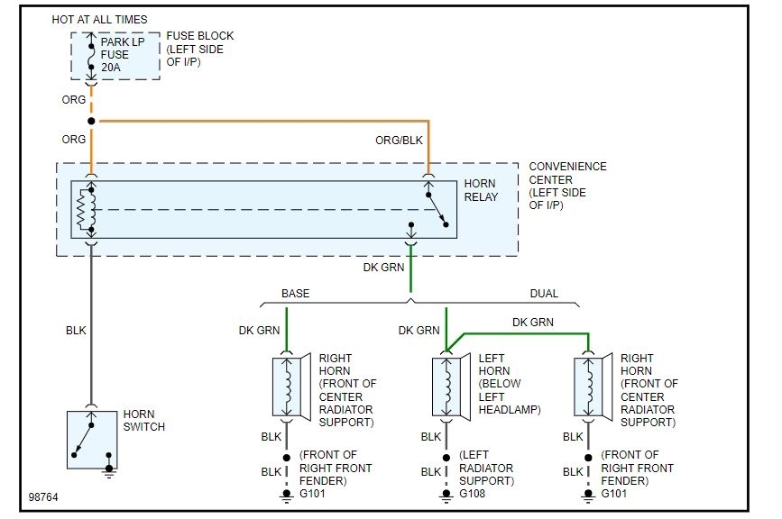

Good afternoon.
I attached a wiring diagram for you to view. The fuse is shown with the location.
Mar 9, 2020 at 8:45 AM
CSTOKES
I'm not sure how to read the diagram. I'm surevit would have been helpful but being a woman, not mechanically inclined. I'm clueless on how to read the diagram. Sorry. Thank for your help Roy, I greatly appreciate it.

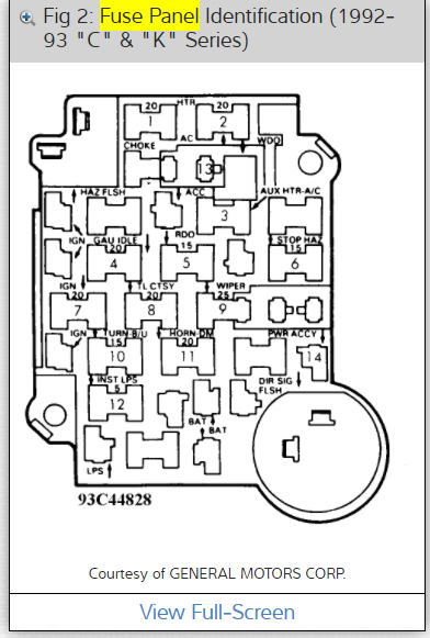

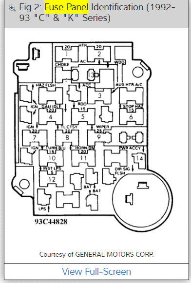

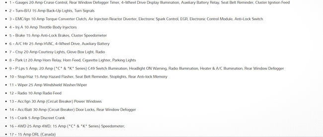

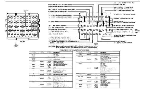

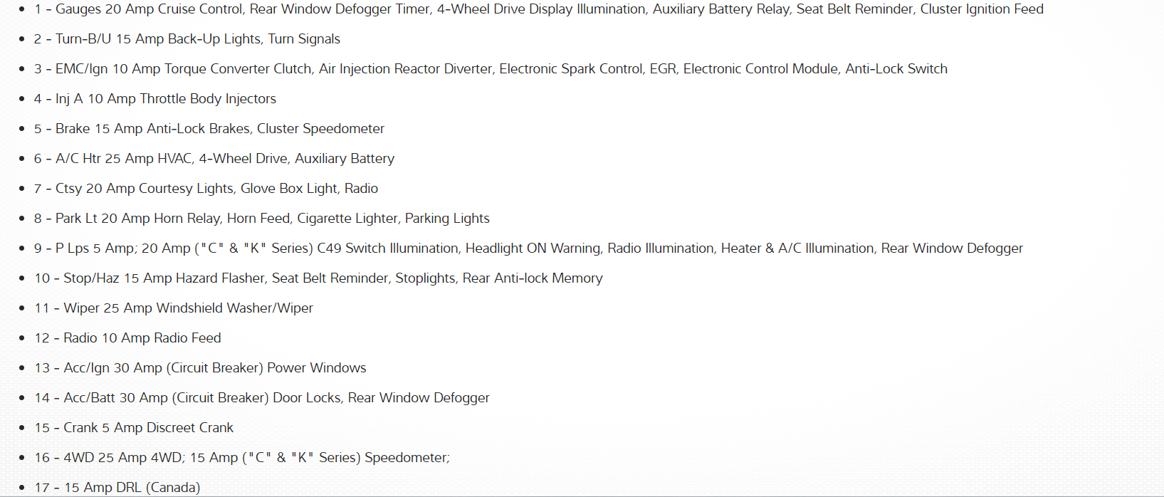

My fuse box doesn't look like that. My truck is a 1990 chevy silverado 2500.
Mar 27, 2020 at 5:12 AM
  • 55,721 POSTS
I found this updated fuse panel diagrams for you does look like it? Check out the diagrams (below). Please let us know what you find.
