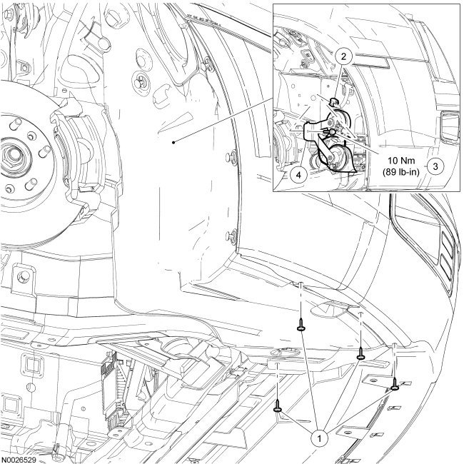

My horn barely makes a sound when locking the door and when pushing the horn on the steering wheel. So do I needs to replace the horn its self and where is it located?
Aug 28, 2020 at 7:59 AM
  • 110,194 POSTS

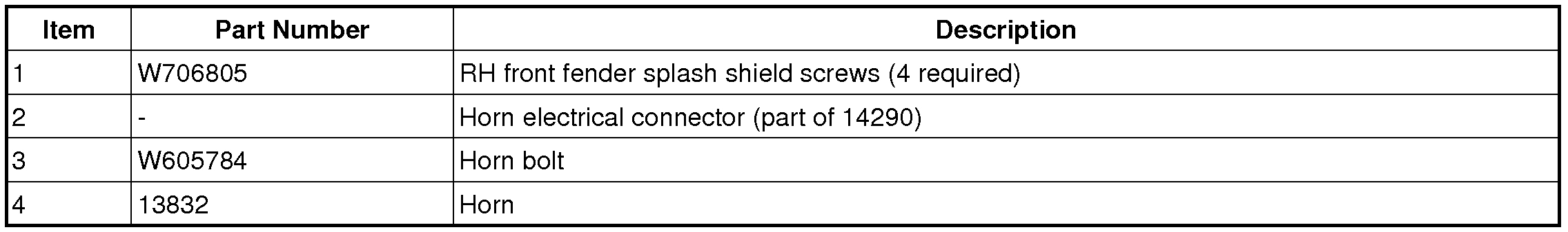

The horn is behind the inner fender (front) on the passenger side. Here are the directions for replacement. Note: You will need to remove the right front tire to perform the service.
Here are the directions. The attached pics correlate with the directions.
__________________________________
2012 Ford Fusion FWD L4-2.5L
Horn
Vehicle Lighting and Horns Horn Service and Repair Removal and Replacement Horn
HORN
Horn
pic 1
pic 2
Removal and Installation
1. With the vehicle in NEUTRAL, position it on a hoist. For additional information, refer to Vehicle Jacking and Lifting. See: Vehicle Lifting > Procedures > Jacking and Lifting
2. Remove the 4 RH front fender splash shield screws.
- Pull the RH front fender splash shield downward to access the horn.
3. Disconnect the electrical connector.
4. Remove the bolt and the horn.
- To install, tighten to 10 Nm (89 lb-in).
5. To install, reverse the removal procedure.
