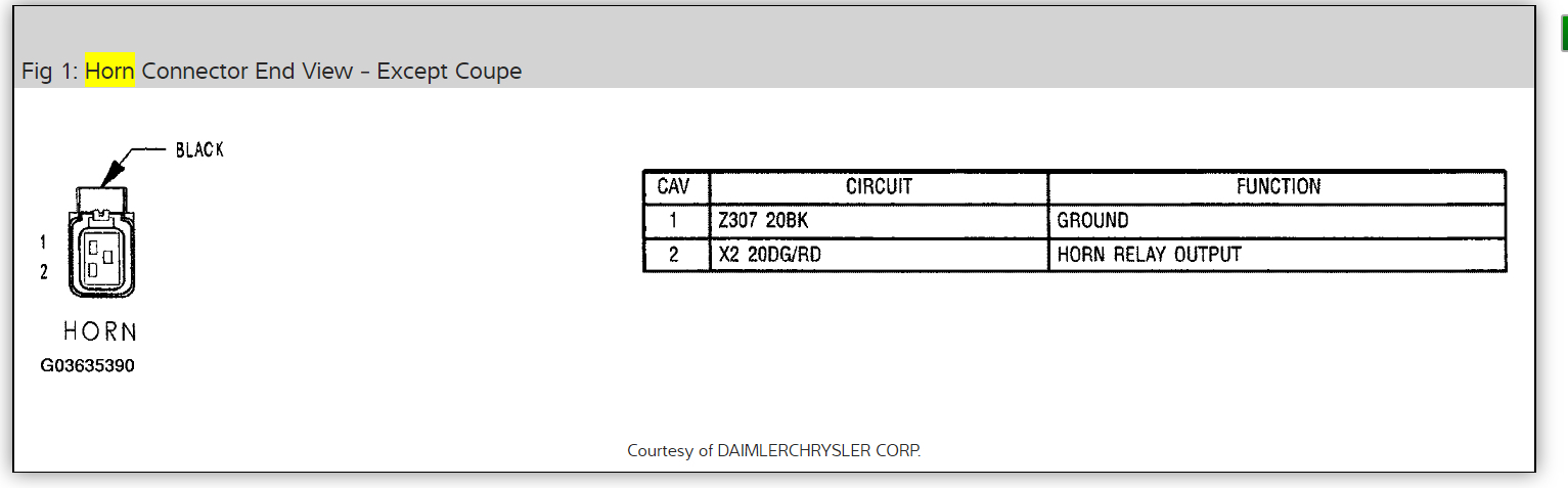

Replaced horn three times still not working
2004 CHRYSLER SEBRING
200,000 MILES • 2.4L • 4 CYL • 2WD • AUTOMATIC
BECKY STEVENS

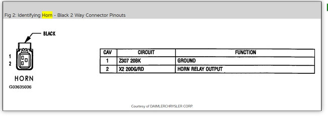

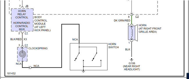

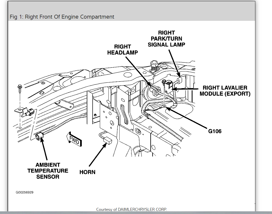

I have replaced the horn three times, back to back. It works one to three times and then it no longer works. Now fairly certain that the horn(s) not the problem. What should I check next?
Mar 21, 2019 at 6:13 AM
SCGRANTURISMO
  • 4,897 POSTS

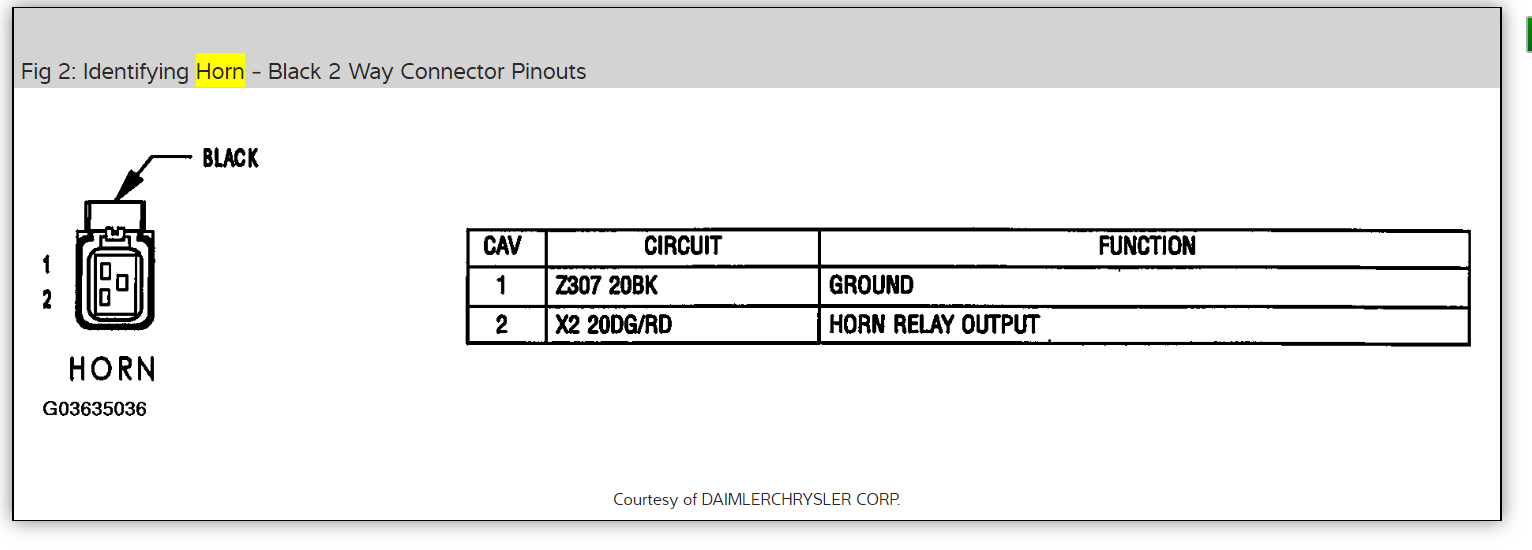

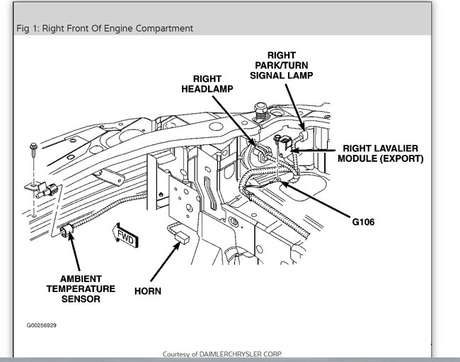

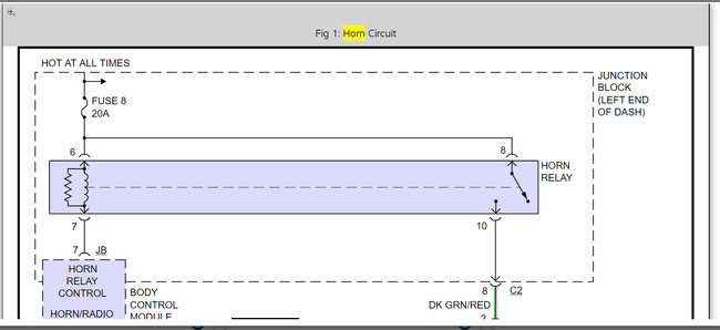

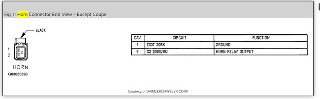

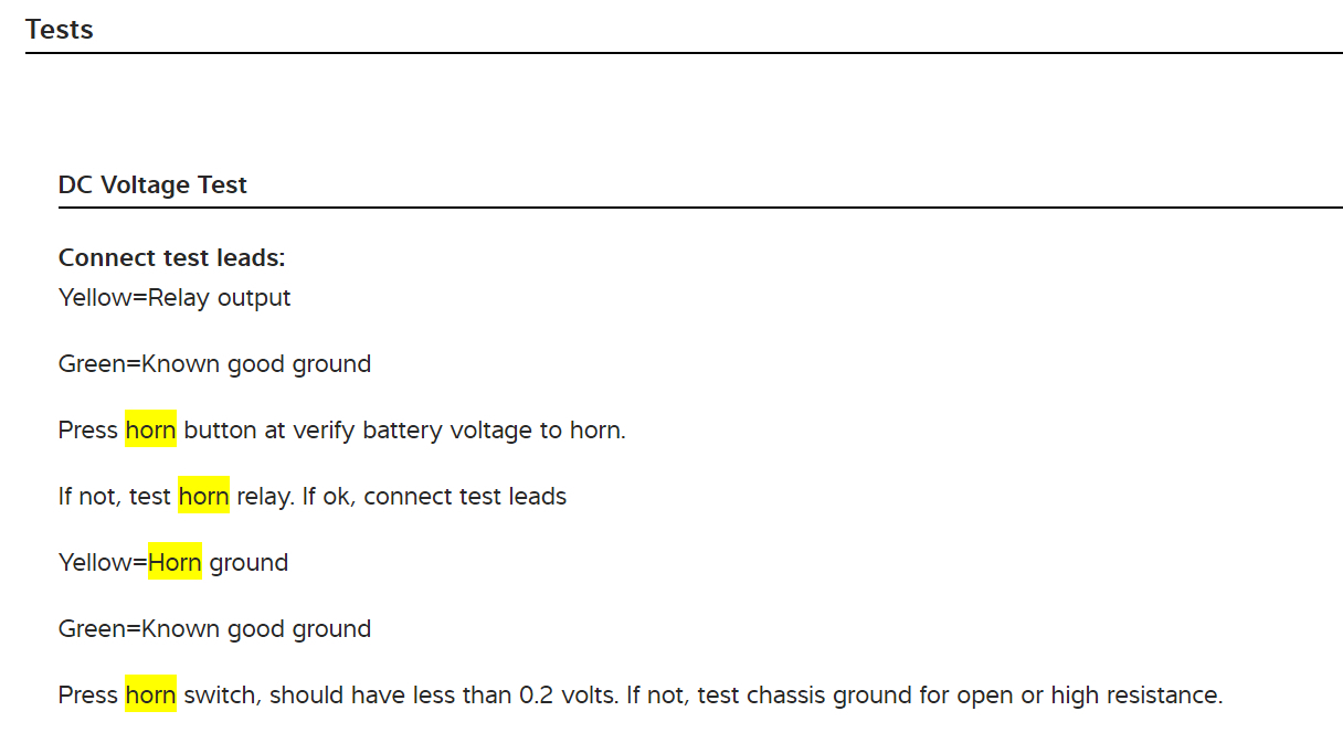

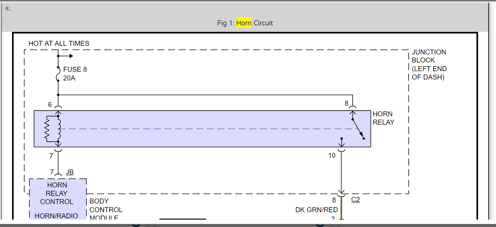

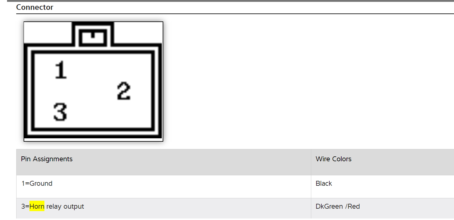

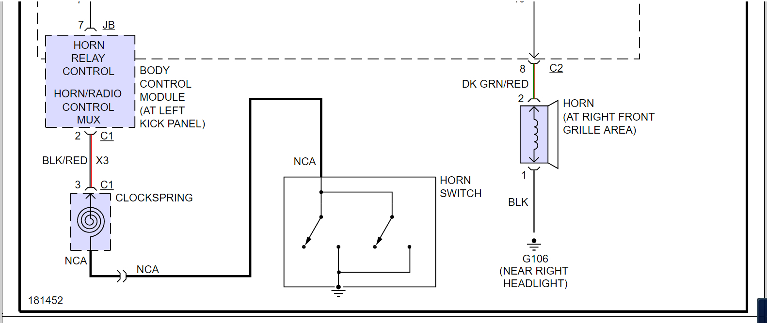

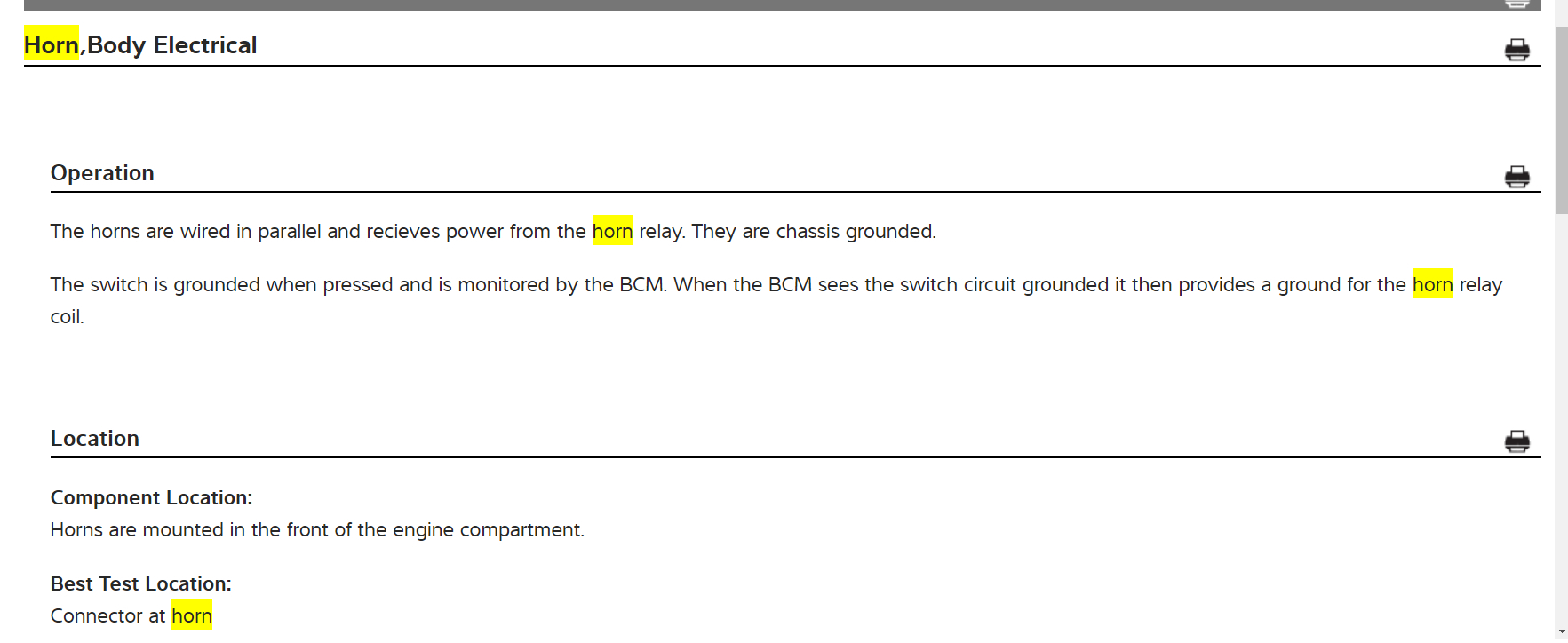

I would make sure that the ground for the horn switch is in good condition, has no corrosion on it, and the horn switch is making good contact with the ground. I have included a troubleshooting guide, connector end view, location, and wiring diagram for the horn in the diagrams down below. Please go through the information and check the horn switch ground and get back to me with what you find out.
