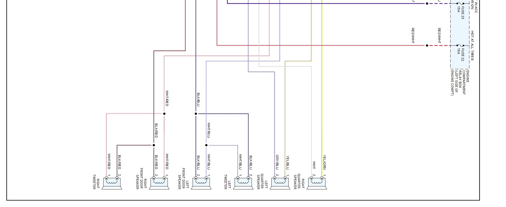

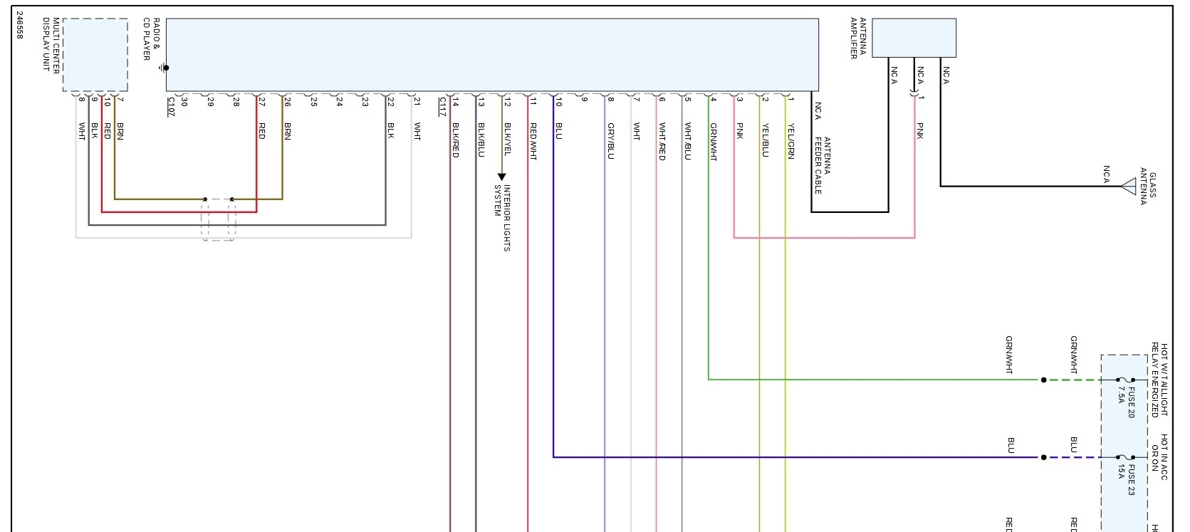

All the wires have been cut so I can’t plug it in. So, I need help identifying the speaker wires.

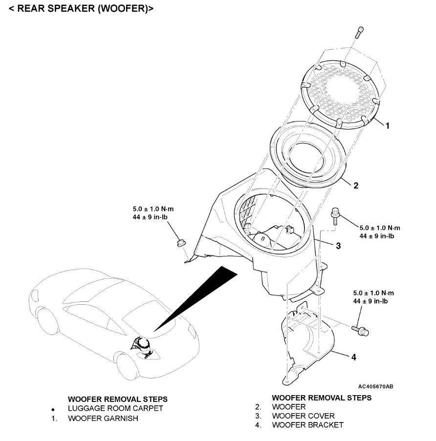

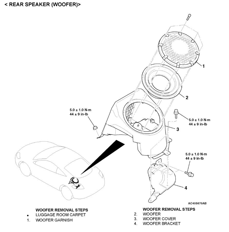

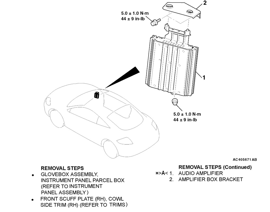

Do you know if it has the optional amplifier? The colors are different if it does. If it has the amp, it will have a subwoofer in the rear and the amp will be behind the kick panel on the right side. Let us know and if it has the amp as that has different issues. The diagrams are for the base unit without an amp, those just have the 4 corner speakers.
