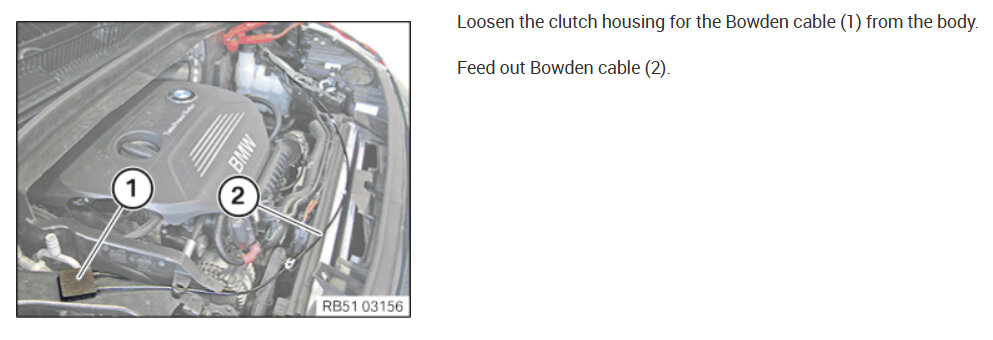

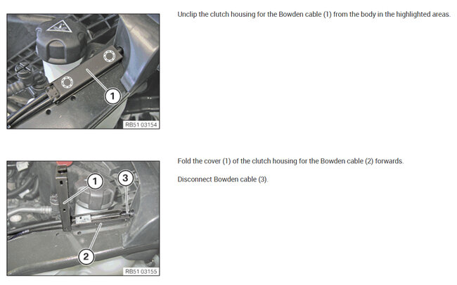

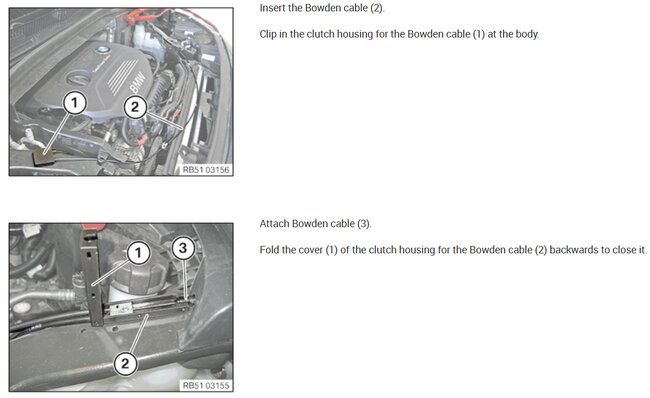

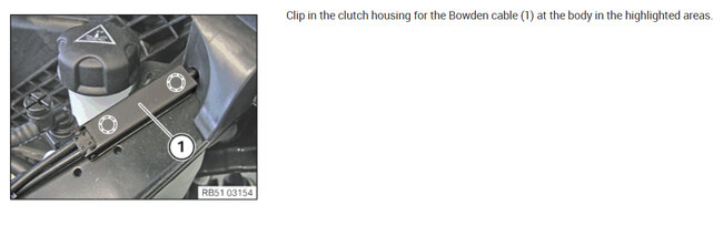

Hi I'm after the hood release cable workshop diagrams to install and replace broken cable

Sure, here is how to change out the hood release cables. Check out the images (below). Let us know if you need anything else.
