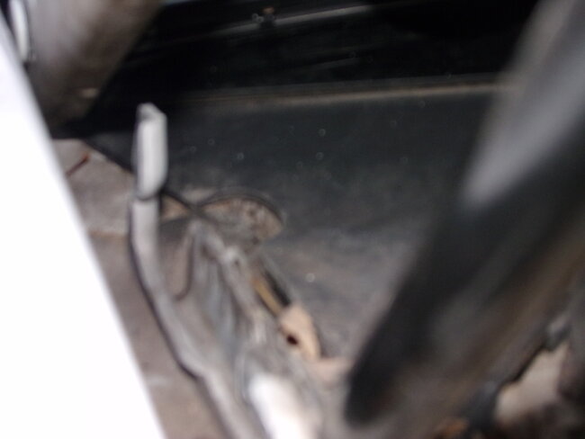

Can anyone tell me if a hood hinge on a Chevrolet Lumina late 90's might fit the car listed above?

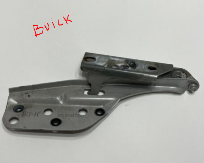

I tried to find the OEM part numbers, but because of the model year, they are no longer listed in my manuals. So, I tried to find pics online for the two.
From what I am seeing, they are two very different hinges. By chance, could you take a pic of the ones on your vehicle? Based on what I see, the Buick hinge has an integral spring to hold the weight of the hood. On the Lumina, that isn't present.

I can't get a picture at this time. However, I can tell you there is no spring, the hood is held up with hood struts, or a good broom handle, if needs be. :-)

I've used the broom handles in the past as well. LOL As far as the hinge, it may work, but I really need to see what you are dealing with. Chances are, you will need to modify it to work, but again, that is based on model years. I know GM used the same hinge from 1995 to 2001, so that shouldn't change if you are within those years.
If you have a chance, get a pic of it and upload it for me to see.

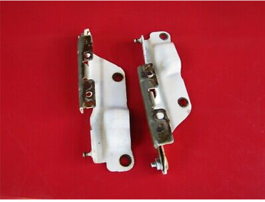

I attached two pics below. The first is from Lumina and the second is from the Lesabre. They appear to be somewhat similar.

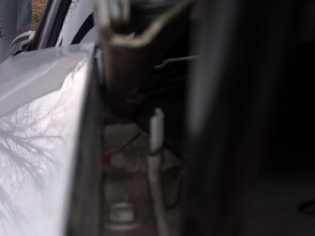

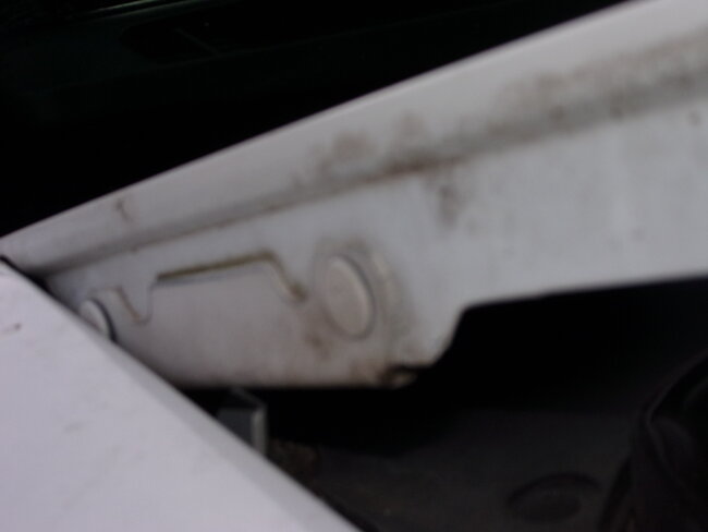

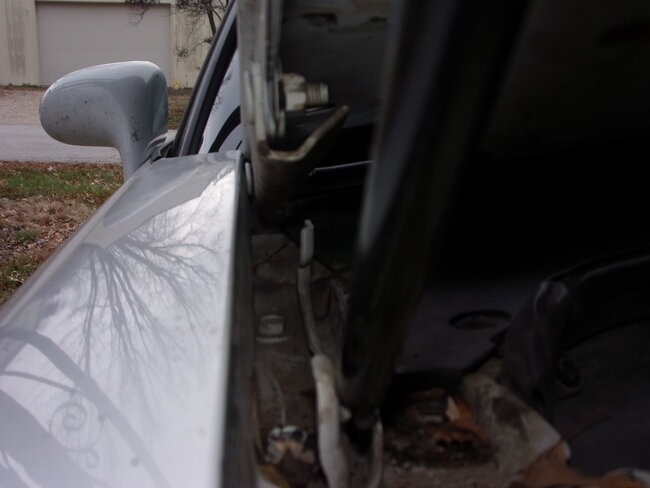

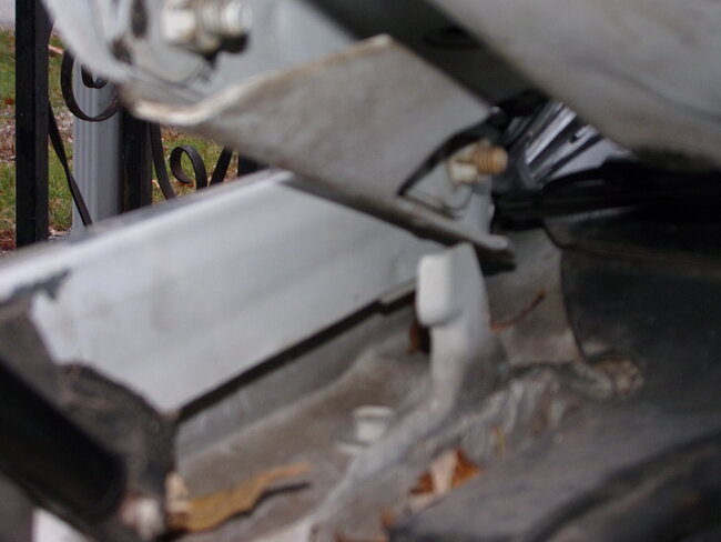

I've gotten in there best as I am able. Here are pictures.
I'd looked at OEM also and the pictures they would show do not look like my hinge at all...
Dec 4, 2023 at 6:30 AM
AHARTLEY
  • 120 POSTS
It looks as, if I could get the right side off then I could get to the left side and slide that hood off of there.
Dec 4, 2023 at 6:31 AM
  • 110,240 POSTS
It is so hard for me to tell for sure. If you want to remove them, have a helper help with the removal of the hood first. Then you will have better access to remove the hinge.
