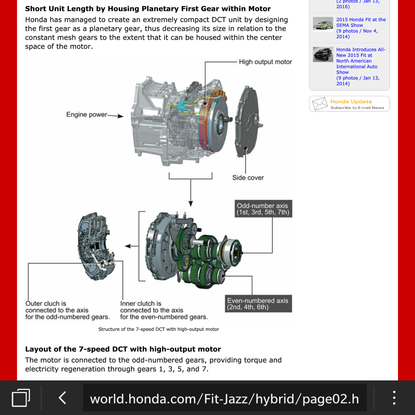

honda vezle 2014 d light blinking dtc p074a i changed the actuctor on the transmission but normal drive is smooth gear change but the gear kicks down the dtc comes on p074a
Mar 23, 2016 at 7:21 AM
HAMEEDKHAN
Here is an image
Mar 23, 2016 at 7:26 AM

Hello Hameedkhan,
It sounds like the internal working of the transmission are having a problem and it wont go into second gear, did you check the fuses?
have you any news to report?
