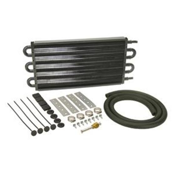

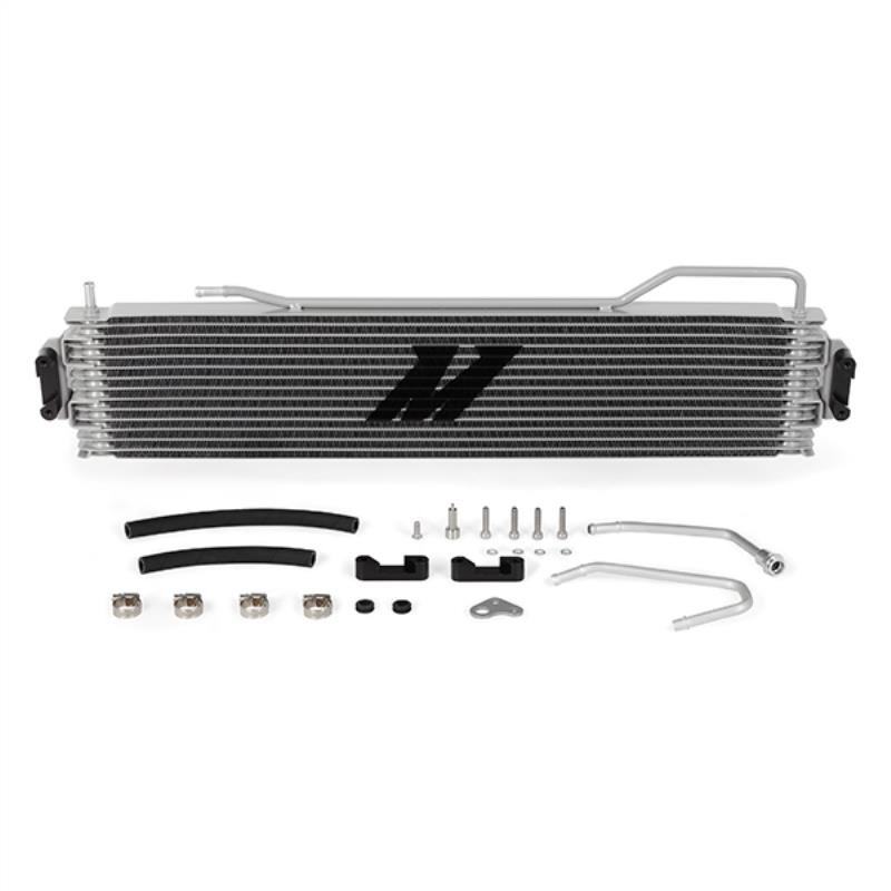

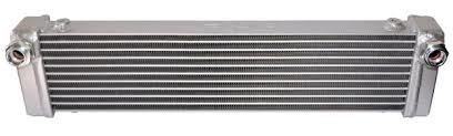

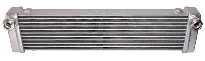

Oct 6, 2019 at 12:02 PM
STEVE W.
  • 15,352 POSTS
These are the styles of coolers I'm used to seeing and using. They are all designed to go into the cooling lines that automatic transmissions use, I have seen then on cars with dual clutch designs but those had factory coolers because they were high performance vehicles. Honda doesn't show if they have a cooler or an internal pump that could have one added. That is why I would investigate it with them first, if it already has a cooler then adding on should be simple. If not then it becomes a lot more work.
